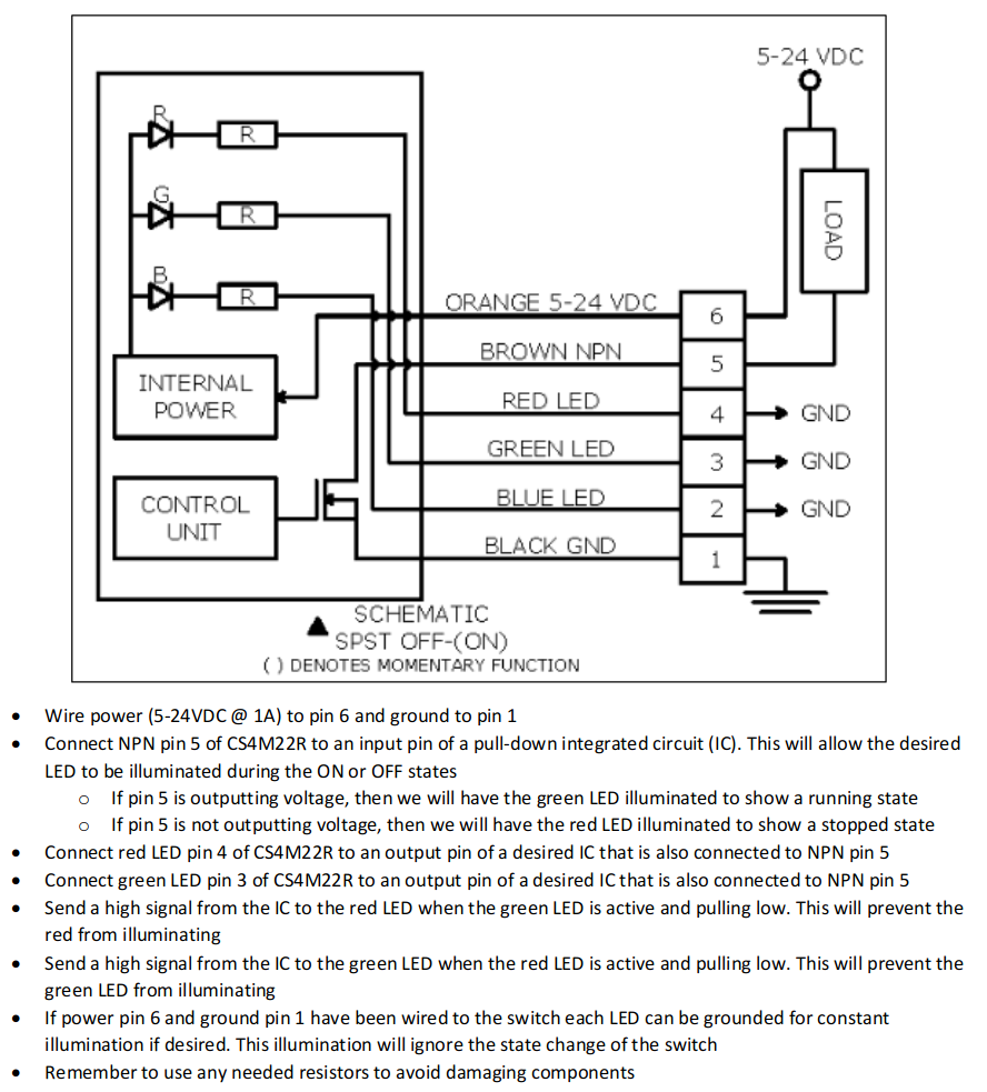

Looking at a schematic for a capacitive switch that I want to control the LED's for myself. Reading the info, it appears possible, however, it would be nice to hear from others about their experiences with these things. This switch in particular has the design and appearance that I desire, so i'd like to make it work if possible. Looking to control the LED's individually myself, regardless of button state. In the schematic, I'd be looking to use pin5 for just the load, rather than all the other jargon options apparently available.
Anyone with experience with these?
