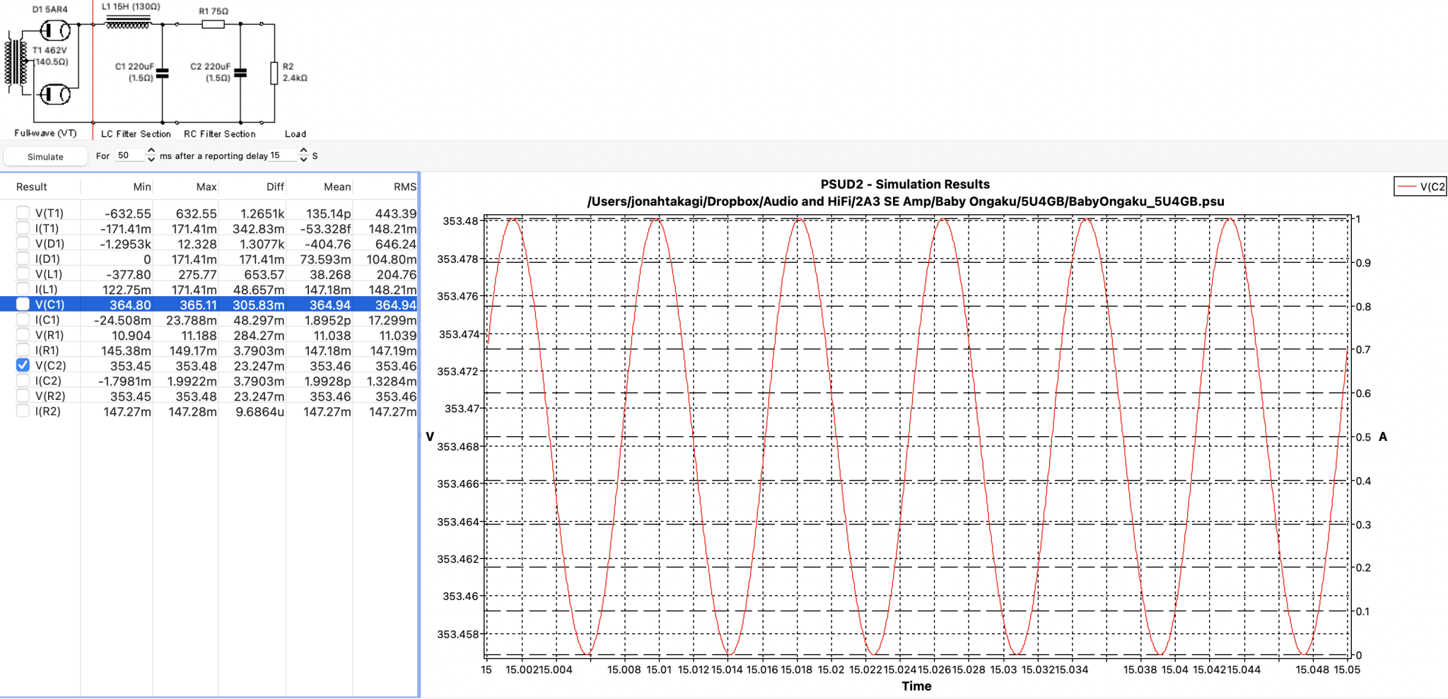

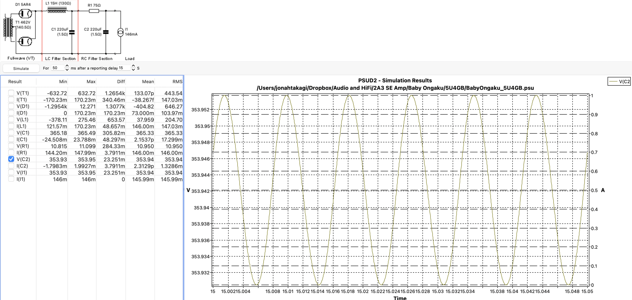

I'm new to this world so please bear with me.
I'm designing a choke input power supply and looking for some general guidelines on capacitance. From what I've learned with capacitor input power supplies there is guidance on the tube data sheets as to the max size of the first filter cap prior to the choke; however, I haven't been able to locate any specs for capacitors in a choke input supply.
Is there a max value for the first cap AFTER the choke?
And generally, does the community have any thoughts on capacitance in a choke input power supply? I've modeled one in PSUD and it seems to check all the boxes for a stereo 2A3 single-ended amp driven by 12AT7s. The ripple is less than 20mV at the second capacitor and the B+ is where I need it, I'm just unsure of the CRC filter after the choke.
Thanks!

One thing to be aware of is the resonant frequency of an LC filter - this will of course be below the mains ripple frequency, ie below 100 or 120Hz, but is it below the lowest load frequency? If not you may get unwanted resonance effects on bass notes. Clearly you can damp the LC using a following RC, or lower the resonant frequency more, in an effort to remove the problem. There's probably some good rule of thumb for this that someone will know.
There's clearly some compromize between sensible component values, low ripple, low resonance (critically damped?), low loss (in the R or L), max load current etc.
If simulating I'd suggest trying a simulated load current sweeping between 10Hz and twice the mains frequency to catch any resonances, and possibly some step changes in load current too.

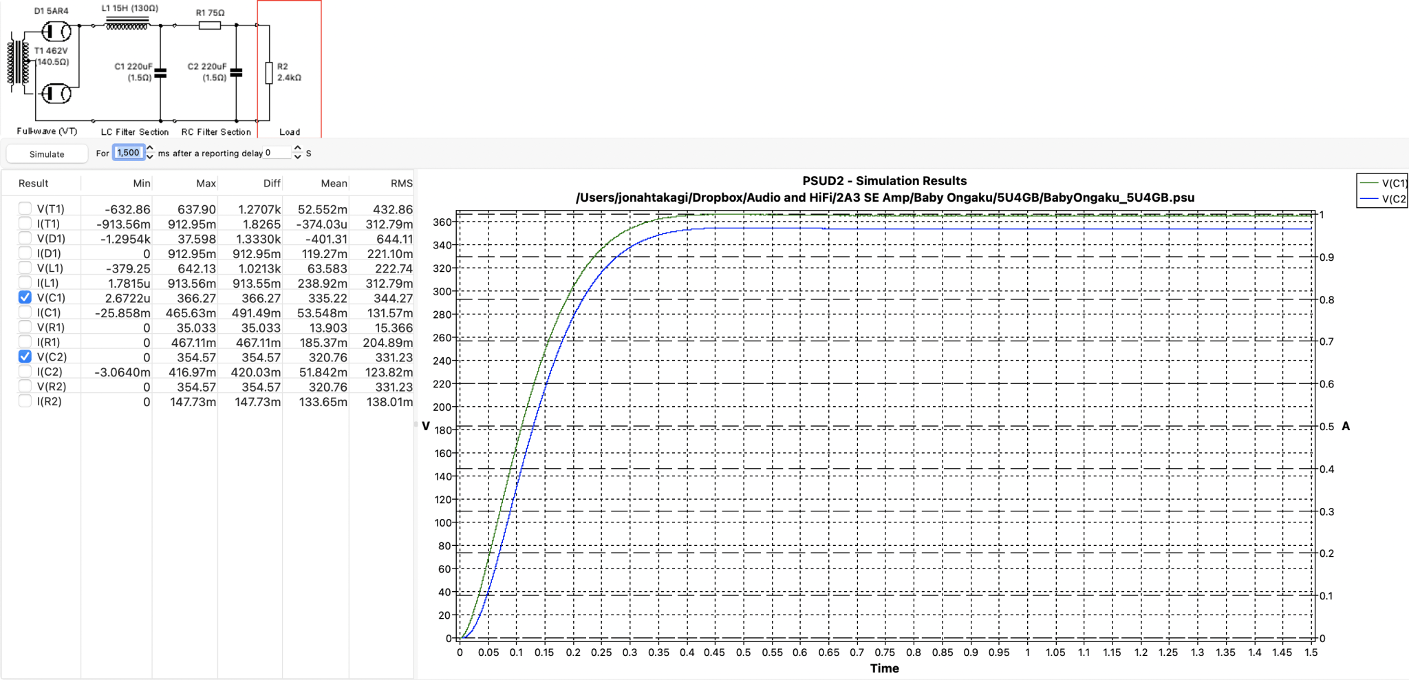

You can use PSUD2 to indicate if the valve rectifier is being stressed beyond its transient hot-start peak current limit (3.7A), and its continuous peak current limit (825mA), for the 5AR4. Firstly, did you measure the parameter values used in the PSUD2 screengrab - such as the 'effective' transformer secondary winding resistance, and the choke DCR, and the capacitor ESR's ? For a hot start simulation, change the PSUD2 option to NO soft start, and perhaps use a load resistance (rather than a constant current) that equates to your aimed B+ and idle load.
PSUD2 can also indicate what LC damped response occurs for a step in load current. I can suggest changing the load value from the target idle current, to something near max current (you may not know this, or you may be using a class A amp in which case this scenario is a red herring), and then do a reverse step, and look at the B+ voltage response at the time of the step to see if it is well damped for both rise and fall steps,
PSUD2 can be used to indicate the ripple current in the first filter capacitor, and then to compare that to the capacitor ripple current rating - always worth doing imho for the first filter cap (whether for capacitor or choke input).
If you are using a valve rectifier then I'd recommend adding 2x 1N4007 in series with each 5AR4 anode, to minimise PIV stress on the 5AR4 anodes and avoid collateral damage if the 5AR4 thinks about arcing some time in the future.

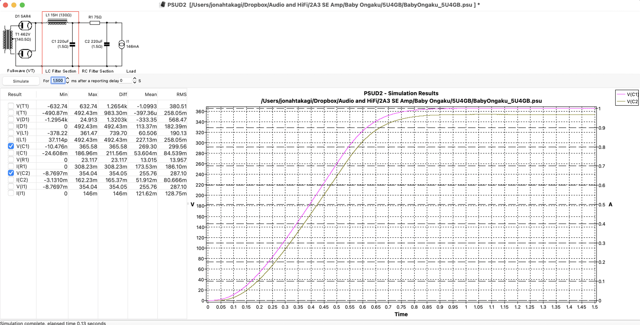

I've done choke input filters with high value capacitors, such as 1800-4700uF. Slow start or additional Rdc to limit unrush currents are mandatory. That criteria should be the primary limitation.
PSUD2 is a good way to see the effects of first capacitor in choke input supply, including oscillation in choke-capacitor resonant tank. At some capacitance value, the oscillation becomes critically damped. Jim Hagerman used to offer a calculator for critical capacitor size, but now his web site is gone. As far as I remember, the critical capacitor size for a typical tube power supply is pretty big, hundreds of microfarads.
Also, one should be aware of a huge start-up voltage spike in a choke input supply, to which tube rectifiers, but not SS diodes, are largely immune, Need some kind of snubber with SS rectifiers - a small capacitor or a varistor.
I used the manufacturer's specs for the PT and choke. The capacitor ESRs were rough calculations from figures on the datasheets for the Unicon electrolytic I intend to use. I found it easy to calculate the current draw so I went with it... for the load resistance I have 2.4k (350V/146mA=2.4k) and the results are similar. Is there a benefit to running PSUD with the load resistance as opposed to constant current? I ran it without soft start (see attached).

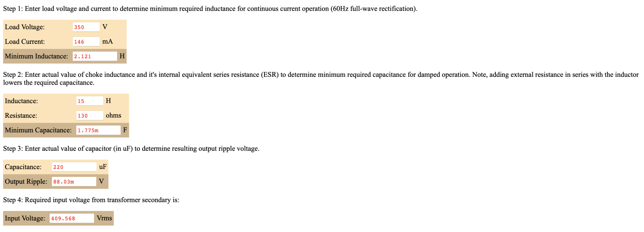

Haven't messed with it but the Hagerman site was cached and the calculators all work via the Wayback Machine: https://web.archive.org/web/20060106000537/http://www.hagtech.com/theory.html
Entered my parameters (350V B+, 146mA current draw, 15H/130 Ohm choke, 220uF first cap), but wonder where and how the ripple is measured.

Did you use the PSUD2 internal calculator for the effective secondary winding resistance of 140.5 ohm ?
Is 147mA your idle loading at 354V ?
If you do a stepped load current from 147 to say 247mA, the responses show no sign of any resonance.
The ripple current of 21mA into the first filter cap is likely benign for the cap you are using.
The continuous peak diode current of 0.18A is well below rated. The hot turn-on peak of nearly 1A is also well below rated.
Why do you think you have an inrush concern that needs a solution ?
i used the internal calculator. the specs are 53.1 ohm on the 420v secondary tap. i added 10% to get my off load voltage of 462v. i don’t have the winding resistance for the 120v primary…
the 147mA is the two 2a3s and the two 12at7 driver tubes. i’m looking for around 350V B+.
belt and suspenders i guess!
