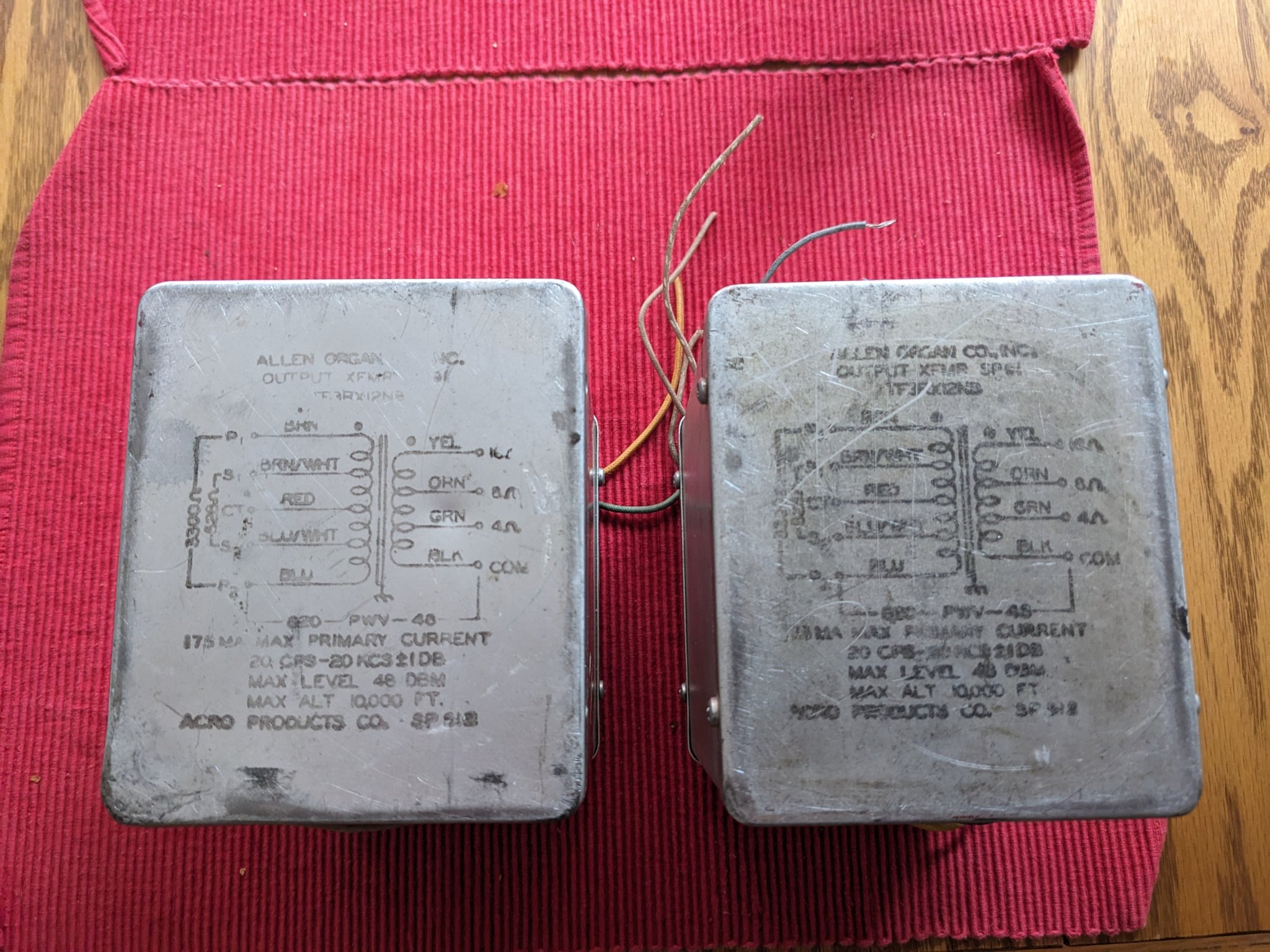

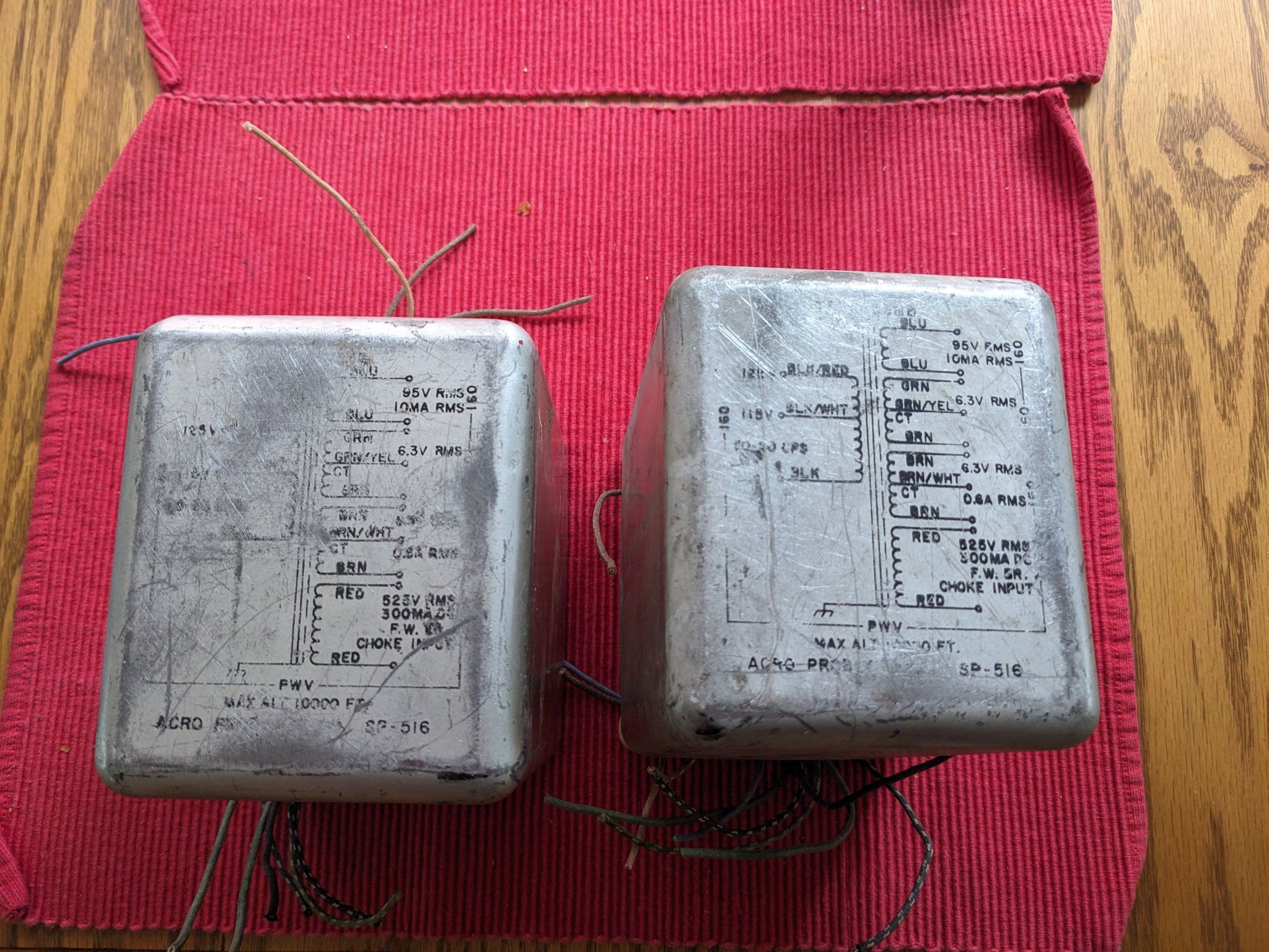

I had the good fortune of finding a full set of matching Acrosound iron from two Allen 75 (or maybe 90?) amplifiers (the old square Acro cans) at a show today. The chokes say 14hy, 40ma DC, 10V 60 CPS, 50 ohm. They are about 7lbs, so half the size of either the OPTs or PTs (14 lbs each). The Allen 75 schematics I've found show these are input chokes.
I have a couple of George's universal PP driver boards stored, and I'm thinking this will all be a good match. I'd aim for something that spends more time in class A than the original implementation, and I'm puzzled by the size and markings on the chokes. Even biased in the original use, how could 40ma be sufficient? The OPTs are marked for 175ma (These are TO-340/350 sized, but 3.3K rather than a stock model). The only choke input amp I've built was a 6V6 push pull, and despite all the rest of the iron being MUCH smaller, I used a 15lb old Stancor that was rated for LC use.

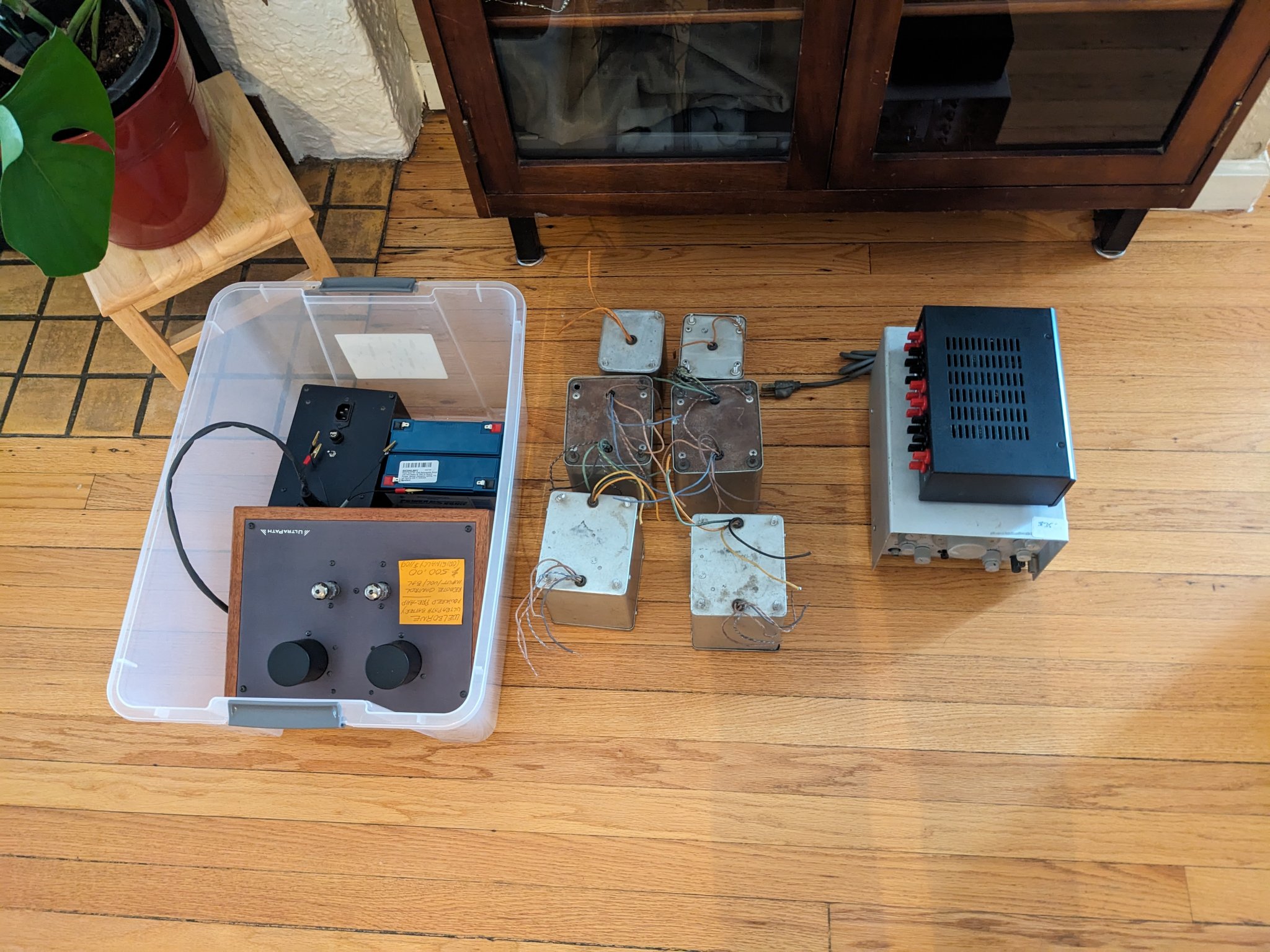

Pics for the curious, but you'll have to settle for the chokes pictured upside down in the whole haul. I'm busy now enjoying that Welborne battery powered pre with its Electra-print opts!

OPT with 40% turns UL (16% impedance loading) was textbook for 6550's.
