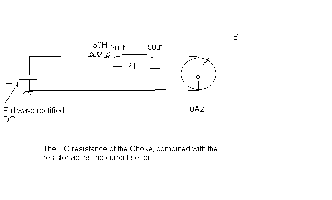

alexmoose said:Is there a good tube-based regulator that comes to mind? I see a good SS regulator on Gamie's Audio Lab
But I am trying to find something that allows for simple Point-to-Point soldering and I have heard great things about the 30h-50uf-30h-50uf with the preamp I am going to use

alexmoose said:The power Transformer is 250-0-250v at 60ma. the desired operating point on my 5687 tube will be at 140v, at 11ma, so 22ma for both halves of the dual triode.
-Alex
perfect for OA2
say-just one , burning some 20 to 25mA,then RC to each anode ,burning additional 10 Volts

Zen Mod said:
perfect for OA2
woah! Cold cathodes scare me! could I see a very basic circuit?

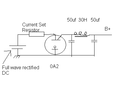

alexmoose said:This is a guess, will this work? sorry about the low quality, I made it in 20 minutes
on sunday,when I'll be near my PC ,I'll answer you;
sheeeeeeeeeeeeety IE just killing me on this machine
PS. NO CAP IN PARA WITH GAS TOOB!!

Any help yet? I want to be enlightened, I need to build a pre-amp because my Ipod cannot drive my amp alone!
Then it is a good idea to use a gas tube! Your schematic is almost inverted, you should start with raw DC then add filtering and then at the end you put the gas tube. The gas tube will improve the regulation so there is less need to use a choke so something like this is the normal connection:
Rectification > cap > resistor > gas tube > small cap, (max 0.1uF) this can in many cases be left out. The 2nd resistor must be calculated for the current draw which is current for the amplifier + current for the gas tube, the gas tube should carry 5 - 30, 35 or 40mA depending on the type, regulation gets bad if current is less than 5mA and you risk burning the gas tube in advance if current is too high.
Example: DC at the last cap 200V and you use a 0A2 which has a regulation voltage of 150V you should therefore drop 50V over the last resistor. Assume that the amplifier draws 20mA, then a suitablle current through the resistor is 35mA which leaves 15mA for the gas tube, the resistor value is then U/I or 50/35 ~ 1.43kohm. For higher voltages it is possible to connect several gas tubes in series.
