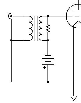

Speaking of battery bias. This schematic which comes from the site of Troels Gravesen uses a battery in series with the grid. I have also seen this type of bias arrangement in a linestage or phonostage from an American company.
