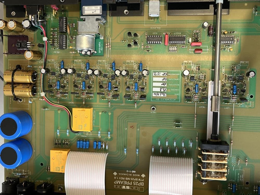

Anyway, are those signal caps ever necessary? I saw people just remove them (replace with wire). In worse case you will get like 50mV DC on output?
Anyway I've noticed one uk company is just removing them...

Also old SST Amps are not using signal caps at all.

I see that, just plain remove and replace with a 0ohm resistor, maybe one could use just some silver wire.

What about 100nF ceramic caps in DOA modules? That UK company is removing them, but I'm cosidering it replacing with MKP caps, because I hate ceramics caps in audio, they are microphonic and add nasty non linearities.
between ceramic and plastic i would take plastic For small values i would look at what can be found in top quality phono preamps or mic preamps
A high gain can enhance different sonic signatures
Plastic film caps may be high inductance, unlike ceramic, leading to a risk of oscillation. Depends on the construction.
