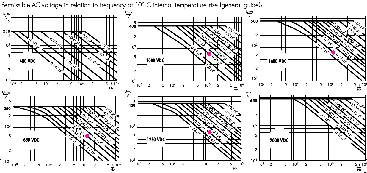

Howdy. I'm thinking about an electronics project which isn't audio but rather a ZVS induction heater based on the Mazilli Flyback converter. Cheap eBay models have caps which produce large amounts of heat and run at too low a resonant frequency. As I browsed the likes of Wima FKP 4 caps I note that dissipation factors for 100kHz aren't shown for capacitance greater than 0.1uF. I'm looking at a design with 6 x 0.22uF capacitance and a work coil which would target a resonance of circa 135kHz. Obviously I'd like to minimise heat emission from the caps. So wondering why dissipation factors aren't provided for these.

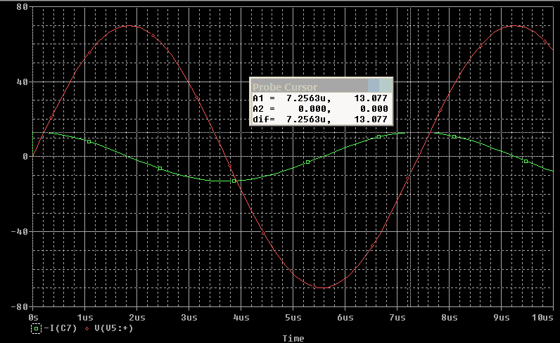

The first Wima FKP 4 datasheet I found does list temp rise. For 10 deg C rise, a 0.22uFd can only be worked at 50V-60V, kinda no matter what the cap's DC voltage is.
Obviously there is current. A quick sim for 0.22u 70V(pk) 135KHz gives 13 Amps peak, which is a lot for a small part if worked continually.

Hi. Thanks for pointing out how to read that part of the datasheet correctly. I hadn't made it into simulating the circuit yet. The eBay purchased model's circuit is this:

What did you sim to get your current estimate? Of course the sinusoidal current would be spread over the 6 parallel caps.
