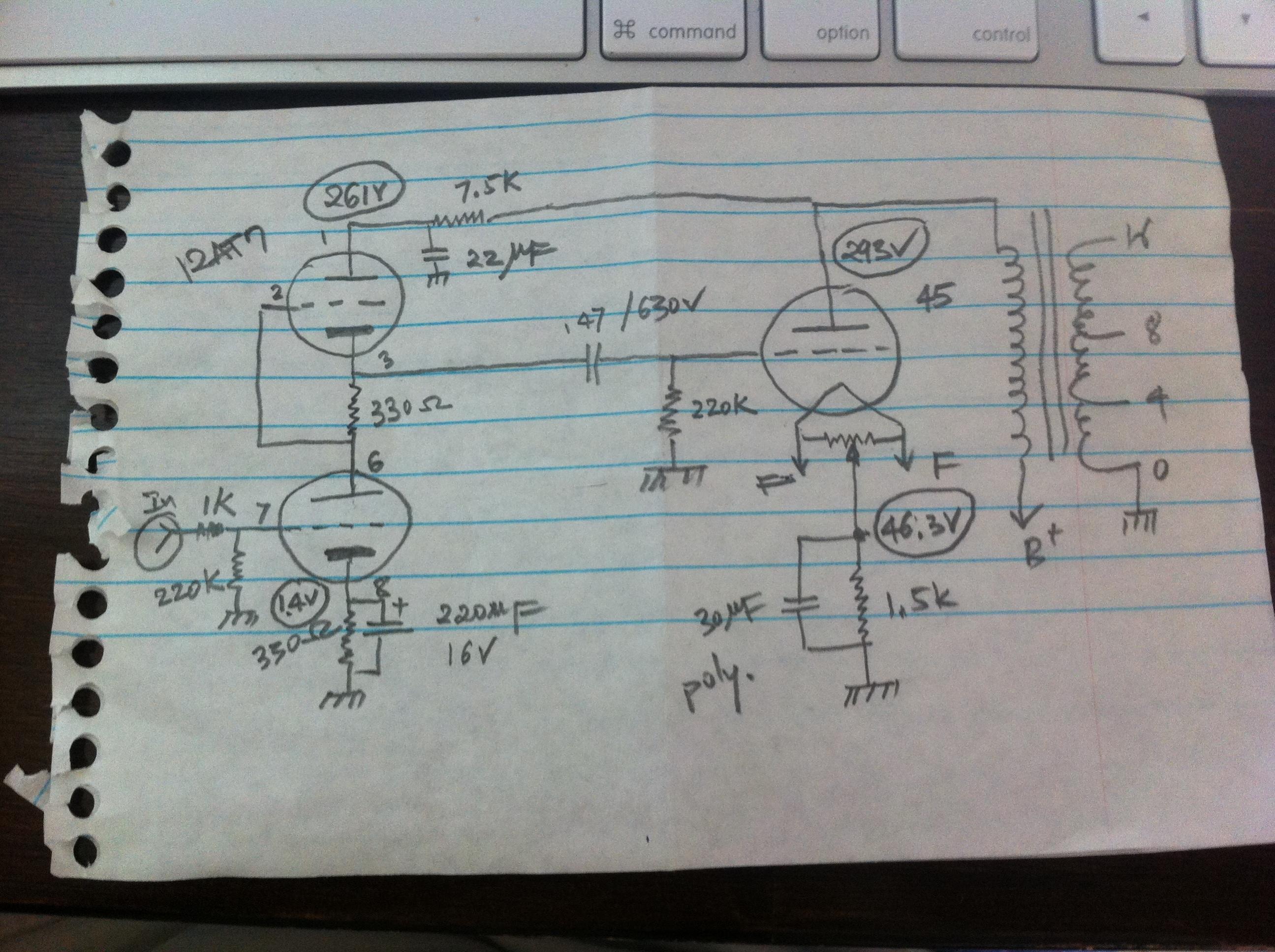

I have built a pair mono block 45 SE amp with cap coupling. The circuit is base on 2A3 Ranking Gordon SE amp. It sounds good and I just wonder there is way to improve the sound by mod it from cap coupling to IT or direct coupling? Thanking in advance for your input!
Below is the schematic of the amp that I build

That's the Bugle circuit. Rankin also designed a direct coupled 45 circuit using 6BM8 as driver and current source published in Sound Practices that you can try. But the B+ needs to be raised to 450Vdc though. If you're using choke loaded power supply per Bugle schematic, changing it to cap loaded will increase the B+. The 6BM8 pentode section really is acting as a slow warm up before the triode section starts to draw current so the 45 grid is not slammed with high DC voltage. If you want to try octal tubes, the 6EM7 will give you similar result with minor tweaks.
I have built similar direct coupled 45 circuits before and it can sound really good, provided the output transformers are quality items.

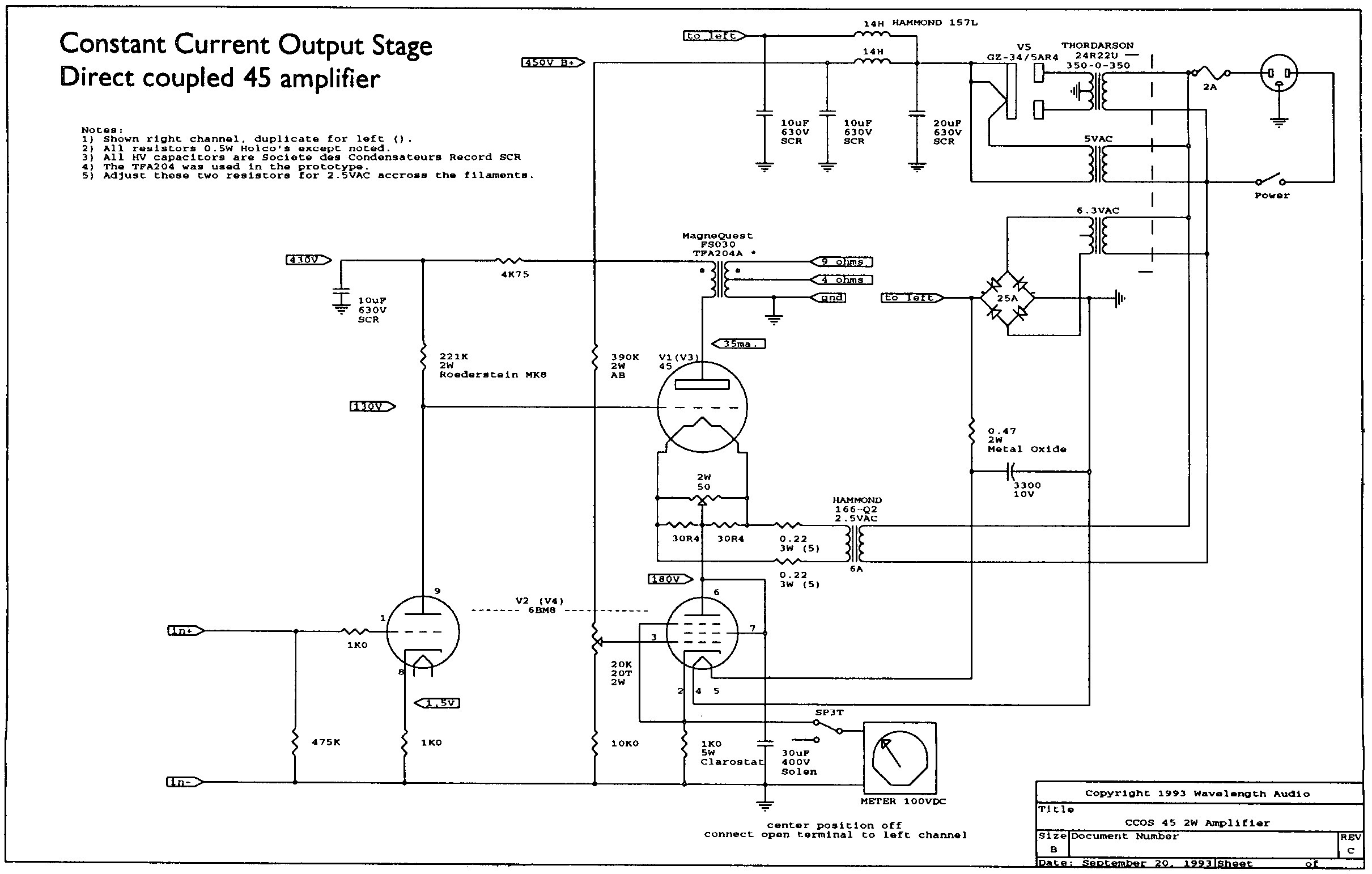

Has any one out there built the gordon rankin constant current 45 amp schematic posted here? I am gonna breadboard it and see how it goes, I have the iron and tubes and caps. Wondering how the 20 turn pot plays into the design. Is it used to tune into the 180v at the plate? The meter's range is noted to be 100 VDC. I don't get it.
The meter is measuring the drop across the 1k, for a current of 35mA. The 30uF cap quality is critical.

The easiest way to simplify the circuit in post #1 is to remove the top triode section of the 12AT7 with an IXYS 900V or 450V current source. And a stereo amp will need only one 12AT7, and you do not have to worry about the filament to cathode voltage rating of the (now removed) top 12AT7. I expect the sound quality to be very close to each other between the 12AT7 top triode circuit, and IXYS circuit.
As to the Pentode constant current circuit: The 180V is approximate. Change the 45, and it will be different. Change the B+, and it will be different. As was stated in post #6, adjust the potentiometer for 35V across the 1k resistor, the 45 will have 35mA.
Actually, one of the 45 data sheets suggested operating points is 36mA, and 275V plate to filament. It is the highest power out in the data sheet, but I do not remember the required primary impedance of the output transformer, I think it is 4600 Ohms. That should give 2 Watts (if the output transformer is low loss).
