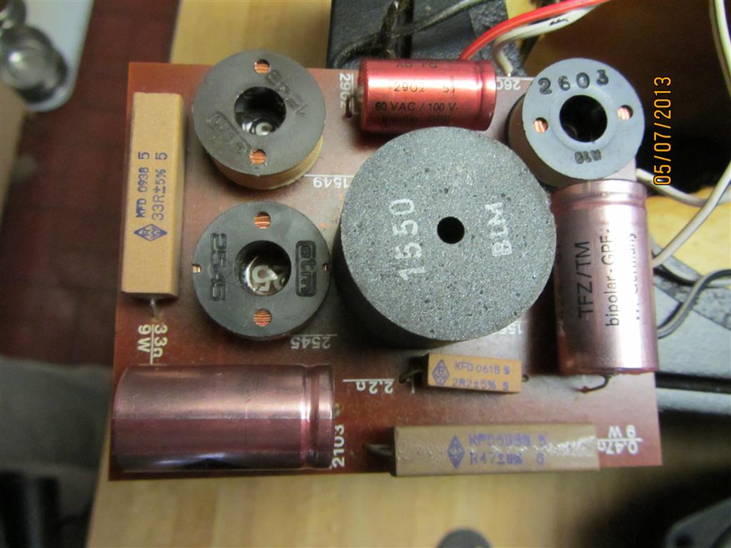

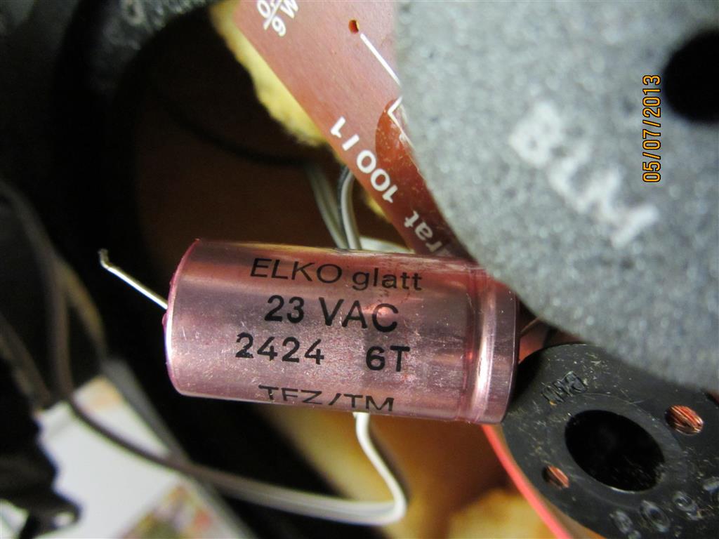

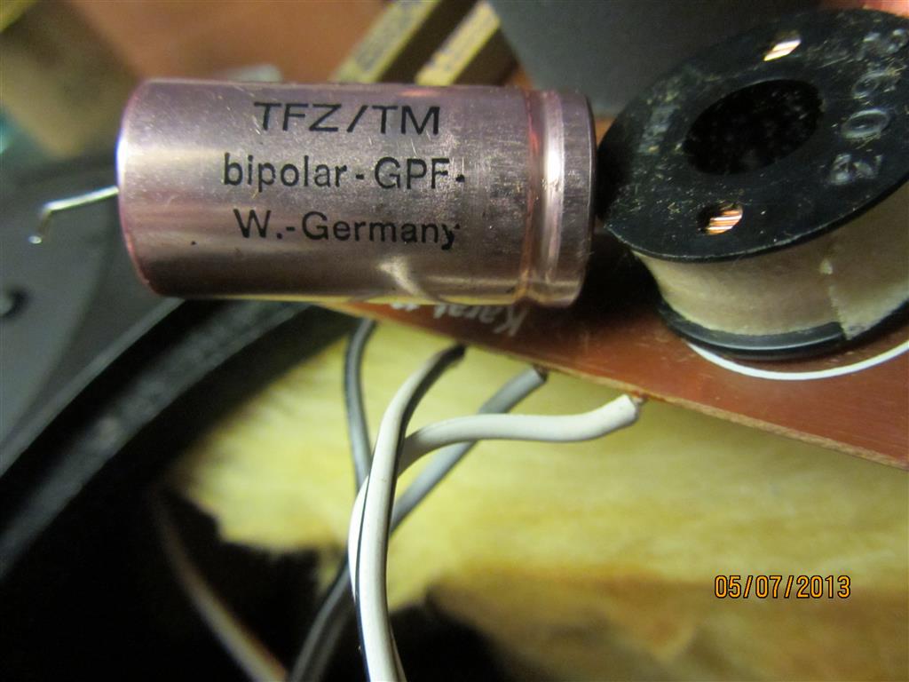

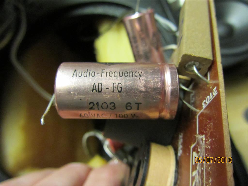

Just dragged home yet another set of speakers, Canton Karat 100s. I wanted to upgrade the XO caps since it sounds a little shrill to me, but the caps aren't actually marked with a clear uF symbol. Can anyone read the cap values from the markings shown on the pics?
Thanks!

I know this is a huge bump, but I thought I'd add this here for anyone looking to recap these speakers.
I found this info on a Polish site (Link) and all credit goes to BB84.
1. WEGO ELKO Glatt
23VAC
2424 6T
TFZ/TM
Bipolar GPF
Hier weiss ich, dass es 33uF sind.
33 µF / 23 VAC +/-10%; Abm: 18x35mm
2. WEGO Audio Frequency
AD-FG
2902 7T
70VAC/100V
Bipolar GPF
Maasse 25x14mm
3,3µF / 60 VAC +/-5%; Abm: 14x25mm
3. WEGO Audio Frequency
AD-FG
2103 7T
60VAC/100V
Bipolar GPF
Maasse 35x18mm
10 µF / 60 VAC +/-5%; Abm: 18x35 mm
These are for the Karat 200s, but they seem to use the same caps, so should be good to go.
Hope this info helps someone, I was looking everywhere for this info.
