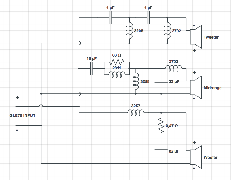

I Itco Member Joined 2009 2011-08-09 6:23 pm #1 2011-08-09 6:23 pm #1 Help please. Does anybody have filter schematic on Canton GLE 70. J Jackomee Member Joined 2017 2022-01-09 12:18 pm #2 2022-01-09 12:18 pm #2 Hi, here you are. I took it from my crossover board! Glad to being useful... Regards Attachments GLE70 Crossover schematics.png 14.7 KB · Views: 543 You must log in or register to reply here.
