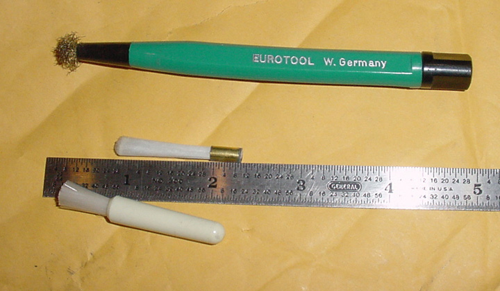

I agree – I use the fat, soft one at the bottom in this photo. I use it to gently wipe the dust off the entire bottom of the cartridge body every few plays. It is very soft, like a watercolor brush. Came with a cartridge I once owned I guess. I use other tools for the diamond itself.
The Eurotool that I have, probably the same maker as the Glasrubber, is MUCH too stiff to use on a delicate cantilever. It is adjustable, the amount of bristles extending out of the black cone area. With the white fiberglass insert installed instead of the beat up brass one in the photo, it is OK for cleaning electrical contacts or removing light brass corrosion, but would destroy a soft suspension on a quality cartridge.
I would try cheap artist brushes and probably cut the tip square off to keep individual bristles from getting up into the suspension area, and use it dry so solvent does not wick up into the suspension.
