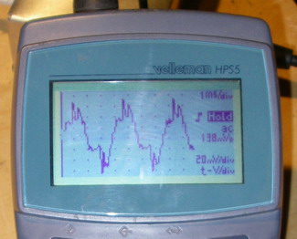

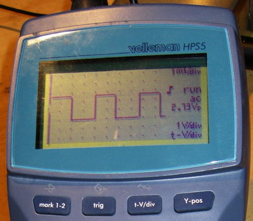

Yesterday I wanted to actually do something, so I constructed simple 2 transistor circuit, found the schematics on the web, it did not want to oscillate at first, but once I raised the voltage from 1.5 to 5 or 9, it produced nice square wave 100 Hz, 2.6 Vpp.
I have only simple hand held velleman oscilloscope, but it is good enough for experimentation.
So I fed it to my second system and looked at trace on the mike. It looks just like John k... small white insert on the bottom.
So...where do we go now? What do I do next? I want to experiment, improve...
My system is sounding freaking good, but measures poorly. The square wave out is nothing like square wave in. Am I disappointed? Not really. System sounds good. But I would like to improve it.
System is biamplified, active crossover, solid state for 15" woofer in closed box, tube amp for mid/hights on open baffle. The way I like it.
Can you comment? Lets keep this thread rolling.
here are the pictures from the scope
