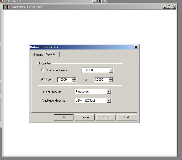

The problem is importing data into SpeakerWorkshop. I’ve tried importing the data as a *.CSV and as a tab-delimited text file. I’ve also tried adding a constant to the dB values to make them all positive. When I edit the properties of the imported file, I get the dialogue box seen in the first picture. I’ve tried typing in every combination of values into those fields that I can think of, and I’ve never gotten a graph to appear.
For example, the file I’m trying to import has 20277 points (rows). Columns are frequency (from 300 to 30000), dB (all positive numbers), and phase (-180 to 180). I’ve rounded all values to 1, in case SW can’t handle all those decimal places. See screenshot of data as an MS Excel file in the second picture.
In the “Dataset Properties” dialogue box in SW, I’ve tried typing “20277” in the “Number of Points” field (what else could that field possibly refer to?) and I’ve tried leaving it at the default value of “2.0000”. What are those decimal places for? How could the number of points be anything other than a whole number? For “start” and “end” I’ve tried “1” and “20277”, respectively. I’ve also tried “300” and “30000”, respectively, and I’ve tried leaving them at the default values of “1.0000” and “1.000”. I’ve always chosen “Frequency” and “dBW” for “unit of measure” and “amplitude measure”. I’ve tried importing the data as a CSV file, and a tab-delimited text file. No matter what – no graphs!

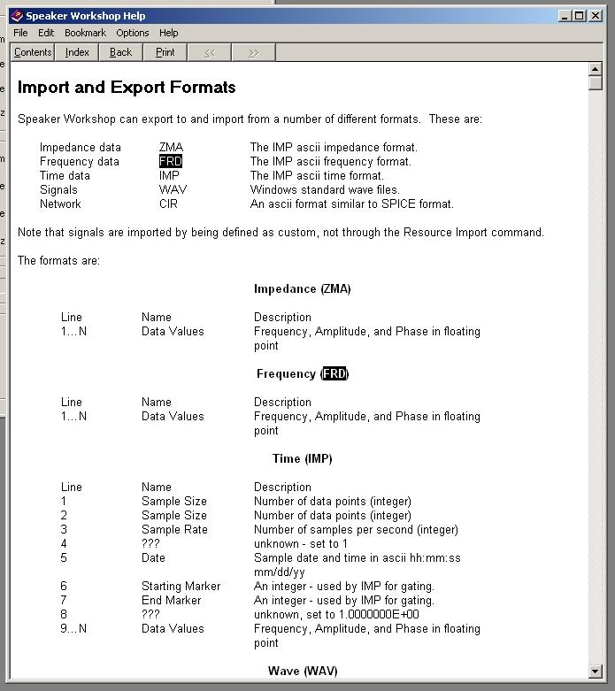

The third picture is a screenshot of SW’s worthless help file. I have no idea what “IMP” means. I don’t know whether or not Excel exports files in ASCII format. I’ve used Notepad to export the data as an ANSI file, which does not work either.

Hi Byron, you need to select custom format for starters. tick export phase, choose degrees don't tick unwrap phase.
I use Non-Equidistant (for the frequency increments) I think Pano uses loarithmic.
Click on the text options tab and choose the following:
Column separator space
decimal separator .(Dot)
if you still have trouble try unticking Information in header file (I use it without problems).
Note that if you have recorded at 96Khz or higher when you export it will drop it back to 48Khz (at least that is the case with the Non-Equidistant option).
Give the file a .frd extention and it should import into speaker worksh0o without any problem.
