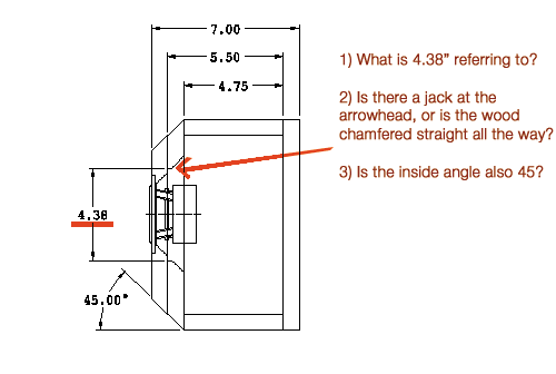

Anyone here must have built John Krutke's low diffraction box for the TB 871 driver?
http://www.zaphaudio.com/audio-speaker11-box3.gif
Basically, I wonder how the baffle detail would look from behind.
If I would stand inside the box and look out through the driver, how would the box look?
I've attached a image with my questions marked out.
Any help would be much appreciated.
Thanks / C.J

That's actually a very good question. The reason that dimension is shown isn't very clear.
Basically, the hole in the 2nd baffle layer starts out as a straight thru hole of 4.38" diameter. Then I used a 1/2" chamfer bit to chamfer the rest of the inside.
That little flat area you see is where the ball bearing for the chamfer bit went around. That is why it's not a straight chamfer, the ball bearing needed a surface to ride on.

Thank you for the quick answer!
If the hole in the first baffle layer starts out with a diameter of 3 inches, and is chamfered at an angle of 45 degrees,
that must mean that the hole ends with an diameter of 4.5 inches (increments 0.75" at each side.)
But the 2nd baffle layer hole starts with a diameter of 4.38". I'll guess this mean the inside angle is not exactly 45 degrees, but somewhat less.
