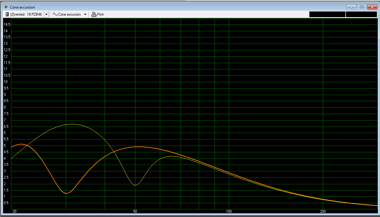

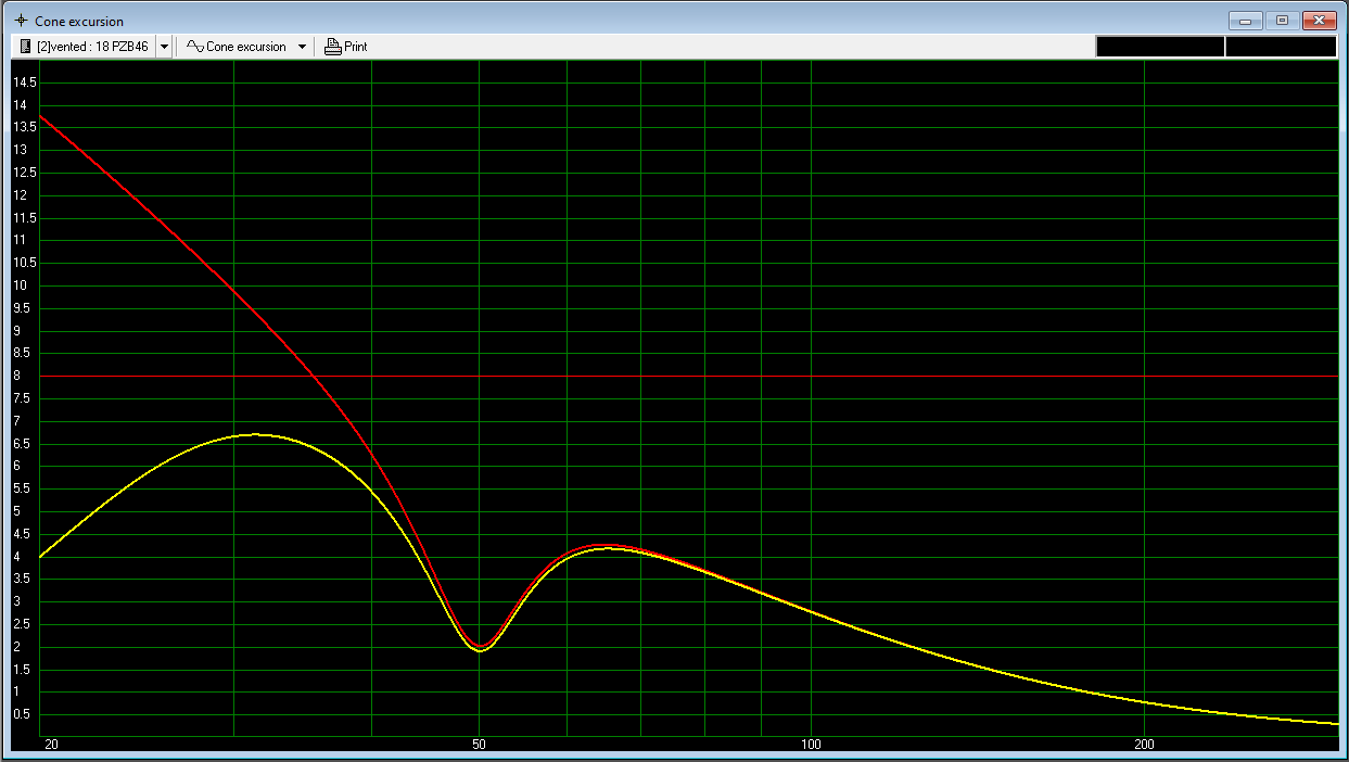

Whatever the tuning is that is where the cone movement is very little.
Basically any accuracy or transient response is pretty much gone.
From that point down. Easily visible in Cone excursion screen.
Also visible would be how much power you can actually apply
and what frequency it is unloading at 10% distortion ( xmax)

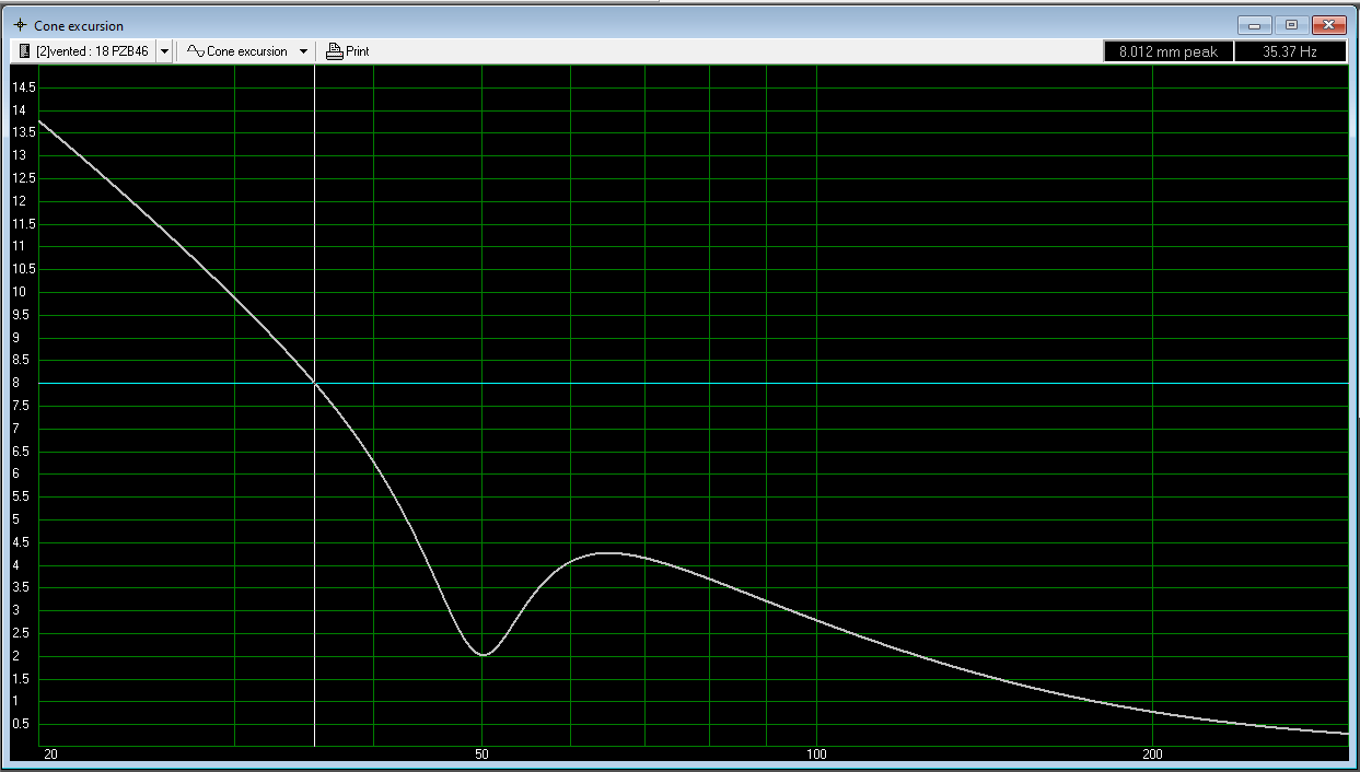

Looking at the 18PZB46 in 185 liters 50 Hz Fb
With 250 watts its unloading at 35 Hz 8mm
and at 20 Hz would be close to hitting the plate.
or physical damage.
Cone movement very little at 50 Hz
No transient or accuracy. And movement is already
getting limited at 60 Hz.

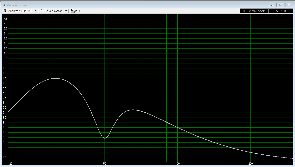

Now with 4th order Over Excursion protection High pass filter
Set to 25 Hz .707 Q
Unloading is reduced and you can apply 450 watts instead of
only 250 watts.
Or for a more visible difference can apply same power
with and without the high pass to see how it reduces unloading.
Reactions: 1 users
