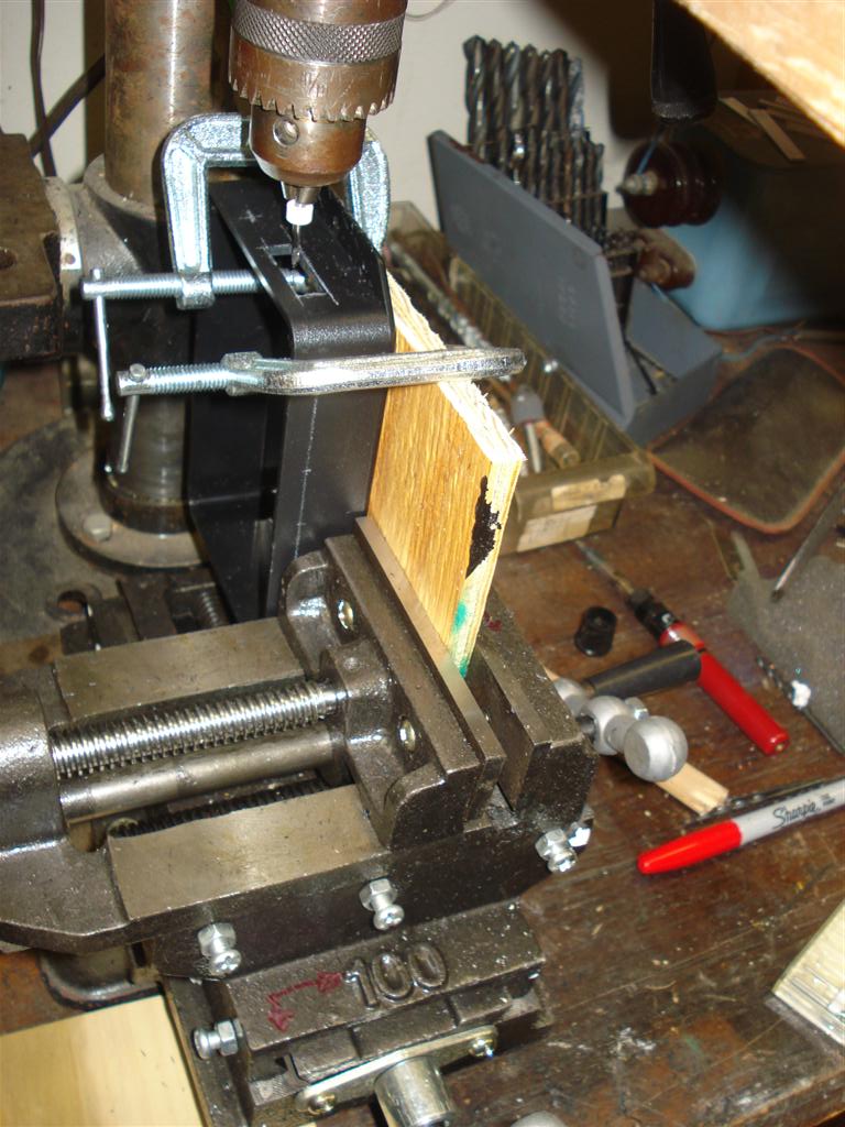

Another cheat is to get an X-Y table for the drill press.
IMO, the fence + drill press is the answer, plus grinding the bit so it doesn't grab. I think they call it "dubbing" when drilling brass. Plastic will melt at high speeds, so don't go too fast.
OH I *LOVE* My X/Y vise! This has been my long sought solution to cutting nice rectangles in plastic (see photo)! Just a tiny bit of filing, and they look factory made! BUT... for this seemingly simpler task of cutting a row of holes, I know it will help the holes be perfectly aligned, but I can't seem to get the hand of spacing the holes exactly equal. I'll give it another try, but its amazingly difficult to just get the absolute center point of the bit to come down EXACTLY at the mark. Maybe I need some light shadowing techniques or something. But yeah... here's my "poor mans milling" machine for cutting rectangles...
