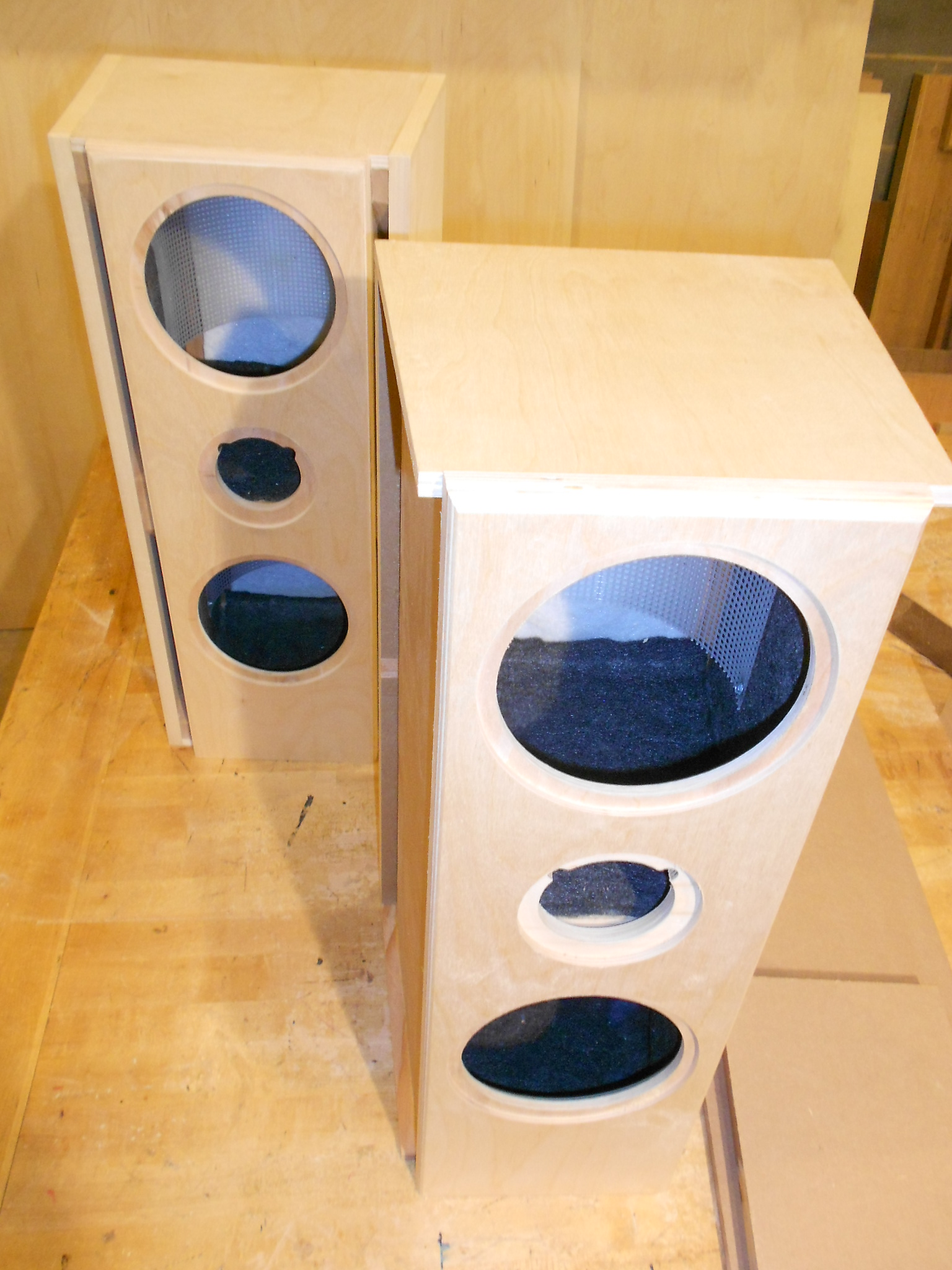

Some construction pics.
I don't have a way to measure (sorry) but the protypes sure sound great. I'll give the 6.5 SF a thumbs-up for great bass in a small box (12.5 liter per cell)

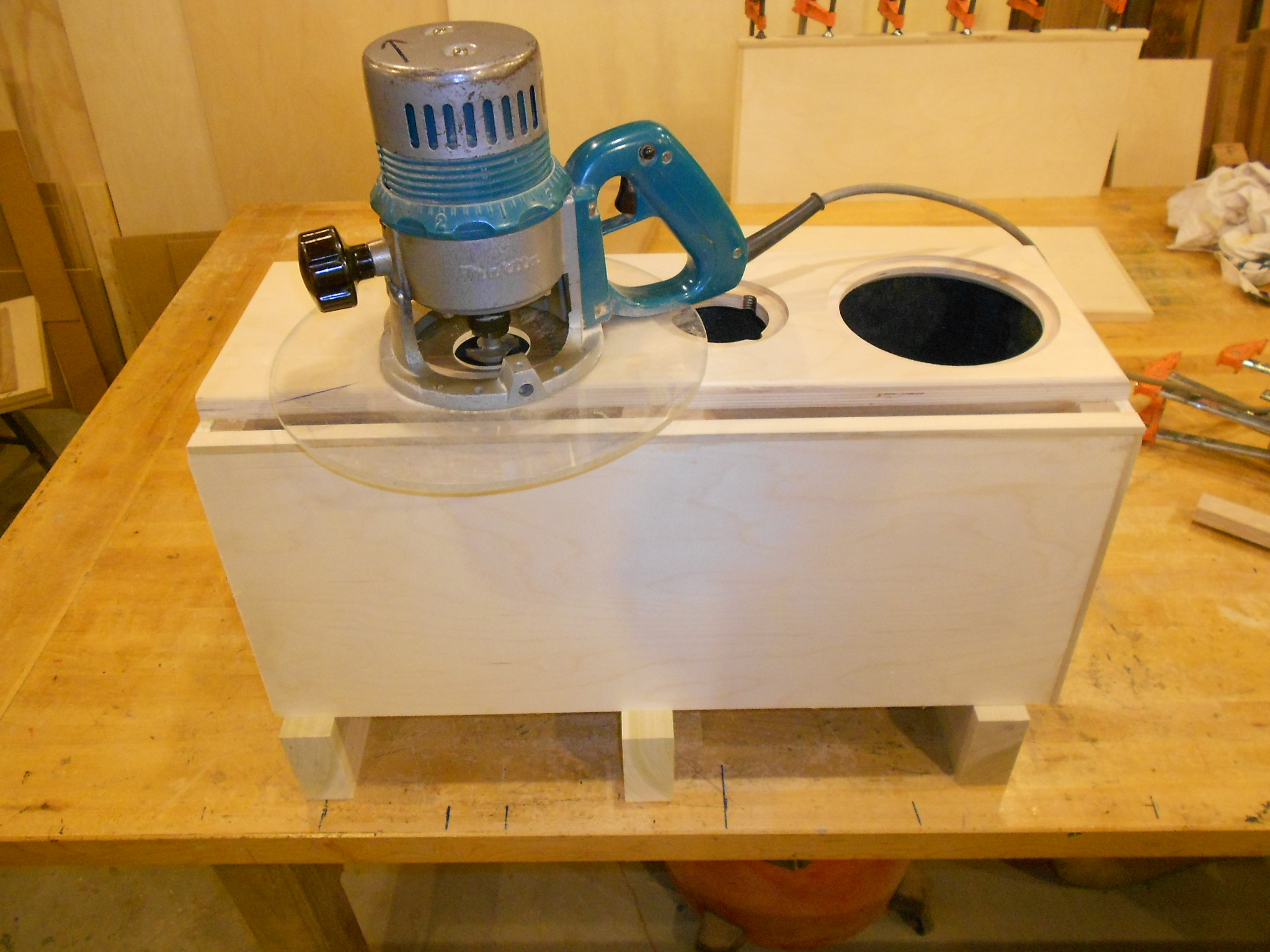

Flying saucer router base, should have done that a while ago, sure comes in handy, especially with small front baffle.

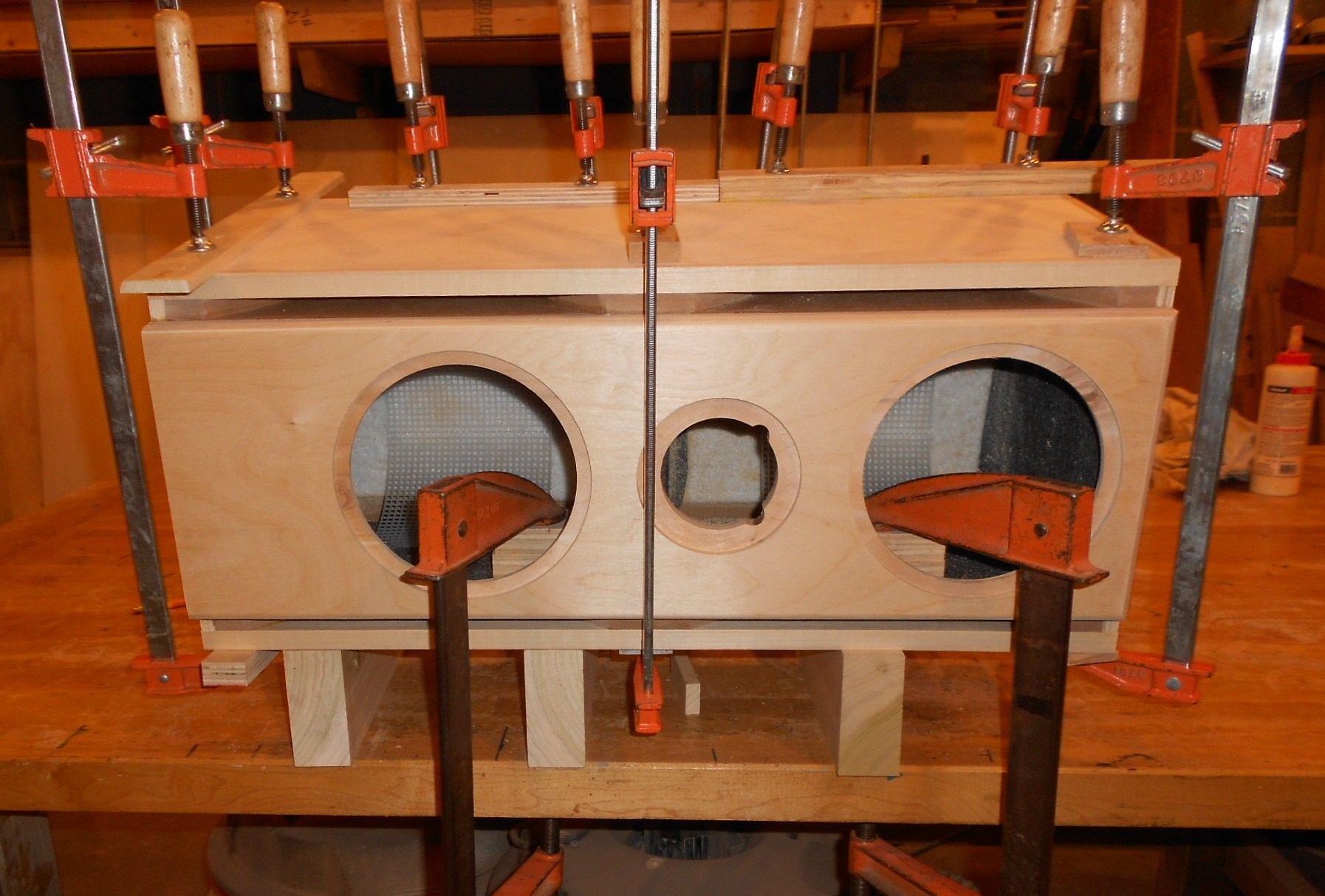

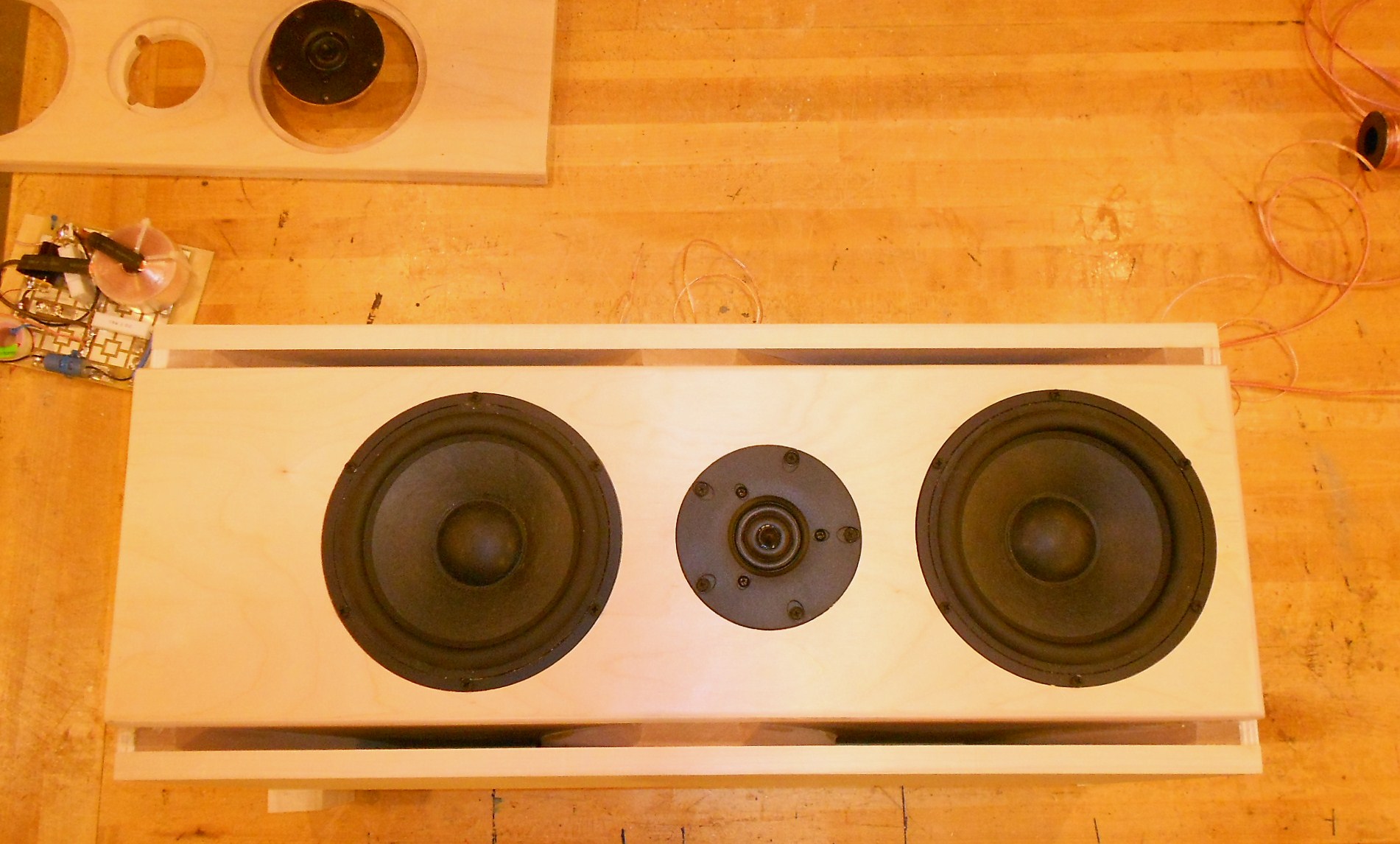

Been building these one at a time, looking for ways to speed up fabrication time, going super slow is not always the best thing anyway. A one day build would be nice, almost made it today.

Are you getting enough level from the Vifa XT25 tweeter with what I assume is a LOUD parallel wired 4 ohm bass configuration?

I had the same thoughts about tweeter would probably need a bit more energy, so went back to the original 2.2r for the tweeter (had a higher value in the 2-way).
So yes 4ohm, and the bass is crazy nice (wow).
I used two chambers because I would have had to re-do the whole vent plan if I went with " one" chamber, i.e. widen them/tweak them,,,ugh to much work.

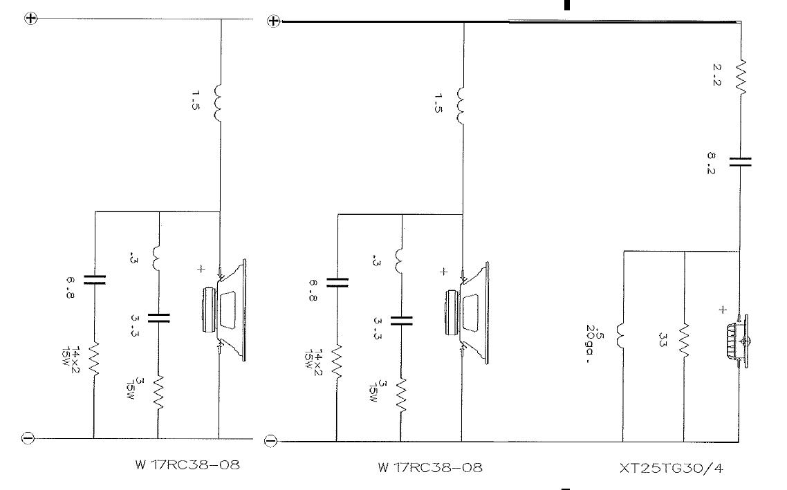

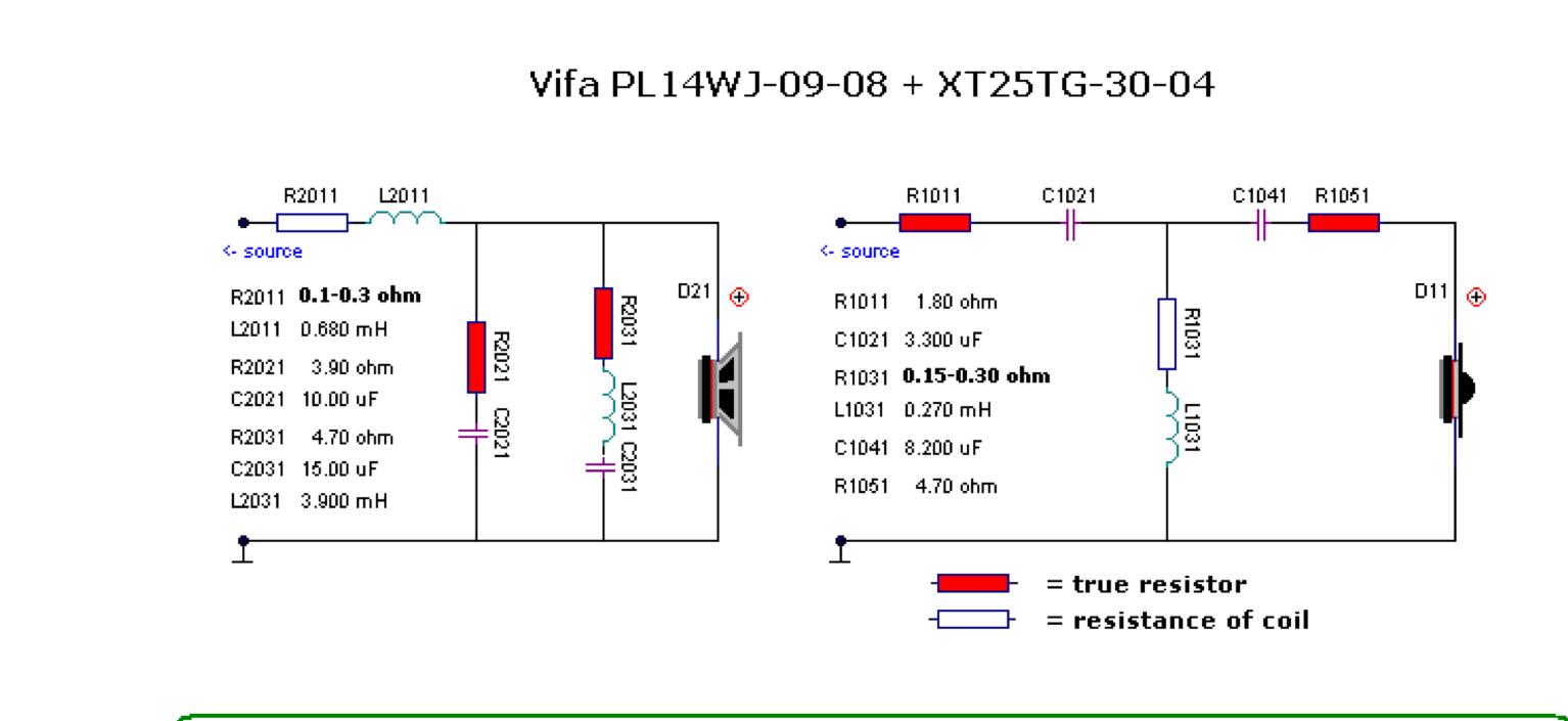

Lost some of the tweeter level moving them inside the woofers, which is not all since that's the weak link here. However one question plz (back to post 166) is the 2.2R and the 33R a L pad?
Still have the troelsgravesen studio monitor xo here, could easily slip that in, however I think the obvious thing is to look for better tweeter.
Essentially, yes although for it to be a text book kind would require the inductor to be on the other side of the 2r2 (the position of this resistor and the capacitor can be swapped with each other making no difference).
The two resistors would probably have been treated as separate points of freedom in the design. Their values may have been traded at some point against each other to satisfy such things as making the final impedance more usable, allowing certain values for the C and L, allowing components of a certain power rating, or ensuring a smooth response but for practical purposes the concept of an L-Pad here would be moot.

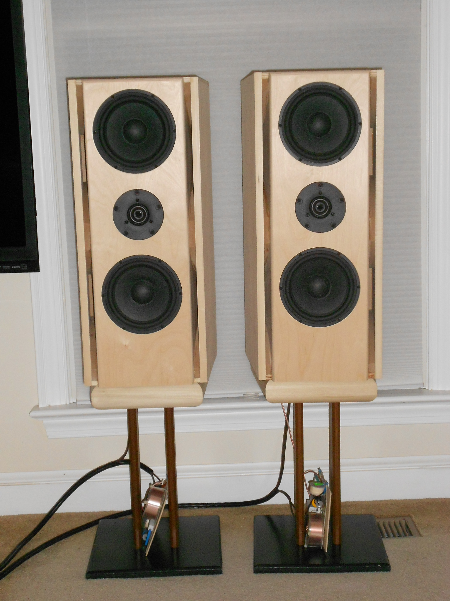

Doug, another thing to be aware of is that with the MTM config the speakers will have a very narrow dispersion in the vertical plain. That is you really need to be listening with ears at tweeter level or you WILL notice that the treble seems to be rolled off.

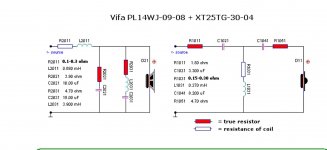

I assume we are talking about Troels' two versions of the Vifa PL14WJ.
Vifa PL14WJ-
He seems to just scrape it on the d'Appolito version on levels and impedance by lowering resistance in the treble filter.
Since you re struggling with tweeter level here on a 4R parallel wired d'Appolito, why not try the easier series wired 16R version? It's altogether easier to implement anyway, and I like what it does. Very easy amplifier load. 🙂

The stands could be higher (10") to bring the tweeters to ear level.

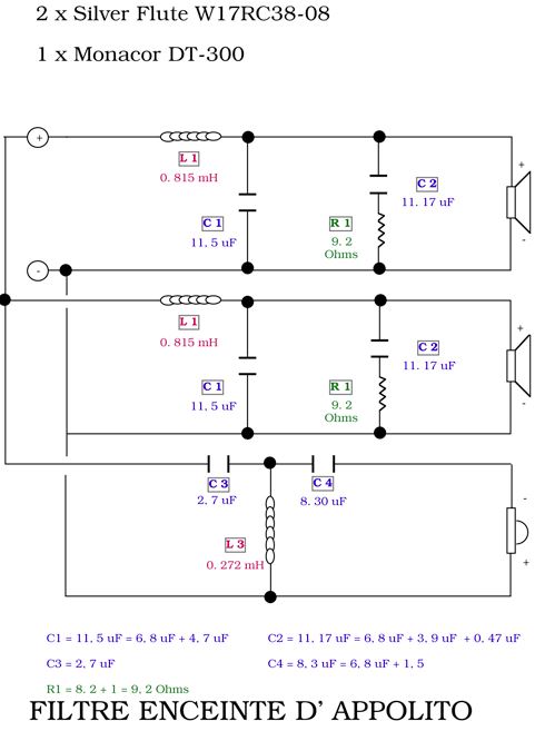

How did you end up doing the crossover, and does it have baffle step compo built in? You may find that with correct baffle step compensation your mids will come down a bit, lower bass up a bit, and then your tweeter will blend in very nicely.
