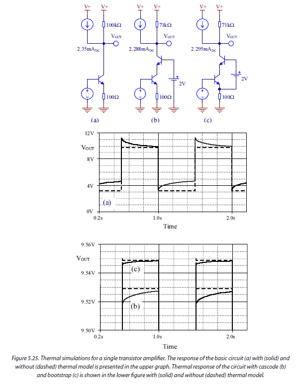

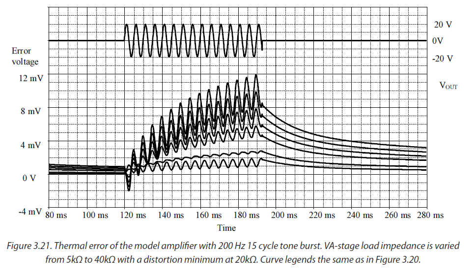

BTW There's a whole book about no-global loop feedback amplifiers and how to avoid or cancel memory distortion in amplifiers:
https://www.amazon.com/Audio-Power-...keywords=arto+kolinummi&qid=1617784819&sr=8-1
... that there are other errors to be considered in amplifier design, which do not receive enough attention. In this study, Dr. Kolinummi analyses many sources of distortion and measurement methods. His focus is specifically on dynamic and transient errors, which are not normally considered in measurements, and what Kolinummi calls ‘memory errors’. ...
Jan

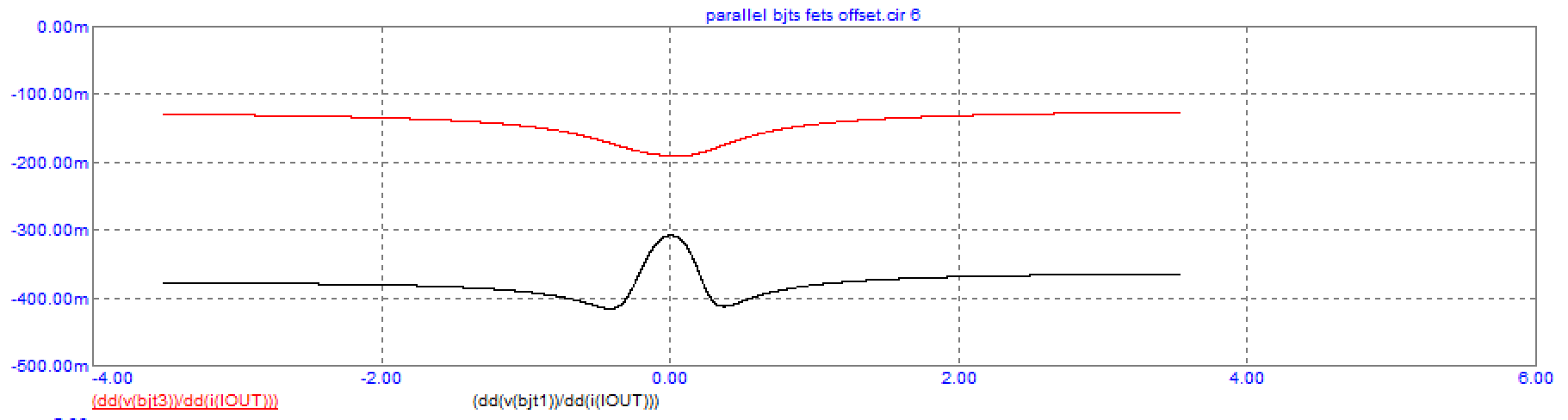

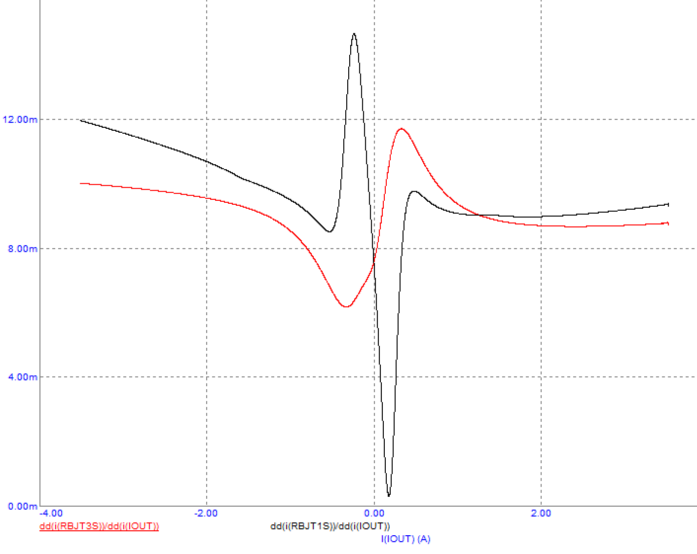

Good reasoning. But for a multiple push-pull pairs of an output stage, it is normal that each pair is set at the optimal bias. The better linearity they provide comes at a price : for three pairs instead of one, three times the quiescent current.

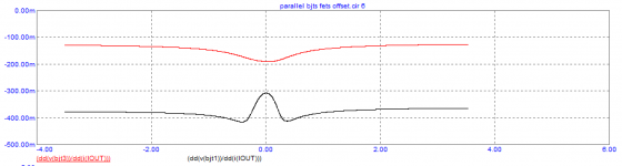

Yeah but "optimal bias" depends on the resistor (and vice versa) so you can still use more devices with the same total bias current by increasing the resistor. That would be a benefit if that allows you to pick the optimum emitter resistor value that avoids thermal runaway. Plus you get more SOA.
1 pair at 100mA (black) vs 3 pairs at 33mA each (red/blue) all with 0R33 resistors.
Plot 1 is gm, there is gm-doubling, but who cares.
Plot 2 is the base current, there is something suspicious.
Plot 3 is d(drive current)/d(output current) which is a bit like the inverse of the instantaneous current gain of the whole stage.
The one that has gm-doubling also has much much worse drive current. Note this is on a simulated 10kHz signal because the effect depends on capacitance, so it's not visible on a DC plot.
