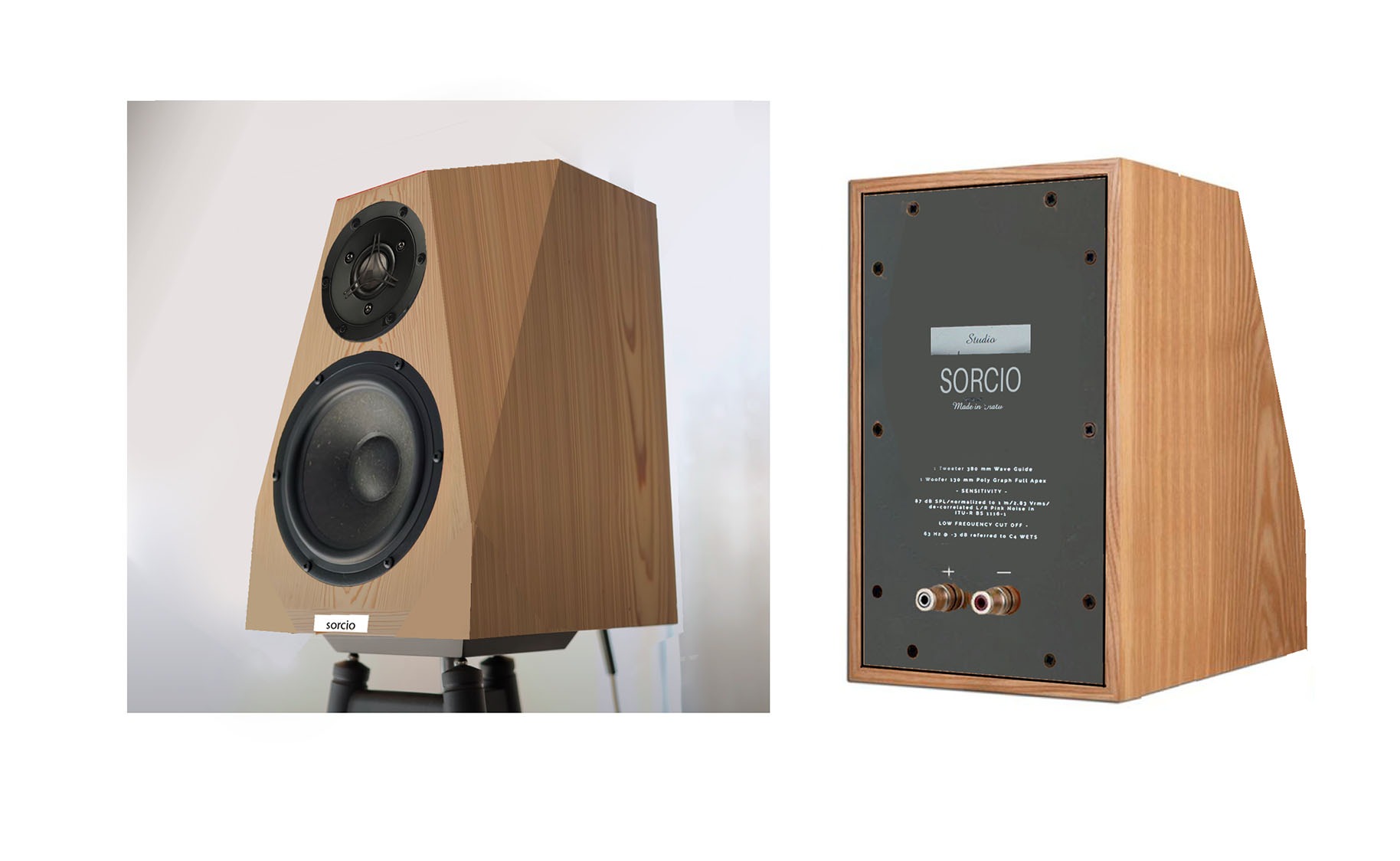

Thanks, i actually have it already and im basing my speaker build on that foundation.
(cabinet will be exactly same, photoshop mockup added just for interest..).
I already have two tweeters though that are different from the kit, and anyway since im very sensitive to sibilance i want to try them first could they work (bliesma t25s-6 and SBacoustic tw29txn-b)
