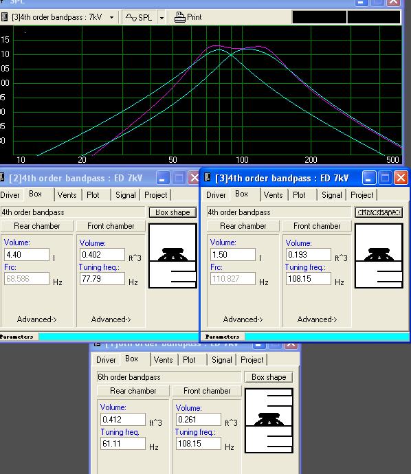

Can you use 2x 4th order BP boxes to imitate a 6th order BP ?

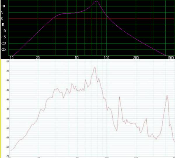

Box measured in vehicle with an 125Hz highpass (Couldn't measure without a highpass unless I ripped out lots of wires and swapped about a lot )

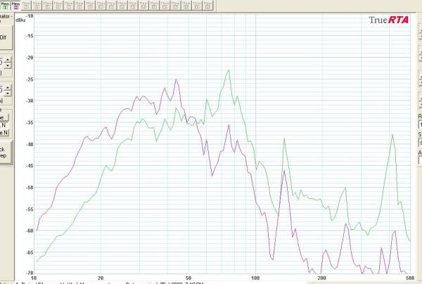

Mains and sub, 80Hz high pass and 80Hz lowpass on sub.
80Hz highpass on mains.
I'm pretty pleased with this project so will be building a pair of boxes for the car, and putting some time into tuning it all up properly.
