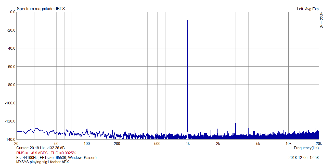

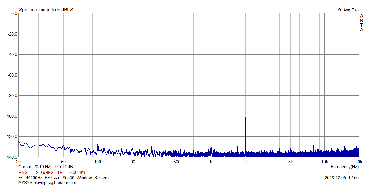

The question here is if foobar2000 is a bad player. If yes, the ABX tests using different equipment/systems are not reliable.

Instead of waving hands, could you show a loopback measurement with sig1 sine played once in foobar directly and then through ABX plug-in? The way I have it attached. And make sure you have set a proper Fs and resolution in Direct sound for your soundcard in the Control panel. If you do not do it, then there is no advice.
