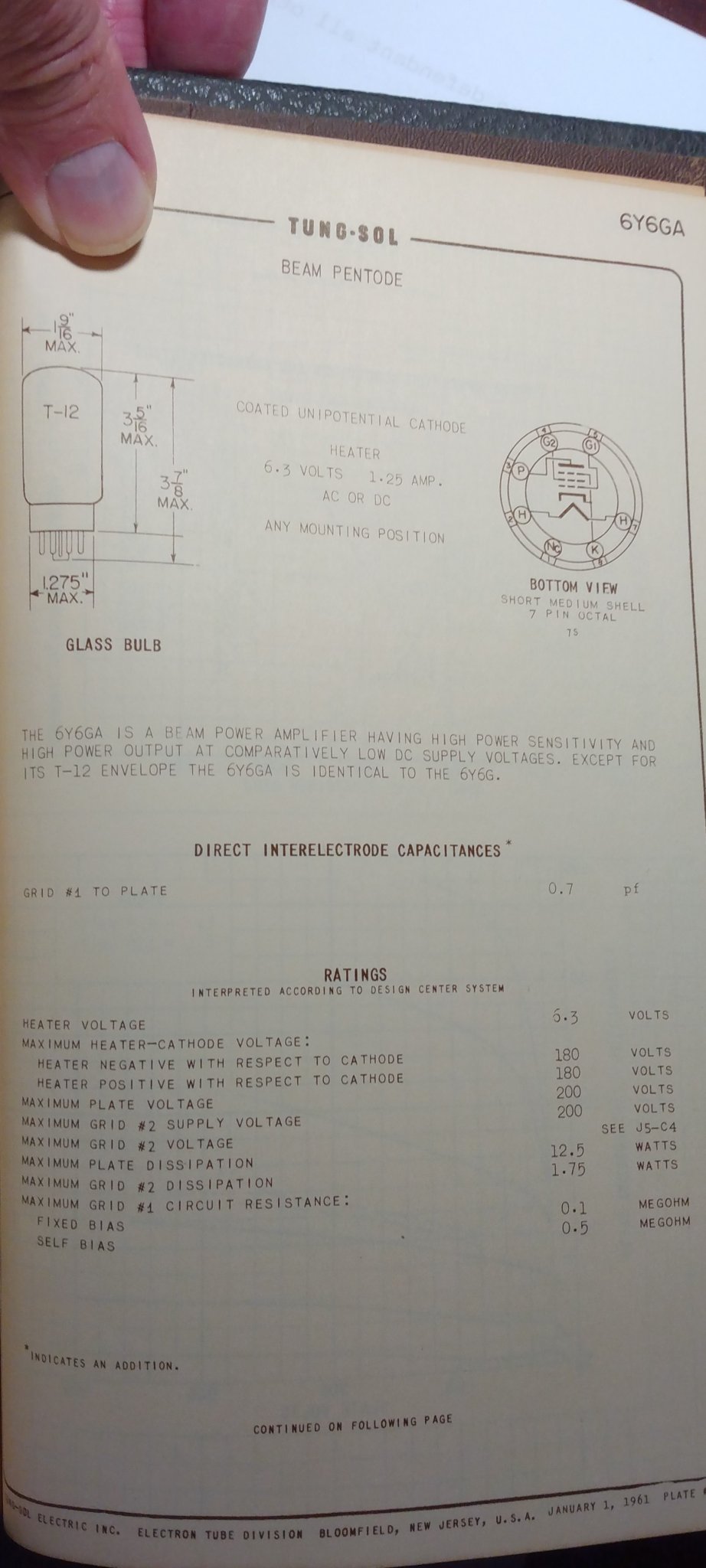

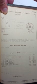

My Tung Sol data book shows the sheets for 6Y6GA with a 7 pin short octal base - pin 1 is no connection, and pin 6 is absent.
Sorry for the bad pic - it's too much work to pull out the individual pages and scan. It's a four volume set, and each volume is 3 or 4 inches thick.
Interestingly, the sheet mentions 6Y6G, but not 6Y6GT. I don't think I've ever seen a metal 6Y6. The other three variants are common - I found examples of each here at my office - my real tube stash is in my warehouse across town. It would be interesting to see a picture of metal 6Y6.
