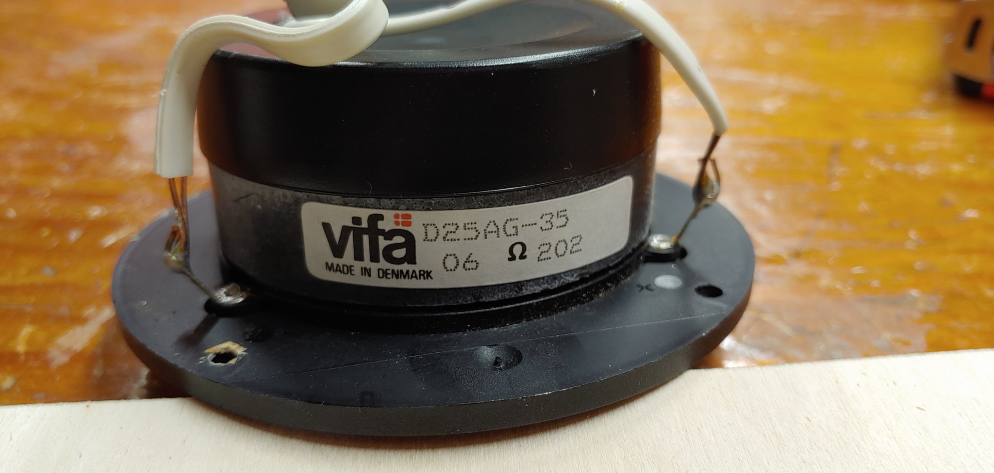

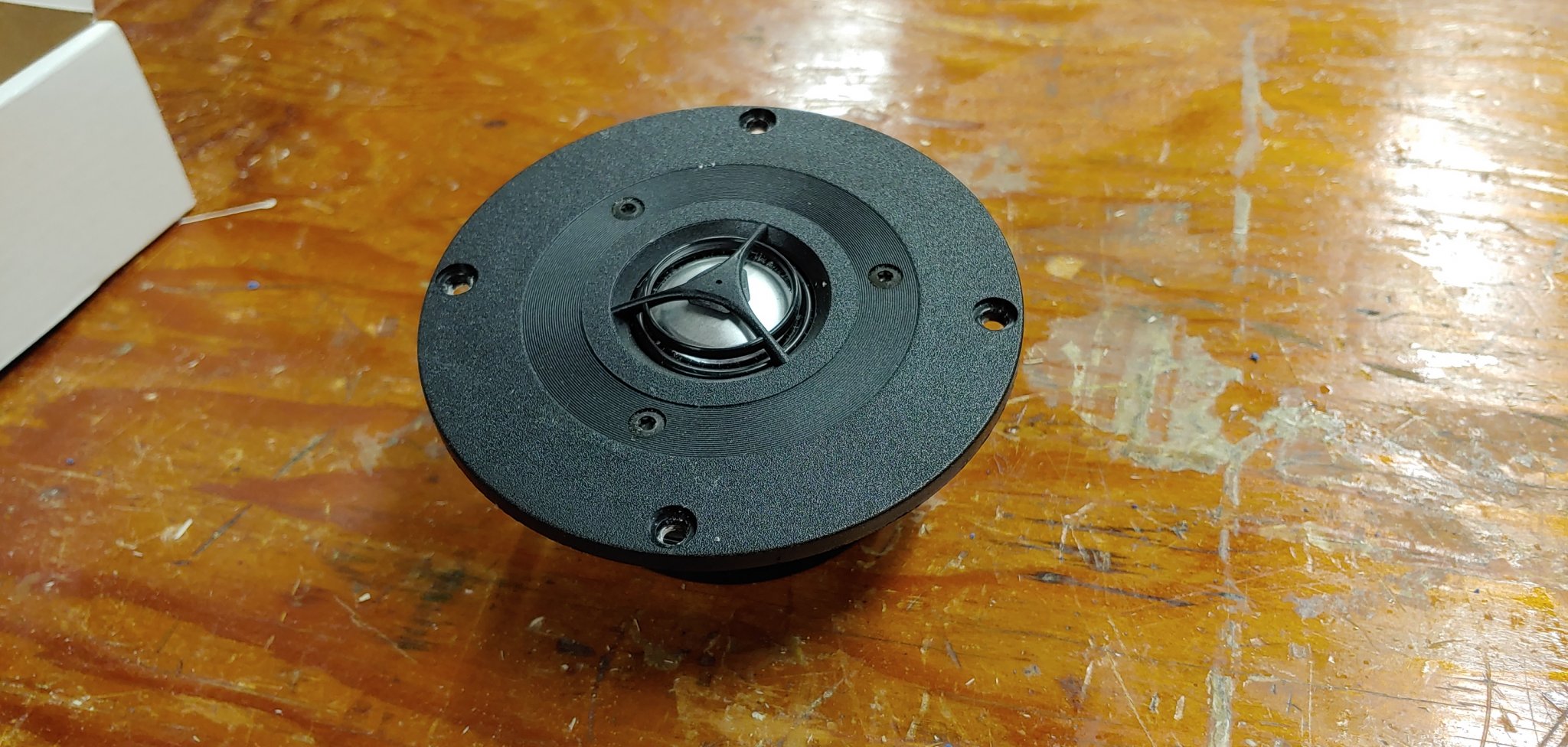

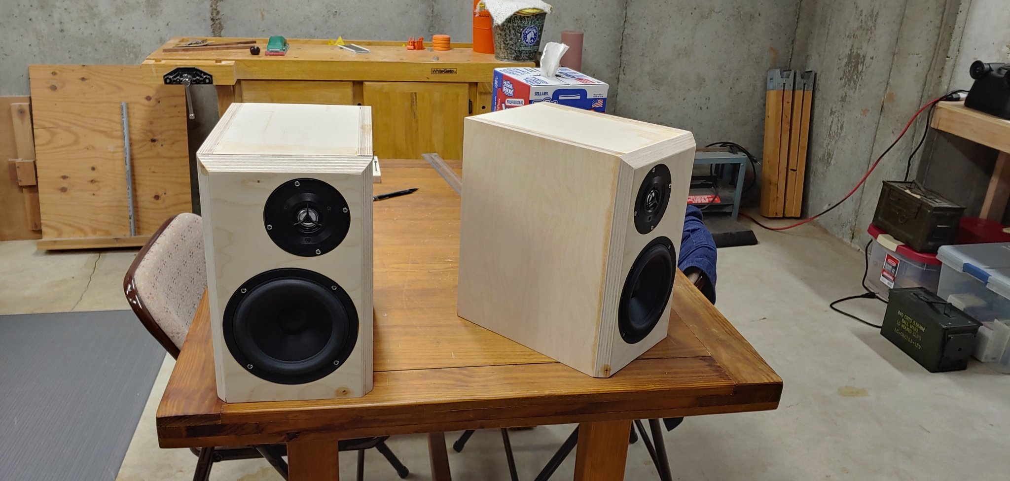

I also always thought they sounded nice. very natural. These tweeters are 28 years old, and I removed them from an old 3-way project I built in 1992. In 2020, I built a new 2-way monitor and re-used them. SB midwoofer paired up nicely with them.
To the original post, Yes I believe I can hear the difference even when the two tweeters have very similar off-axis radiation patterns, and have been eq'd to be the same. But it is a very subtle difference. Not something I immediately pick up on.

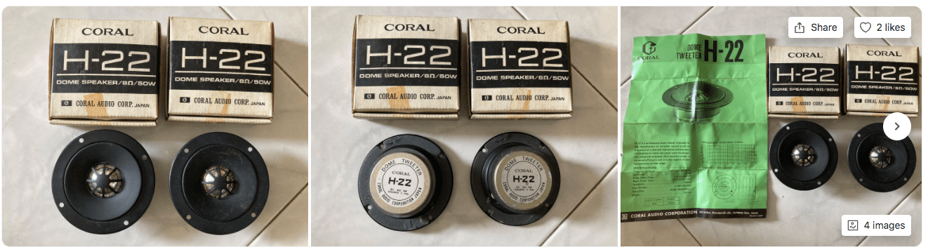

The best metal domes are ever heard are a blast from the past. About 40 years ago, Coral had the H-22. When comparing it with the Philips and other soft domes of the time, hands down they were nicer. Problem was they were 3 times the price. Rarely see them anymore.

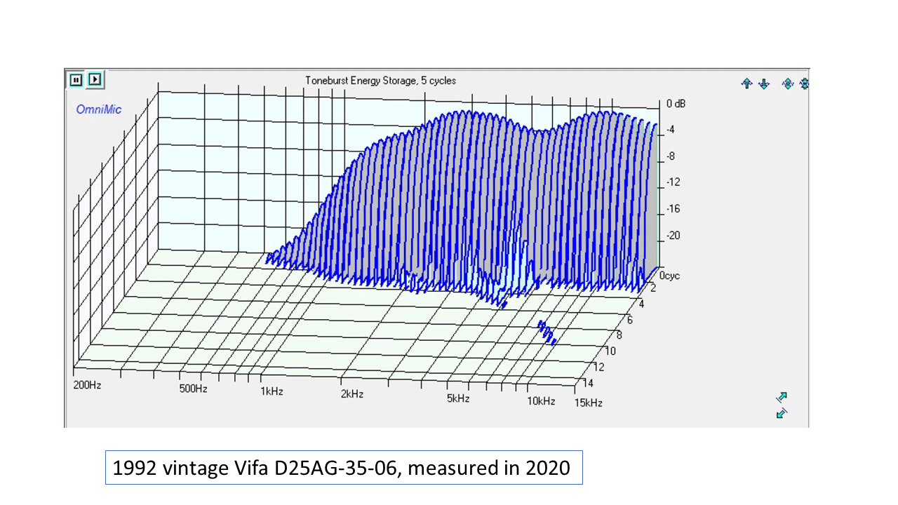

For old time‘s sake, the Vifa datasheet in 1992 included a CSD plot. Some disturbance for sure, but pretty clean (way better than the newer D27 soft dome).

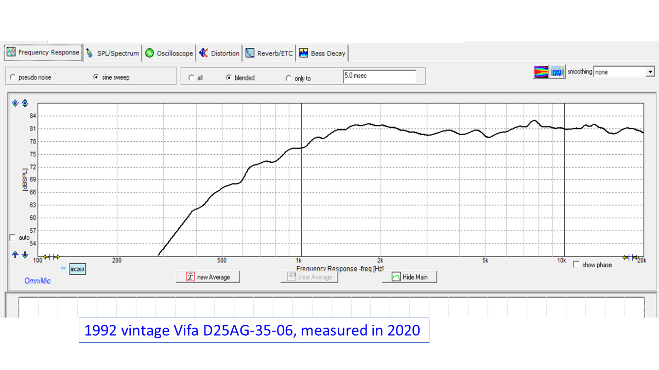

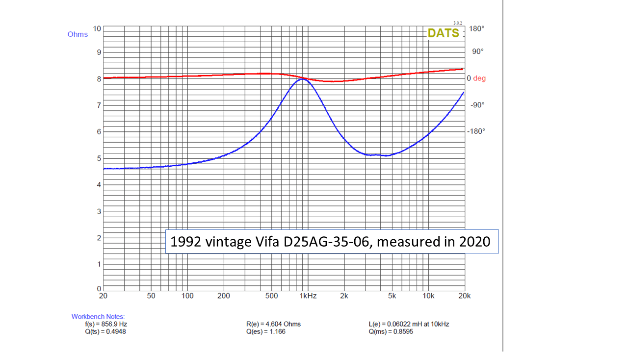

Here are some measurements I took in 2020. Regarding the toneburst, I have no idea why I plotted only to 15 kHz. It was probably not intentional, just an oversight. The frequency response was taken in a foam-board mockup box similar in shape to post #11. Based on these measurements (and the harmonic distortion results), I decided to re-use this tweeter.
Not bad performance from a tweeter which had been in daily use for 28 years ! The 3-way system was the main sound system for my household audio-visual-TV-music needs.

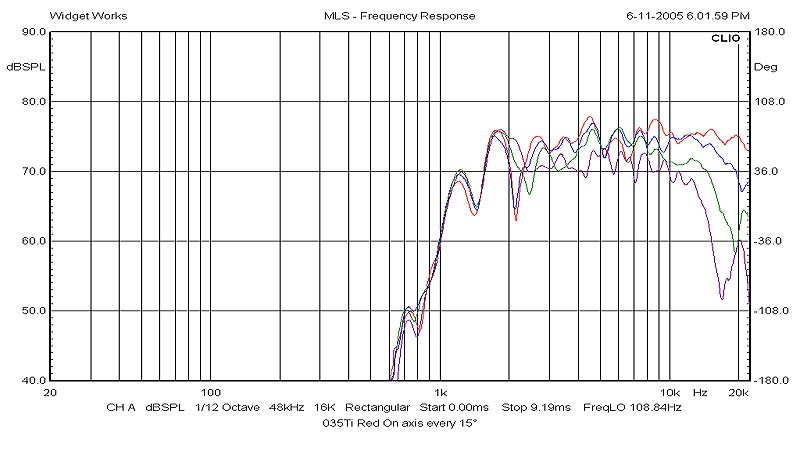

I have always liked the 035ti in my car, am still using a pair from 1988 or so.
In the car they will be used around 60 degrees off from normal axis, giving a similar output curve to those Coral H-22s when used that way.
(Image borrowed from the jbl forum.)
