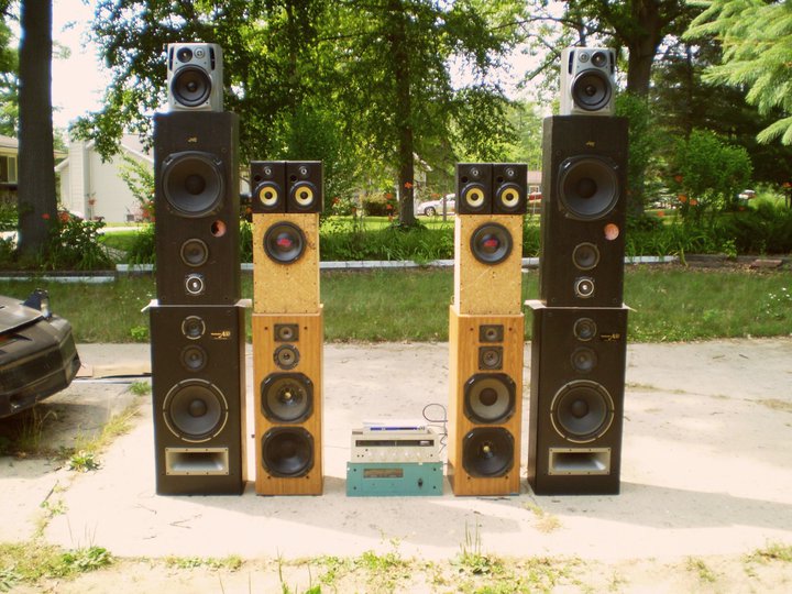

For one more tested example, My stack of loudspeakers can produce about 119db SPL standing in front of them (approx. 1m), and back at my listening area (approx. 14ft to 16ft away) I measure about 109db SPL with my meter.
It takes every thing my 1000watt Ashely FTX2000 can muster up to push those 8 cabinets to such levels!!!
