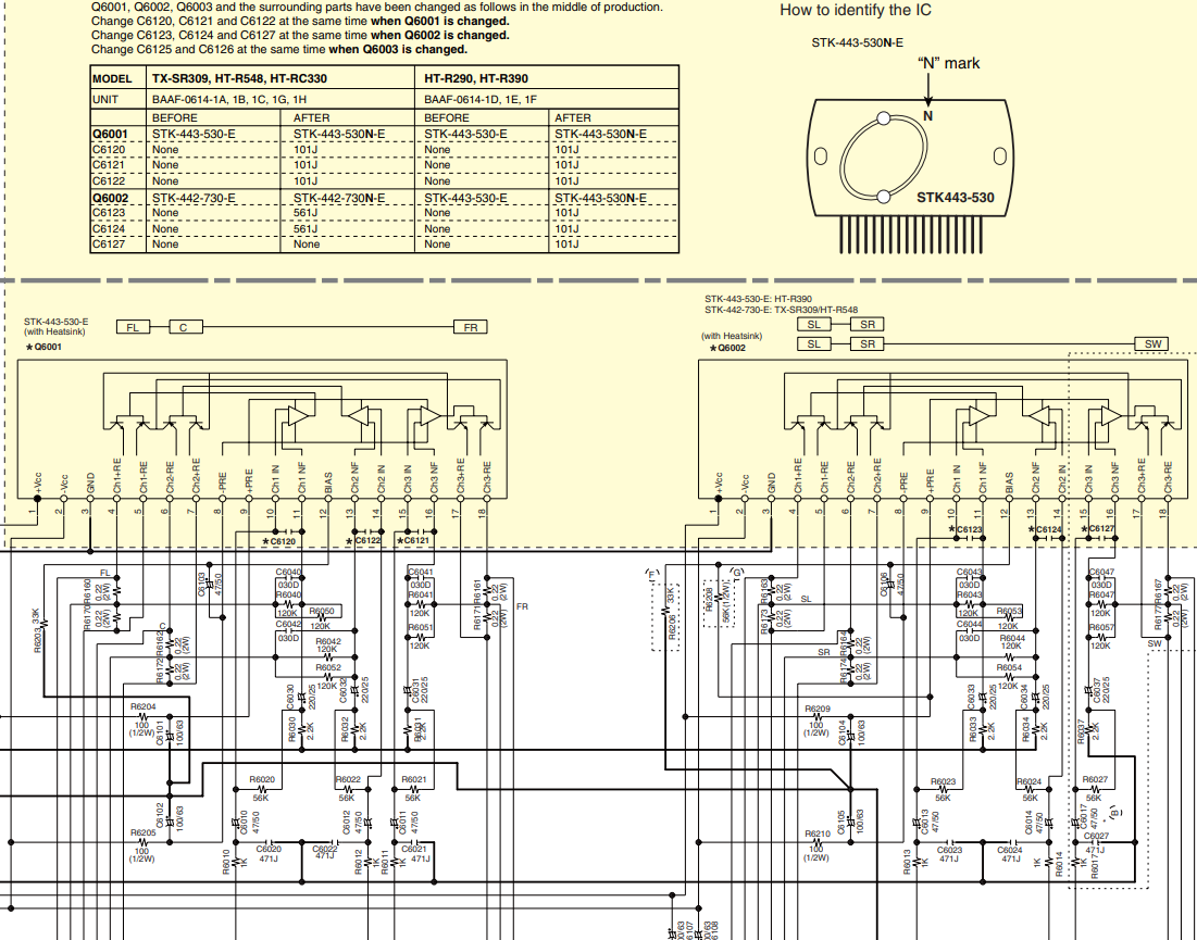

Assuming an appropriate rail voltage can you make a balanced power amplifier using a pair of class AB power amplifiers?
For example, I have an STK443-530 removed from a recycled chassis. If I am interested running some experiments can this be tried? Aside from the load currents and SOA issues the amplifiers don't really "know" that this experiment is being tried, right? (The two balanced signals fed to the left and right channels.)

The usual term for this is Bridged operation, or Bridge Tied Load.
As you note, each amplifier will see only half the impedance of the load, which means that if the amplifiers are suitable for low impedance loads, you can get maybe 4x as much power into the load for a given power supply voltage.
According to the datasheet, the load is 8 ohms. Can you use a 16 ohm load (Bridging)?

You will need amplifier halves that are stable at half the impedance of your actual load. Reducing the supply voltage is not sufficient and will not bring back the lost damping factor.
If your load is 8R, you will NEED amplifier halves rated for 4R single-ended operation otherwise it may be unstable, and it will definitely get hotter even with reduced supply voltage.

The Onkyo TX-SR504 has a damping factor of 60 at 8 Ohms 1 kHz.
The Yamaha HTR-5940 has a damping factor of 120 or more 20 Hz to 20 kHz 8 Ohms.
The particular receiver with the Sanyo STK443-530 has a damping factor of 60 at 8 Ohms 1 kHz.
So perhaps the Yamaha is the best bet to try this experiment. Right now I don't want to try modifying gain and stability to raise the damping factor.
