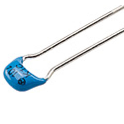

can you identify this capacitor ?
HI looking for the same blue cap as in the pic 120pf its out of a Marantz (pm66 KI)
the standard pm66 its a film cap.
is it a polystyrene cap? it looks like one inside
the original one burst open!
both output transistors and a 330r 2w resistor was blown on one channel
Axial is not a good fit for the pin pitch. It looks like it might be 0.2", or 0.3"
You don't need 630V rating.
Look for much lower and the correct pin pitch. since 125V is quoted in the other post, try for 100V to 150V
MKP are available in 0.2" and 0.3" for these pF sizes.
These small caps are fitted across the pre-driver transistors, base to collector, of TO92 types 2SC2240 or 2SA970. They're there to shunt HF and RF from that gain stage, stabilizing and reducing the chances and severity of oscillation and RF breakthrough. There must have been some mighty oscillation in that channel or an accidental Mains short to cause that damage and I assume most of the transistors were toast.
They are stated in the KI version manual (rated 120V) as different to those in the SE version (rated 100V). I can't imagine there would be any real difference as the film thickness would not be altered for such a minor rating difference.

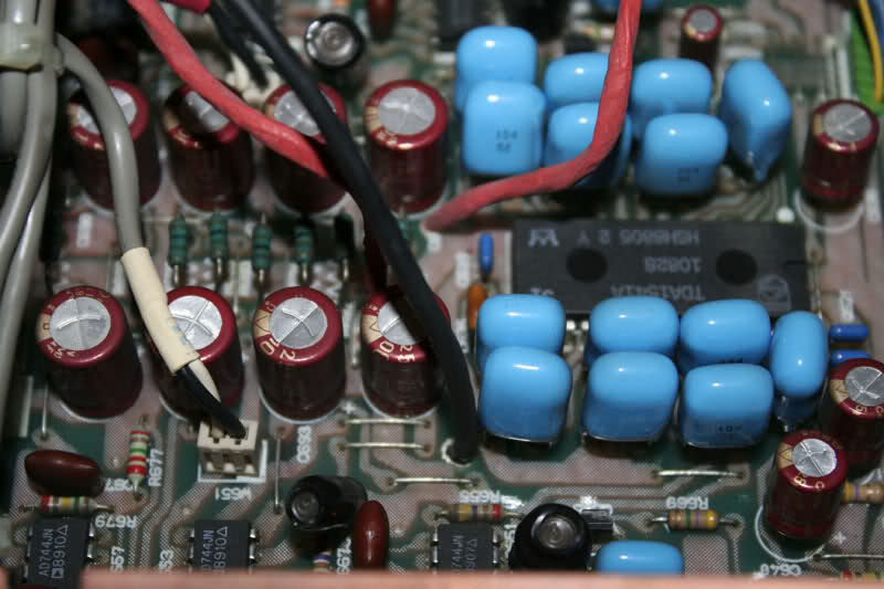

Looks like a Sibatit capacitor.
Only that would make it a multilayer cap.
like this one:
....I don't know if terephthalate (FKT) is available with foil.
There is always some obscure example of every possible plastic film and metal foil combination. I haven't seen the type code FKT used though. This is Cornell-Dubilier type DMT.
http://www.chambersamps.com/custom-built-amplifiers.html
Note: these guys supply the caps for "vintage tone" in guitar amps so you get the picture of what their audio qualities may be. Have a look at the other types in the brochure.
Broadly, Polyester caps of all types are used in DC applications while polypropylene types are kept for AC and pulse applications. Polyprop. has quite a bit lower DF than polyester and as Douglas Self points out, makes a much better audio cap if size isn't a problem.
I have replaced all 4 output transistors, both reservoir caps,330r 2w resistor, and replaced the blue 120pf cap with a small ceramic disc and all is well and sounds very good indeed
will it be ok with the ceramic cap or should I go with polystyrene or film ?
Tanatlum caps do have a nasty habit of exploding, but I don't think they make them that small. Fractional uF maybe, but not pF.
The only things that would cause film caps to explode are severe overvoltage or overheating. You'd never get enough current through that cap to overheat it - even if the amp were oscillating. In a 1kW RF transmitter, maybe. So it was probably just defective. Mica or high voltage ceramics can be used in that duty. Micas are a little lossy, but that will only help the stability concern. Z5U's are nonlinear wrt voltage, but the nonlinearity in a 500V cap at 125V will be far lower than the nonlinarity in the Cob of the transistor it parallels.
How many times do I have to type this, it's a BC Components KP capacitor.
Polypropylene film +foil.
Ken Ishiwata is a bling stylist !
They've been used in fancy Marantz + Philips CD/DAC gear since the late 1980s.
