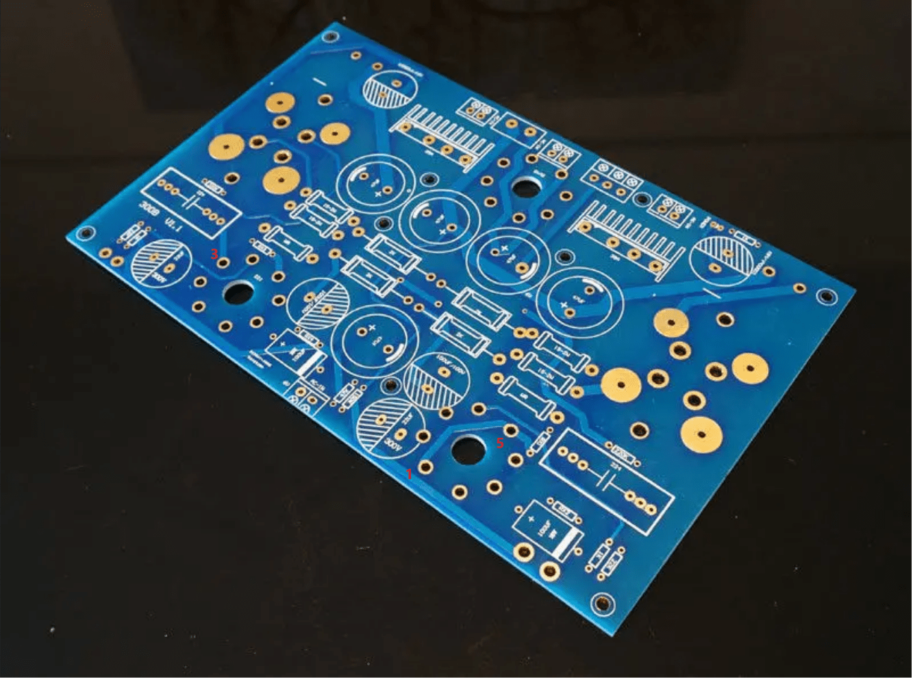

I thought it would be something like a 6V6.....You only need an added gain of x5 or so for your 300b which points to a low Ri driver with plenty of current and grunt, like a 6AH4 or a 6V6 in triode. That kind of thing.
But that Chinese PCB shows 2x 6SN7 like the Sun Audio design, which Stephe has shown to be pretty useless. Unfortunately if you use
a PCB like the one shown it makes it hard to modify and improve. Better to start again point to point and use a proper driver tube.
I am trying to understand if that PCB has merit or not. Because I have not seen 1/2 of a 6SN7 AC coupled into the other half using some kind of slingshot method before. It may sound terrible, but I doubt it's entirely nonfunctional.

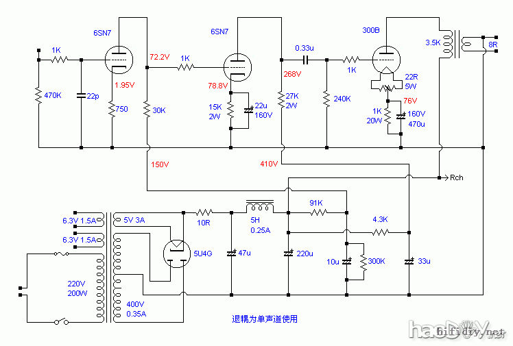

I figured in China they call this 6SN7/300B arrangement, the J configuration. It appears to be the dominant and preferred arrangement in their DIY audio community.
But in the schematic I posted, the first half of a 6SN7 is AC coupled to the second half, most likely to provide more drive for the 300B, without another stage and tube.
That appears to be a copy of the J.C. Morrison circuit from Sound Practices way back when. They deleted L1 & there are a couple of subtle changes.
Not quite, DC coupling here
If you're talking about the schematic in your first post, there is no "second half" of the 6SN7, it's a 6V6. This is all becoming very confused.I figured in China they call this 6SN7/300B arrangement, the J configuration. It appears to be the dominant and preferred arrangement in their DIY audio community. But in the schematic I posted, the first half of a 6SN7 is AC coupled to the second half, most likely to provide more drive for the 300B, without another stage and tube.

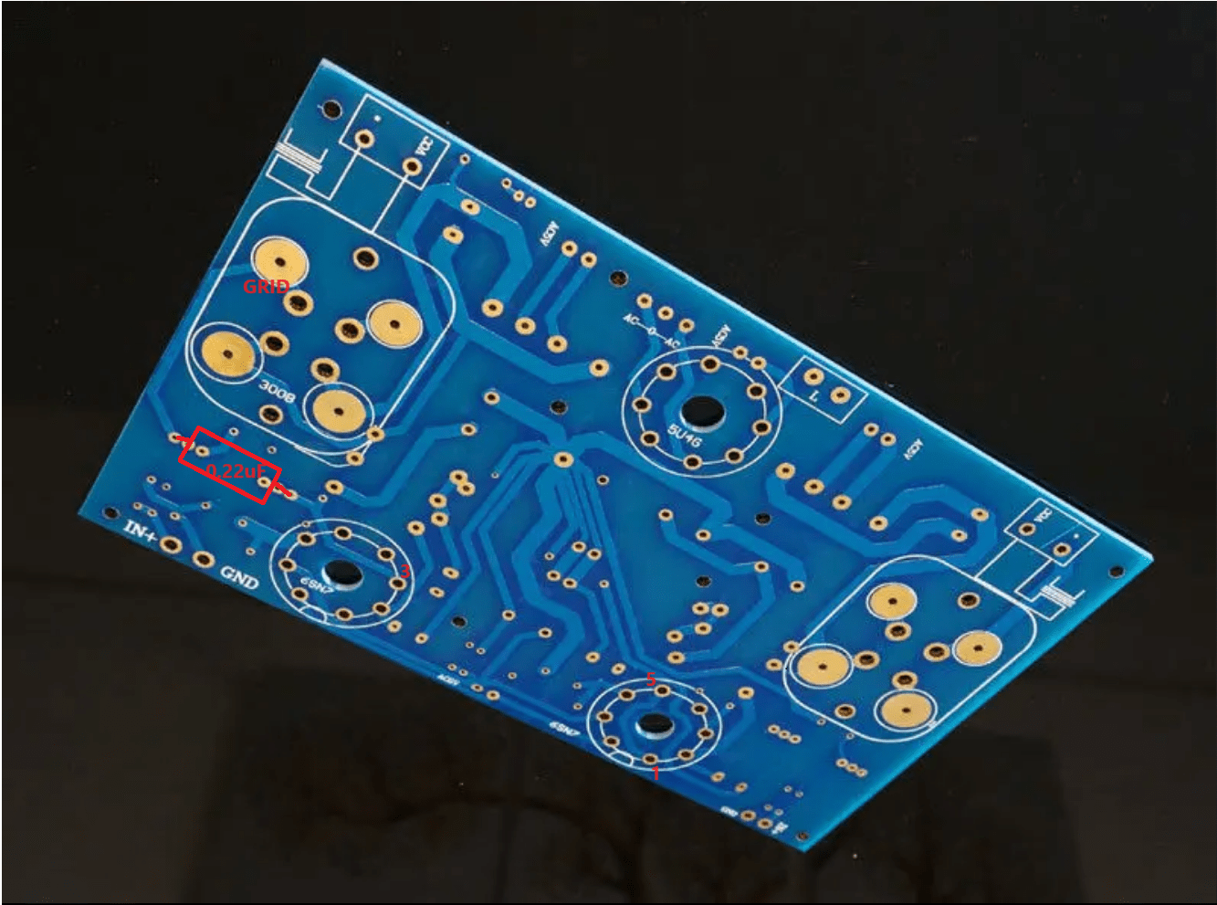

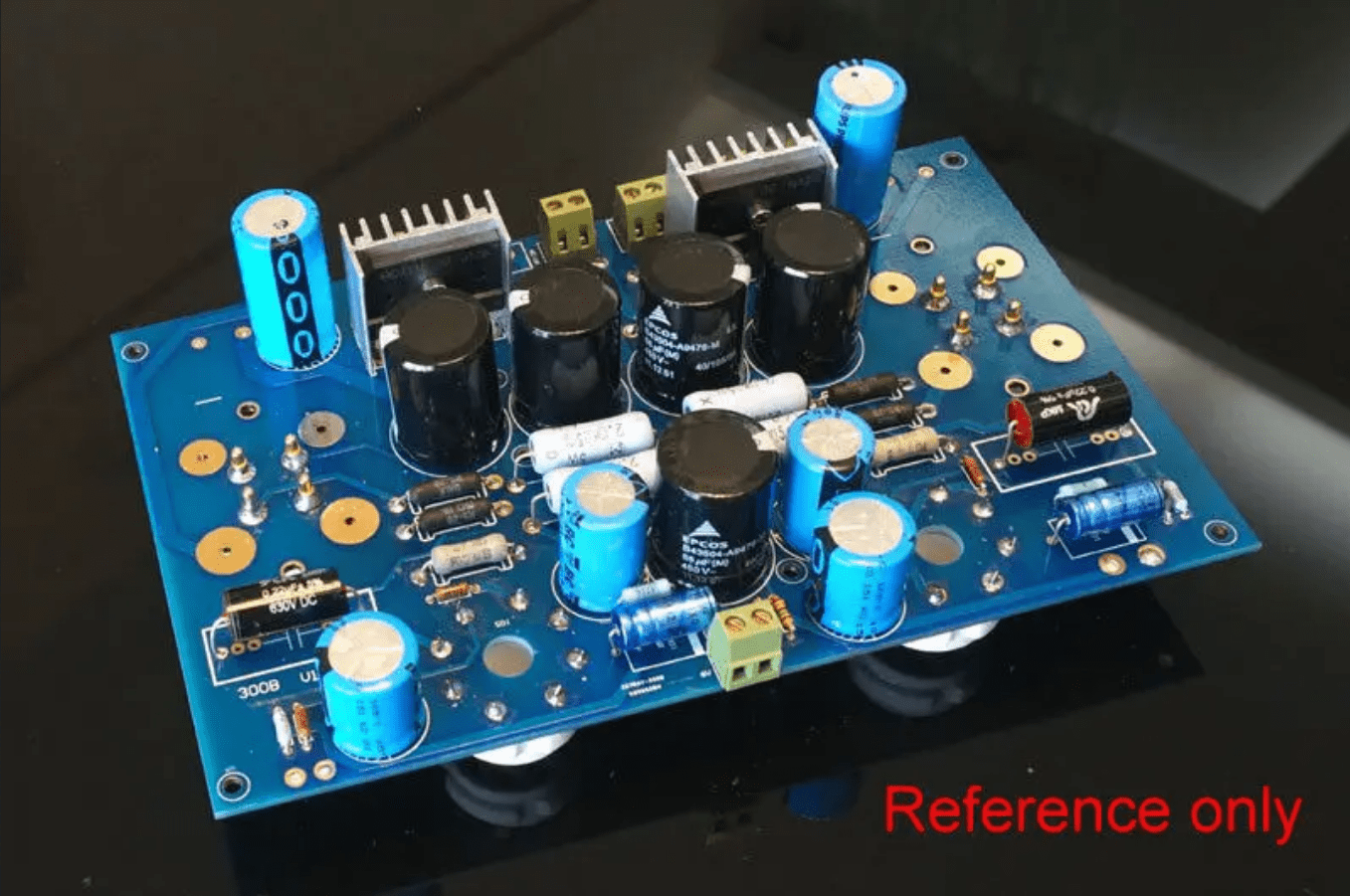

@andyjevans Confusing indeed, there are like 3 different schematics, and PCB pictures that are not clear to which schematic they conform to.
PS I think #27 is the right schematic, but not 100% sure. Tried to follow PCB routes, but no clear photos of both sides.
Yes, based on the images, post #27 indeed is the correct schematic, you can clearly see 6SN7 pin 1 directly linked to pin 5, and pin 3 go to 300B grid via a 0.22uF capacitor.

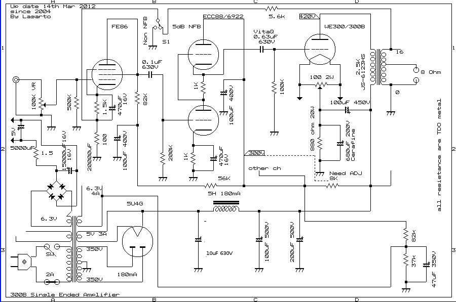

My BS meter just went off. 😉 Here's a schem. form this Japanese site: http://www.single-ended.com/we300bjames.htmSo, this arrangement seems to have no precedent outside China. That’s pretty rare.
Indeed.
Do you mean an SRPP driving a 300B? Cary, Wavelength and other 300B amps use (or used) an SRPP to drive a 300B. Gordon Rankin's Bugle is an SRPP design, so is the Baby Ongaku. It's a very common circuit.
That's it exactly. Recycled a zillion times in all kinds of amps by Chinese designers, both single ended and push pull.
