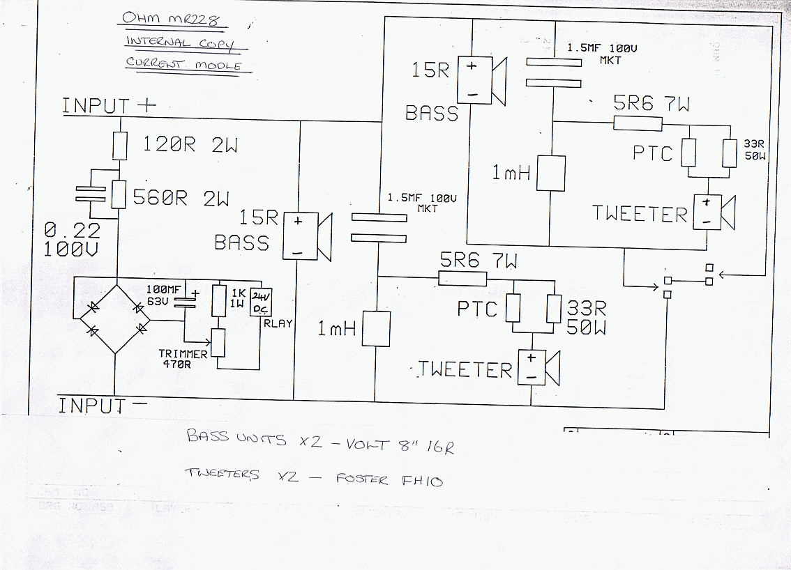

I'm repairing the passive crossover in a PA speaker. Comparing it with
an identical second speaker I own, it seems there's a pair of
components that are missing. In fact, judging from the state of the
PCB track, I'd say they were never installed in the first place
They?? Well each speaker has 2 woofers and 2 tweeters, and the signal
is divided between them thru 2 identical crossovers (on the same
board). I've taken the liberty of attaching a pic of the circuit
forwarded by the manufacturers. The missing components are labelled
PTC, and are in a parallel with the 33R resistors on the way out to
the tweeters.
Why doesn't the company help? Because the speakers are obsolete, and
the guy who designed the crossover no longer works there.

Can you help? Is this component a capacitor? A capacitor makes sense
to me in a crossover - it's allowing only the highest frequencies to
bypass that 33R resistor, and its absence would result in the duller
sound I've noticed. If a capacitor, is it 95pF? And is it really a PTR
device? Is the capacitance value affected by temperature? The harder it works, the hotter it gets, and the more low frequencies are filtered out.
Any theories gratefully received.

A PTC is a protective device, and might just be a thermistor with a strong positive temperature coefficient where the resistance increases rapidly as it heats up. The other possibility is it is a polyfuse which is a resistive protective device that initially exhibits a low resistance, and if the current through it becomes excessive it heats up and becomes an open circuit - once it cools off it resets.
Definitely not a capacitor, and if this speaker sounds dull it is probably because a cold PTC exhibits pretty low resistance and without it the 33 ohm resistor strongly attenuates the highs. I suspect they should have been installed and were forgotten.. Measure the ones in the other cabinet to determine their cold resistance, and get something that matches.

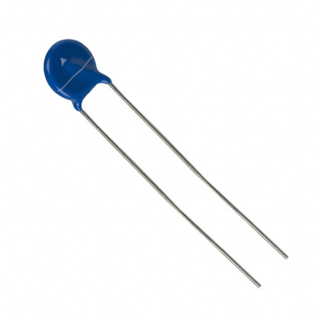

Overvoltage protector
The blue disks with the S on them with the two slashes are overvoltage protectors. I'm familiar with the S07's that come in PCAT power supplies on the AC input, and the S15's (15 mm) that come on the 480V inputs to 3 phase variable frequency drives. PTCR is one description, but I thought they had a binder and metal powder that shorted over through the binder if the voltage got too high. Blue is the american manufacturer, green is epcos or some chinese co. See the picture, I got this from newark or mouser.com. You might get a hit on the part number from newark or mouser. I agree they are tweeter protectors against amp oscillation. I've lost two speakers to blown tweeters that can't be bought- ST70's aren't known to oscillate, but ???? If the manufacturer ran out of these one day, the customer's amp might blow up the tweeter- I can see the production manager saying "surely the service department can find a way to deny the repair under warrentee if the customer's amp blows this. Ship em".
I uploaded a .jpg picture but it only shows when I complain about it not showing up. shows as attached. ?

PTC tweeter protection is not rare. Not protecting against RF oscillation, it is just a way to prevent people from blowing the tweeters out with excess treble. How many times have I seen the "smiley face" curve on graphic EQs? That +12db at 10kHz is doing tweeters no favors.
Indiana likes Peavey examples, so look up their "Soundguard" as used in any number of PA speakers. The tiny disc in those is a "polyswitch."
Hello,
Now that the missing PTC is identified take a look at the 33R resistor. I bet that it is not 33R but something much lower in value. If you install the missing PTC you may also need to replace the resistor that operates in parallel.
My guess is that the PTC was found to give unreliable results from one speaker box to the next and between warm days and cold days.
DT
All just for fun!
Dual, I don't think you are looking at the big picture. The 33 ohm resistor is there to provide a reduced signal to the tweeter WHEN the PTC opens. Normally the PTC carries the tweeter cirrent. Only when the current gets excessive does the PTC open up. Instead of just killing the tweeter signal entirely, the 33 ohm resistor is left there to allow the tweeter to continue, but at reduced volume.
