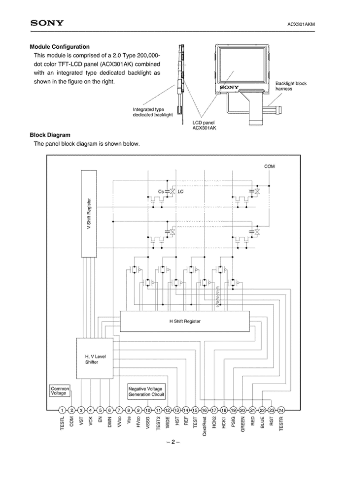

hi folks
i own a 2,5" sony lcd tft monitor
i finally found the diagram(i hope it's the good one)
the connector has 24 points
general voltage,ground,r,g,b....
do i need to connect all the points or just the alim and rgb ?
i know the resolution is not the best one but it'll help me to begin in diy proj.
i join the jpg file
bye and thanx to you all
