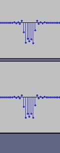

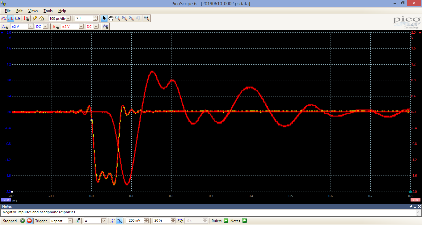

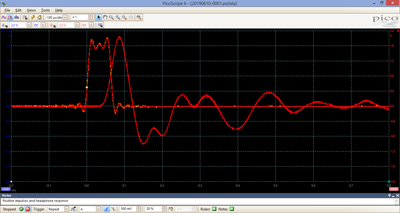

Being curious, I have resampled the test files to 44.1kHz. It is then, to me, more difficult to hear the difference, but still I got a 7/8 result, however with more concentration and longer listening time. After resampling, the rising and falling edges are of course slowed down, because 44.1 kHz sampling is unable to keep original impulse rise time of some 10us. It seems that the rise time, or high frequency content of the impulse speaking in frequency domain, makes a difference in audibility of the impulse polarity. Same applies to headphones. It is easier to hear a difference with headphones that have shorter rise time of the acoustical output impulse.
