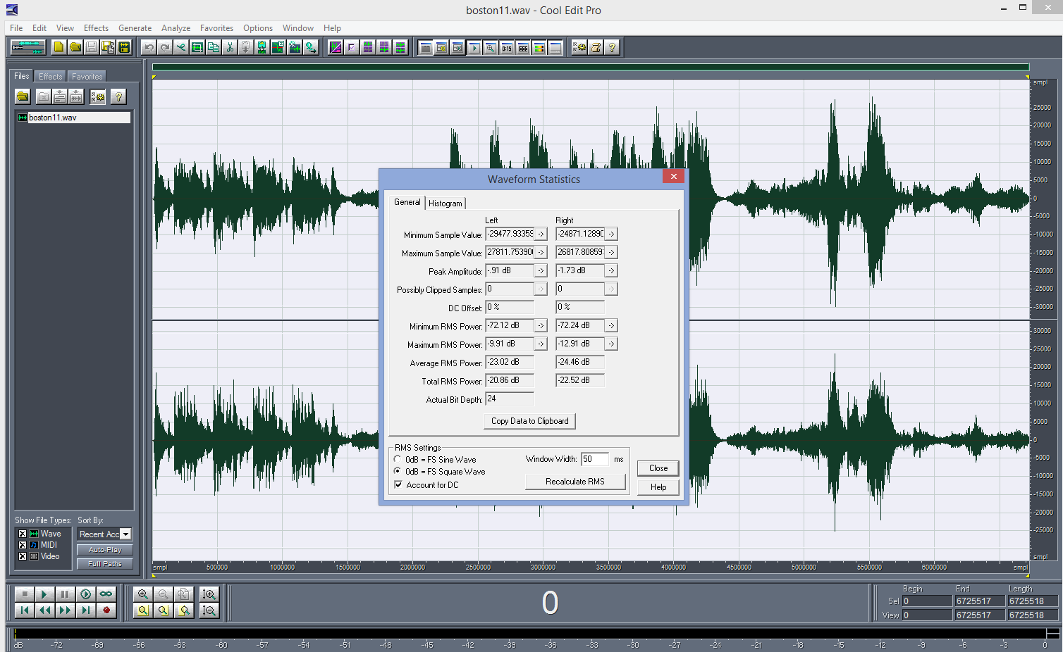

Interesting comment, and yes, I am going to disclose it.
Both samples were recorded with
Audio Buffer in english
the version described at the bottom of the page, with output series resistor R10 = 50ohm.
The differences:
1) Boston11 has TL061 in the left channel and OP27 in the right channel.
2) Boston22 has AD744 in both channels.
The channel with TL061 is about 6dB noisier than the channels with OP27 and AD744. The OP27 channel almost does not differ from the AD744 channels. Integral values of samples in all channels do not differ (peak, avg etc.), we may say they are identical. Direct subtraction shows difference between TL061 and AD744 channels, maybe a slightly longer delay of TL061 (due to its lower GBW) is reponsible for it. The difference in delay of TL061 vs. AD744 is only about 200ns.
