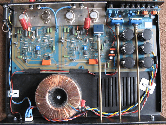

Has anyone measured this thing’s supply voltage? My guess says it’s 40-ish rails. Can’t read what it says on the caps.
Thank you all for the comments. Interesting. If I can sum it up so far would I be correct in saying the design is a/outdated mostly because of the output devices which may become unobtainable and are rather slow, b/ is 'under sinked' (depending on rail voltage which can't be ascertained from the pictures), the transformer is too close to sensitive circuit c/it uses decent switch gear.
If memory serves well, the amplifier has a big, bold 'out of speaker' sound with average definition and perhaps below average focus. This extended to bass (but was probably held in check by the IB design speakers I've used at the time). Perhaps that makes sense from the points mentioned in this thread. I loved the slim line look and face plate of the amplifier but from the comments but also realise that is probably not a good solution because of the limited heat sinking though I never had known issues whilst using it, even at fairly elevated levels.

I'd still like to know if the designer of the amp made provisions for easy repair. As someone who designs and builds things for a living, I'm always curious of how things are built and how they can be repaired if need be.
Looks like the heatsink is on top of the circuit board and there are two large diameter cables threaded though it, there may need to be a lot of disassembly to simply repair it unless there is an access panel under the circuit board.
