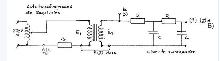

Not only tranfer impedande. Considering it as a "black box", making two test you can get all the parameters of a transformer.
One of them is the open secondary test. Leaving the secondary open (only a voltmeter) and giving the primary full rated voltage at rated frequency, you can get voltage ratio(s), magnetizing current (from its value you can obtain core loses, primary inductance, etc.). In general, magnetic loses.
Maintaining the secondary shortcircuited with a proper ammeter as only load and increasing the primary voltage from zero to such a value so that the secondary current is the full rated current, you obtain copper loses, leakage inductance, etc. In general, copper related looses.
This is how large power transformers and ac and dc motors are evaluated without wasting full power in them (Motors are considered as transformers, testing them with the shaft free or blocked). In all cases, only a few percentage of the full rated power is needed in the laboratory. We made such a tests in the university at a cathedra called "Máquinas Eléctricas I & II" (Electric Machines) when I studied at UTN the past century, with a profe called Paolillo.

If you can see the wires; you can then roughly estimate currents having in mind current densities from 2 to 4A/m^2. Thus, having the core at your eyes, you can also estimate power capability. Putting some low voltage in one winding you can measure voltages in others.
Full voltage can be measured having an oscilloscope. Measuring in it primary current integrated through a low pass filter (integral of primary current) and output voltage, the BH loop can be saw (now in doubt if integrating primary current or secondary voltage but one of the is surely). Increasing primary voltage until saturation starts to occur looking o'scope pattern, give you the primary voltage. Also the temperature takes into account. Proper evaluation of several of this parameter give you a crude approximation. Thus, with the test in my previous post finishes.

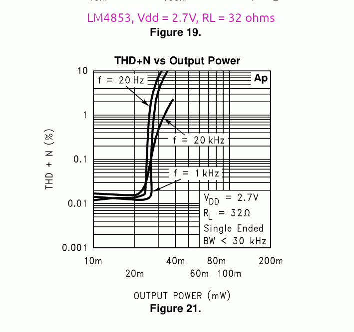

I found a little Sparkfun eval board for the LM4853 audio power amplifier at Digikey that looked perfect. The chip is stereo, has absurdly low distortion, is tiny, and even comes with a stereo volume pot and on-off power switch: https://www.digikey.ca/en/products/detail/sparkfun-electronics/DEV-14475/8702489
At first glance, output power specs for the Sparkfun "Noisy Cricket" (datasheet from Digikey link above) are dangerously excessive, quoting 1.5 watts RMS output power, which is enough to permanently destroy your hearing in an instant if you use headphones.
Fortunately that turned out to be mostly advertising hyperbole. When I dug into the actual LM4853 datasheet, I found that the chip was rated for operation on as little as 2.7 volts DC, and would deliver about 25 mW maximum output power to a 32 ohm load in this case.
25 mW is enough for 114 dB SPL using headphones with a sensitivity of 100 dB/mW. That's already dangerously high, but maybe acceptable, if used with care. At least you won't go permanently deaf if a bad cable causes a loud pop.

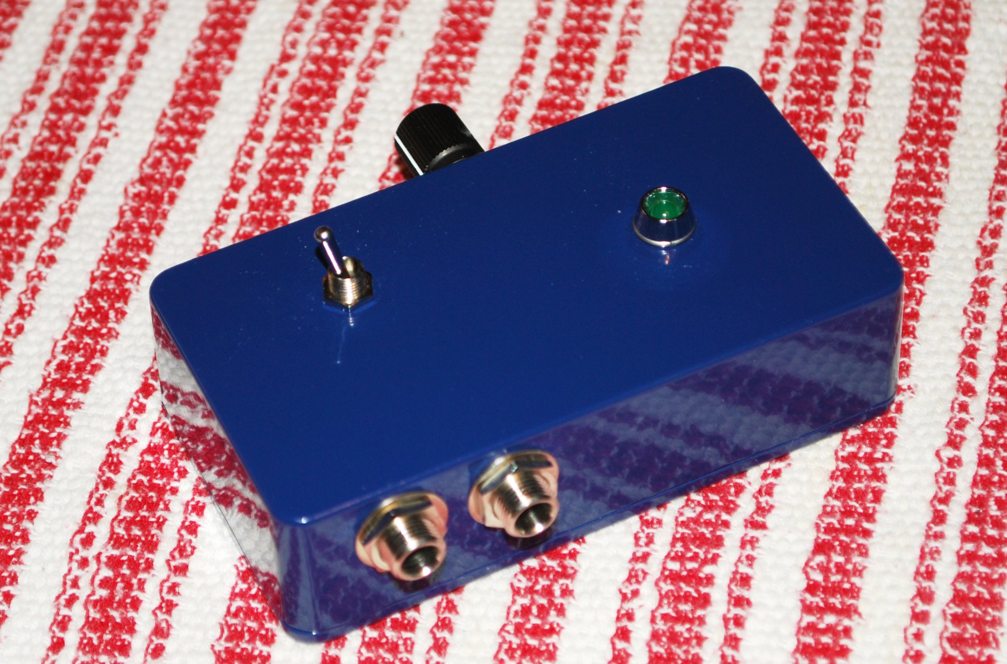

I built the little Noisy Cricket board into a little Hammond die-cast enclosure the size of a small guitar FX pedal, and used another little eval board (a fingernail-sized adjustable DC-DC convertor from Robotshop) to drop the usual 9V pedal power supply down to about 2.4 volts, which was as low as it would go. The LM4853 seemed happy to operate at this voltage, and might work at even lower voltage for additional safety (to your ears!).
Power levels are so low that a tiny little linear (not switching) voltage regulator would have done the job just as well. Maybe better, as there wouldn't be any switching noise. But the little switch-mode eval board works fine, and I can't hear any noise at all in the headphones.
You can see the left and right input jacks in the photo, as well as the mono/stereo toggle switch (it provides the same input signal to both channels if flipped to the mono position, which lets you drive the headphone amp from a mono source, and still hear sound in both ears.) The 1/8" stereo output jack is on the other side of the case.
