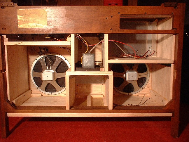

In my RCA console restoration and modifications, I didn't want the thin side walls vibrating, because it made the bass obviously "boomy", adding a certain flavor to what the woofers sent out to my ears.
The 1/4 inch plywood with veneer when tapped, made a sound like a drum.
I didn't want the cabinet to make any contributions to the resulting tone quality that the speakers emitted.
Installing 3/4 inch pine glued on the insides, along with internal panels used for separation and component mounting, gave the whole cabinet a rock-solid, non-vibrating and non-boomy nature, which is what I wanted.
Now, tapping on the sides, it makes a "click" type of noise, well above the bassy-thump of before.
Even the front speaker baffle, now reinforced with 3/4 inch pine, is more or less "soundproof", being coupled to the inner panels.
The original style 12 inch woofers here were later replaced with a pair of high-compliance versions with massive ceramic magnets - the rear panels (not shown here) also have a slot for tuning, and the resulting effect is very very pleasing with all types of music - tight bass, deep, non-fatiguing. - Certainly not boomy.
Additionally, any "one note" bass at the resonance frequency of the woofers is thwarted by the non-identical sizing of each chamber.
