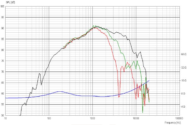

Can we talk about the ScanSpeak 3" Dome?
It is a weird driver, gotta make your own chamber for it, seems like off axis breaks away really early at like 1.5khz?
I wouldn't pair it with a big faceplate tweeter or as high of a xover point. I'd pick a smaller overall sized tweeter to get it closer to the dome. All in all this is probably the last dome I would buy if I were making a three way with a dome mid. I'm mostly just baffled it doesn't come with it's own chamber.
It's like it has built-in 1200 Hz 1st order lowpass and highpass, like a filler driver for a 70's linear phase speaker.

@Bmsluite Those fillament characteristics aren't going to be an issue if you choose the correct densities and geometry/shape of the chamber. We're talking about a small diameter, less than 4 inches and a wall thickness of about 1/4 inch. You can put a few hundred pounds on top of an average grade PLA printed chamber and it would survive just fine. I haven't noticed any noteworthy ringing with even thinner wall PLA printed chambers I've done on similar sized drivers. If you look at the older Vifa, Seas and Peerless drivers, they all had much thinner, more resonant chambers and although they were on the skimpy side, they didn't cause any significant issues with driver FR or THD. Erring on the side of caution, I'd always choose fiber loaded ABS, as it has a proven track record.
As far as the chamber geometry goes, a properly dampened circular chamber won't be a problem. Seas and Audax use a toroidal terminated chamber which deals with the majority of standing wave issue with the mean diameter WL being suppressed via the interrupted primary diameter. It also forms a short TL with this shape. All of the tweeters and mids using a similar shape of chamber have zero issues with standing waves or resonances, given the dampening media is suitable for the bandwidth of frequencies radiated from the back of the diaphragm. An excellent example of the toroidal chamber is the Seas T35-C002, which happens to be dampened with only a rolled up piece of wool felt. The Audax TW025A28 is another tweeter with this shape of chamber and has ZERO dampening media, yet its one of the finest 25mm metal domes I've listened to. Same goes for the T35-C002.
You're welcome to experiment with elaborate shapes of chambees on the D7608, but i can save you the hassle after having been there and done that myself. There's no significant benefit to using a TL shaped chamber on this mid. You alsp don't want it larger than 500 ml, otherwise you sacrifice lower mid output and sensitivity (what you're trying to preserve to begin with on a driver with 1mm p-p xmax).
I sincerely can appreciate your engineering skills, but I can honestly say I've tried all of the common tricks available on the D7608 rear chamber design, including tapered TLs. You're of course welcome to try yourself but I'm just being upfront, saying it won't yield anything ground breaking in trying to extract anymore performance from the D7608.

I know alot of people wonder why SS didn't include a chamber for the D7608. One of the main reasons was the driver being employed in some OEM designs. These had their own proprietary chambers, some of which integrated with the main enclosure.
Another reason for not including a chamber with the D7608 was how SS designed the mounting flange. This also required access to the rear motor for integration into the enclosure and mounting the driver.
When the D7608 came out under a different part number, there were 2 different versions with their own motor dampening applied. Having a detached chamber allowed tuning the mid for integration with different woofers along with their own baffle spacing and the consequential varying of acoustic centers.
