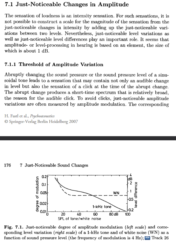

Back in the 1980s, many commercial speakers had attenuators for tweeters; some also had attenuators for midranges. There were many attenuation levels. One of the interesting points is +/- 1.5 dB. I’ve read somewhere that human ears begin to hear a difference in sound level at about +/- 3 dB. Yet, why do many manufacturers put +/- 1.5 dB on their attenuators? Or, actually, the +/-3 dB was discovered after the 1980s era? Anyone who has experience with the 80s speakers or has knowledge about this, could you please confirm the fact about +/- 1.5 dB or +/- 3 dB?

There is two things mixed: absolute level ( spl) and modification of tonal behavior.
If you talk about absolute level ( and without reference you can quickly switch for comparison purpose) then it can be difficult to hear 3db difference for untrained listeners.
If trained (and with a reference) you can hear way less variation though. In fact in double blind test comparison of same sample you'll favour the louder one by 0,1db but without being able to tell why. It's just it's more a feeling than something you'll choose on something you thought about.
One of the issue which make audio comparison difficults to do. If interested i could give audio examples ( but headphone listening will be mandatory).
Tonal behavior: we are more sensible to modification of tonal range. See Fletcher and Munson curves and notice it is related to 'absolute' Spl level too.
1 db variation with a high shelf eq centered around 3khz will be very audible as it is centered on a peak of sensitivity of our hearing system.
The same level variation over a much smaller area of the audio band ( depend of frequency too) might be unoticable.
That said with low Q ( wide range affected) you are able to feel very low variation in level, 0,5db with low Q shelf can be easily identified if you are trained or sensitive.

+/- 0.2 can be possible in the more sensitive parts of the spectrum, when applied to a balanced speaker. Unless I'm thinking of someone else, Siegfried Linkwitz has spoken about smaller variations than this.

1.5dB where and what?
  • As a small (EQ) band peak?
  • As a small (EQ) band dip?
  • A larger frequency range?
  • full-range?
  • full-range relative compared to something else?
  • Just an acoustic noise source?
  • Uncorrelated sound/noise sources?
I think we can make this list even longer.
For some of those on this list, the answer is yes.
For some others, the answer is no.
For some the answer is, it depends.
Reactions: 2 users

1.5dB is the attenuation of the tweeter.
Right, because your initial first post is pretty vague in the sense that it's unclear if you mean this as a general idea, or very specific.
For example, the ±3dB comes from general acoustics.
Which is very true, especially when acoustic sources are not correlated (random noise), it becomes pretty hard for the average human being to notice any difference.
However, for small frequency bands, especially peaks around the 700-3000Hz region, this is a very different story.
Even more so for a trained ear.
For attenuating a tweeter just about 1.5dB will give a every so slight perception of balance of the whole sound stage.
What I am still trying to say (also with the list of my previous post), is that it depends.
Even sometimes for a tweeter it depends on its range, directivity of the system etc etc.
But in general (again), yes 1.5dB can give a different perception of the whole system.
Also that can differ from surroundings and average sound pressure levels (loudness).

@b_force beat me to it. It depends on the bandwidth of the SPL deviation.
I use DSP, and so I can make small adjustments in all sorts of ways. IMO if I make even a 0.25dB adjustment of, say, the tweeter level I can tell that the tonal balance of the presentation has shifted slightly. The SPL change in this case is for all frequencies above 2kHz. OTOH, sometimes I do not bother to EQ a dip or even a peak if it is narrow. The ear is just not all that sensitive to higher-Q/low-bandwidth deviations. Of course this is just my opinion and I am talking about doing sighted tests where I know I have made the change.
