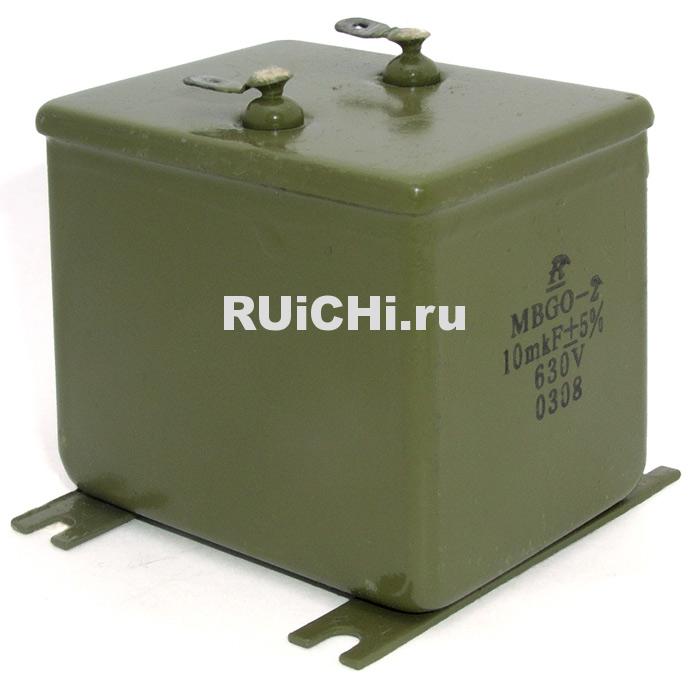

i think that's russian ÌÁÃÎ, i have some of them but they are not useful in audio aplicatins ? they were used in pasive crossovers , i have read somewhere that they are good as input caps but i dont think so.
old electronics is an bad idea i think:(

i think to use this in audio, esspecially in the audio input stage is the worst ideea which may have.
cannot use them as input caps. at least if you don't want that your amp to sound like !@#$%^.
just measure the capacitance between any terminal and case. you will see a high enough value. tents of nF and even uF for very large ones. if you connect the cap case to GND you will get a simple band-pass filter. the sound will be like telephone sound. if you leave-it unconnected, you will get a nice antenna on the input of the amp.
this caps are ment to be used in passive crossovers inside ancient loudspeakers, for shadded pole motors, power factor correction and some primitive industrial applications.
