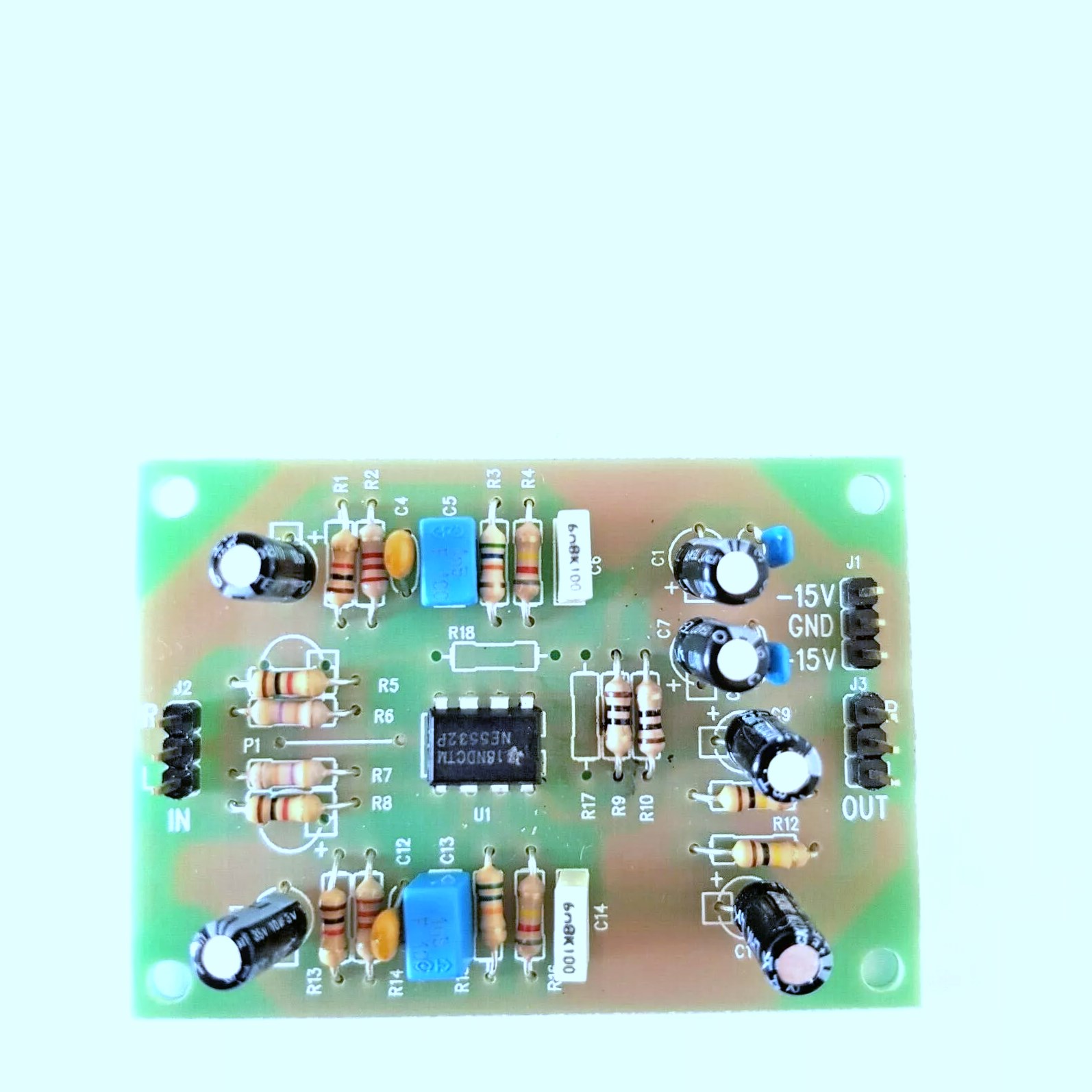

These were used in lots of popular quality electronics of the 1990s, like Denon, Yamaha and such, and maybe a little earlier (can't remember) and worked just fine. Today we would want something that plugs into the same 8-pin socket but has no significant bias current and maybe a little more speed. Everybody's hot for the 50MHz GBP stuff, but I have to wonder if the improvement is worth the practical (PS bypassing impedance and bandwidth requirements, surprising new stability issues from source impedance, circuit wiring demands, yada yada) penalties, for a phono stage.
In between are devices like the OPA 2134, etc. Are there compelling reasons for something "better"?
