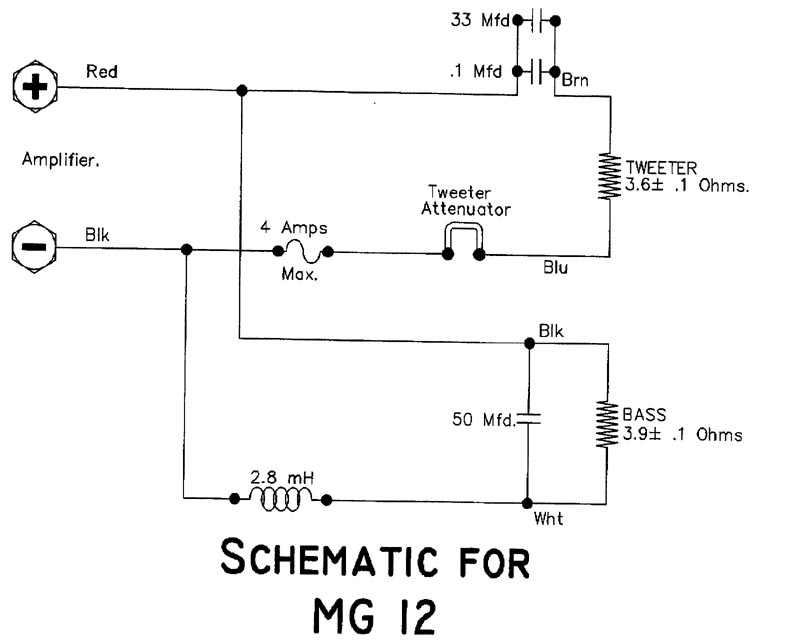

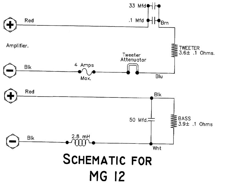

here is the schematic for a maggie mg12, which im thinking about getting. can it be bi-amped? (I plan on modifying the crossover anyway with better components).
oh ok. i just found stuff online that suggested only bi-wiring, but not amping... it called it passive bi-amping. i figured as much, but just wanted to check it out first. thanks!
