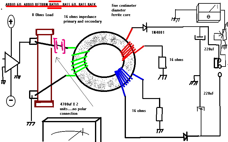

Can this circuit be usefull to audio amplifiers
I made some changes to make this circuit work in audio frequencies.... to measure errors related the output coupling impedance, some standing wave ratio meter to audio frequencies.
Do you think this can be helpfull to adjust some output filter.... a double zobel and a coil between them.... as a greek "P" letter network?

Solid state amplifiers have a very low output impedance (a fraction of an ohm) so measuring SWR is kinda moot. The only concern would be in a tube amp where when they say output Z is 4, 8 or 16 ohms, they *mean* it 😉
