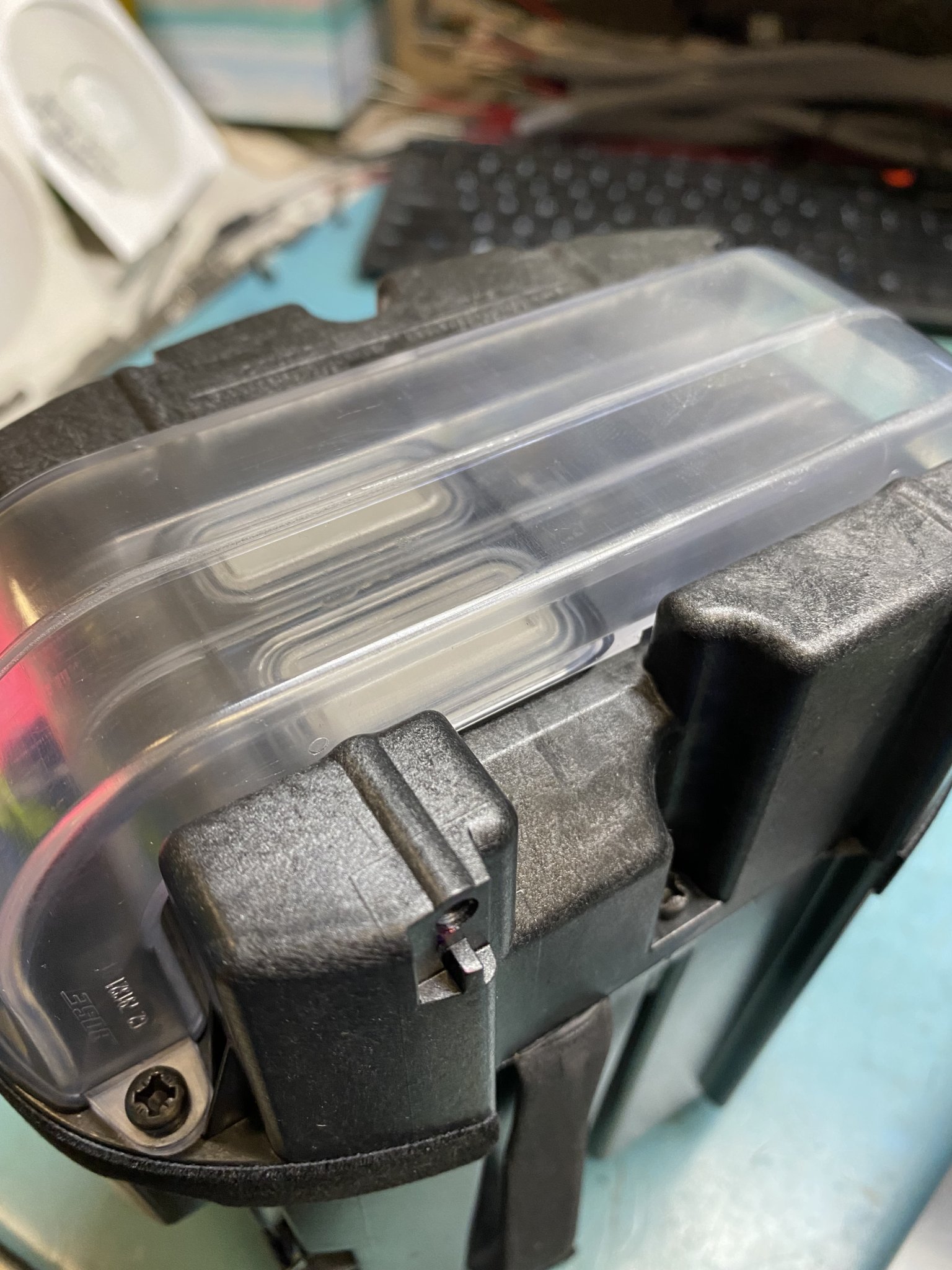

The patent explaines the concept. They basically use a long port to achieve a low tuning, then the restrictive vents cure issues with the port. This in conjunction with DSP helps their products produce adequate bass from small drivers. With the passive radiators, they can tailor them to give a nice low end and tame things with DSP.
Having active control allows a lot of leeway to sculpt to frequency response. Bose utilizes this pretty well. There are a few things I've mentioned to them to improve things a bit, but has fallen on def ears. I'm just their repair tech, not an engineer....what do I know.

No clue. Again, I'm not an engineer. I'm sure there's plenty of people on here that could spit that info out in a second. Seems pretty standard stuff, 1/2, 1/4 wave. As to how much and exactly where..? Probably some sorta modeling software somewhere that'd do it.
As for my improvements, they involve their proprietary investments, not at liberty to speak of.
Nothing particularly difficult to follow about it as far as I can see -either simulate or measure a prototype of the intended line, and at the acoustic length corresponding to your harmonic mode peaks, add said mildly damped vent. You'll probably lose a small amount of overall efficiency, but it should help damp those off.
