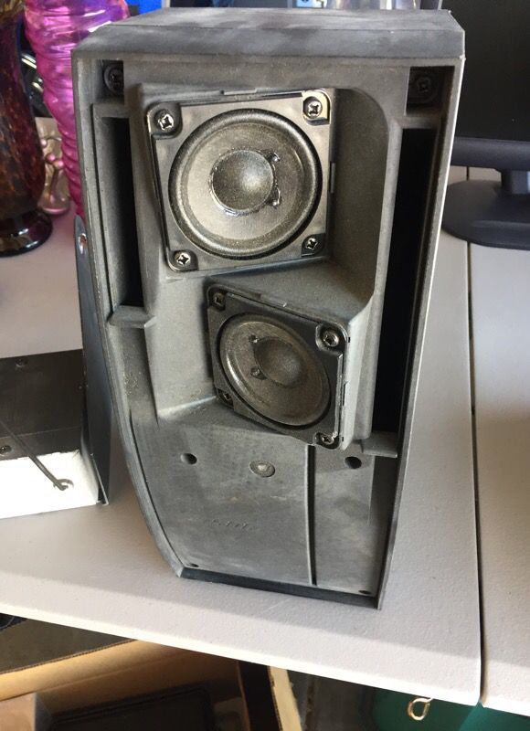

I was studying the design of the BOSE 302 . . .
Share the design with me if possible.
Do you mean the attached Bose 302?

Hot Rod 8” 2-Way PA/Studio Monitor
Art
