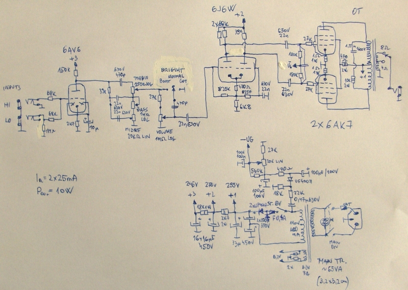

I made small Push-Pull guitar amplifier with pair 7AK7 in output: Ua=300V, Ug2=300V(Rg2=470 Ohms for each tube), Ug1=-25V (Set Ia0 to 2x25mA) and Raa=10 KOhms. Output power is >10W, and sound is close to amp with pair of 6V6 tubes.
Putting something like +12 Volts on g3 will square up the curves to be conventional pentode curves. Haven't tried this on the 7AK7, but on 6LE8 and other dual control tubes. Adjust the g3 voltage for minimum g2 current, but don't go too high on the g3 voltage or it will get hot instead.

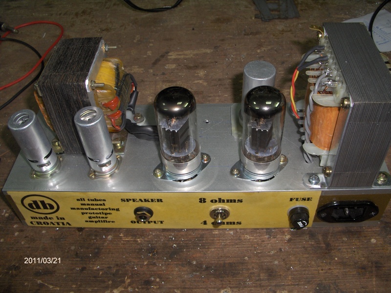

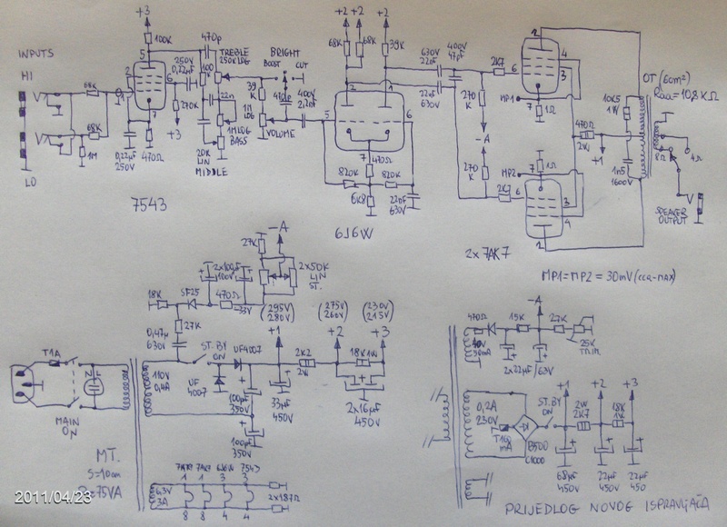

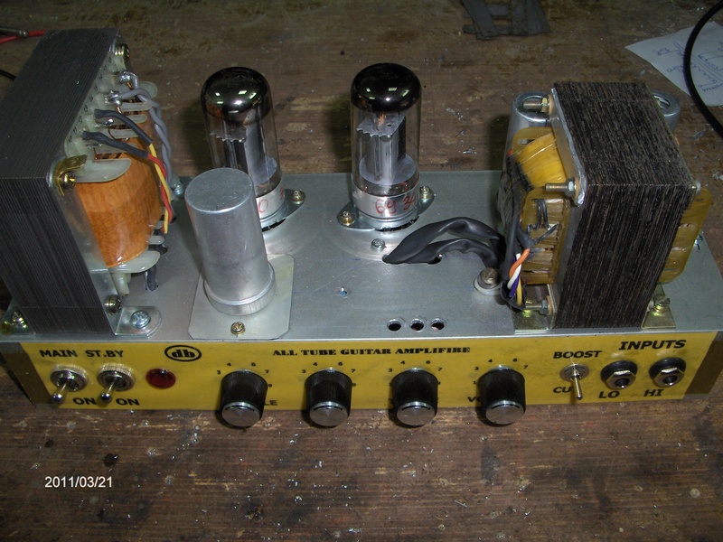

Here is first version (with 1 pair of 7AK7), and last version (wit 2 pairs of 7AK7).
I was rewired (for test) all versions in triode mode (G2 to Anode) with better sound, but only 40% of power. Also trayed "realy" triode mode (G2 and G3 to Anode), but did not hear difference.

Know this article ? http://www.audioxpress.com/magsdirx/ax/addenda/media/millet2903.pdf
Pete Millett use a small positive bias in the G3...
