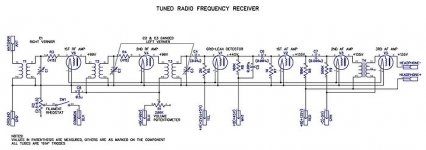

I get what you are saying, and this may either be off topic, or a case semantics. But a TRF radio is a specific kind of design that commands a place in the annals of radio development history. Virtually all front ends are "tuned" to some degree or other. I submit that the specific term TRF radio is reserved to a non superhet radio. I hope the schematic is readable. I depicts a design that is a TRF radio, and not a superhet.
That, indeed, is a 100% TRF design. An AA5 SUPERHET AM receiver has as its 1st stage a combined local oscillator/mixer. Pick any respectable FM tuner, say a McIntosh MR71, and you will find SUPERHET circuitry, with a TRF stage in front of the mixer. The tuning cap. has 3 sections, while an AA5 has a 2 section part.

TRF is a type of receiver, not a stage in a receiver. That is certainly the usage in UK, and everywhere else as far as I know. I have never before heard anyone use TRF to describe the input stage of a superhet. It is true that some superhets start with a tuned radio frequency amplifier, but this is always abbreviated to 'RF amp', not 'TRF amp'. Tuned RF amps are so common that 'RF amp' is taken to mean tuned RF amp; an untuned one is called 'untuned RF amp' or 'aperiodic RF amp'.
