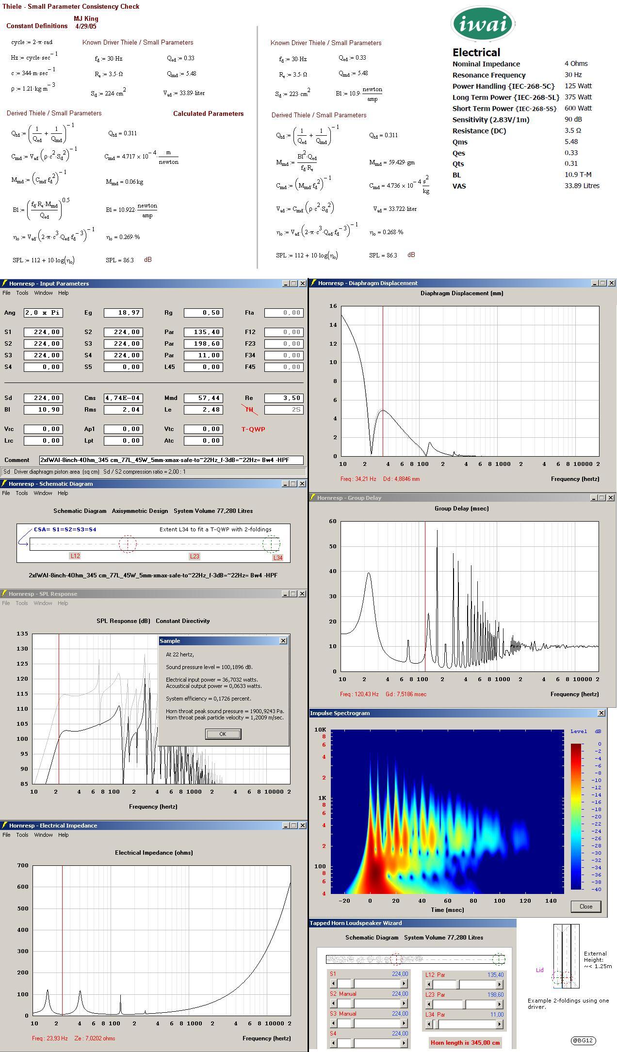

Anyway, to get things started: Hornresp is a free design software that you might find helpfull:
Hornresp
After downloading and installing, please, read through the help file, it is quite informative.

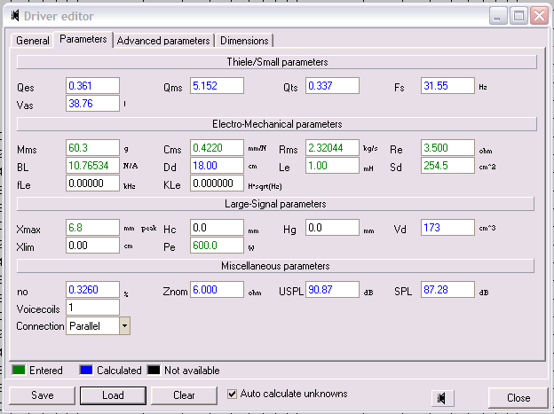

The speaker you are referencing does not look like much of a subwoofer, and I would recommend you measure the T/S parameters yourself (in addition to what you have in the specification sheet) before you spend a lot of time on designing, or cutting wood:
Measuring Loudspeaker Driver Parameters

FWIW, some measured specs:
GM

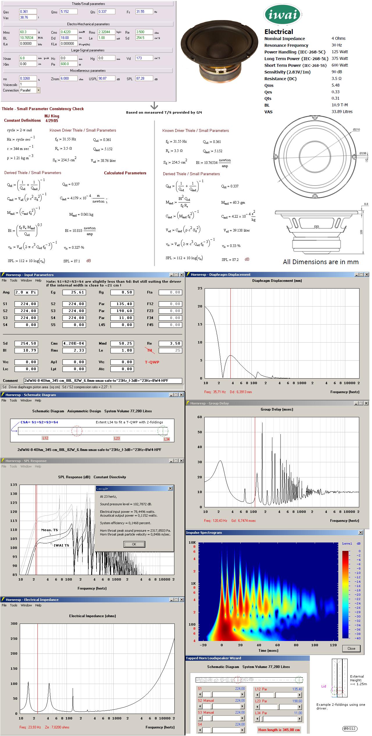

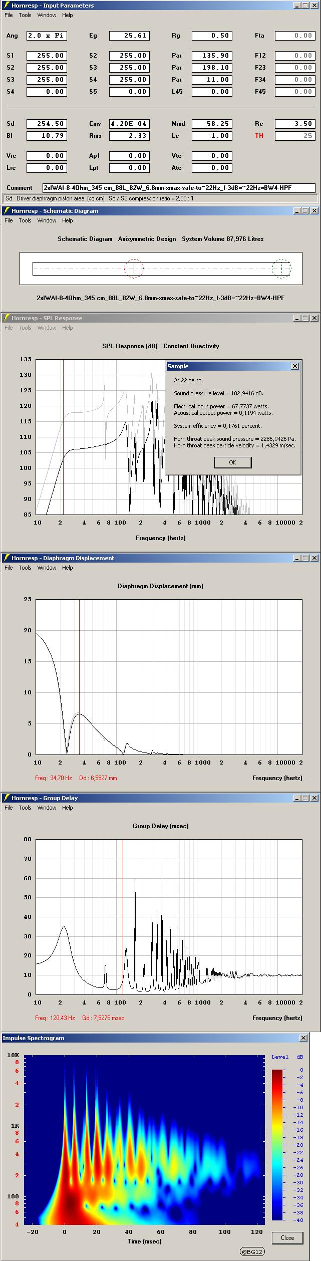

Hi GM,
Good news!
I plugged your numbers into my previously submitted simulation and found the measured T/S to be slightly improving the suggestion despite the new driver Sd is larger than the advertised..
The driver would still fit the enclosure with CSA= 224cm^2 as long as the internal width is close to 21 cm.
