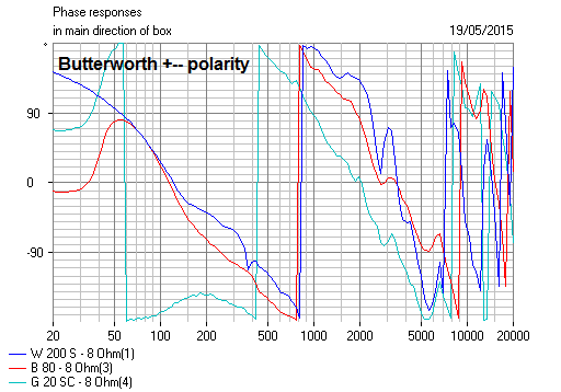

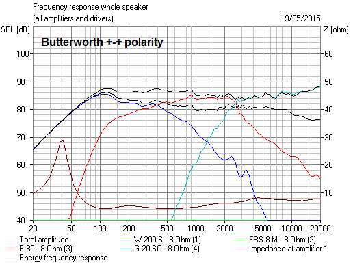

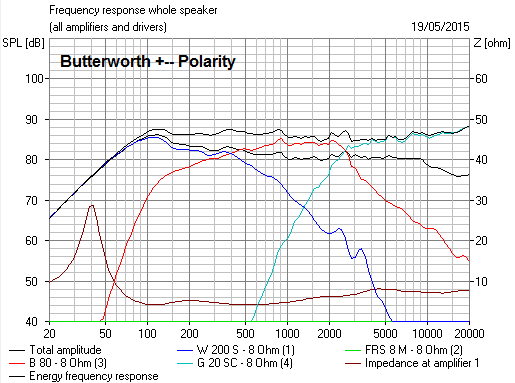

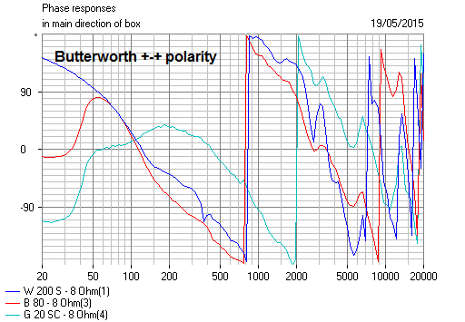

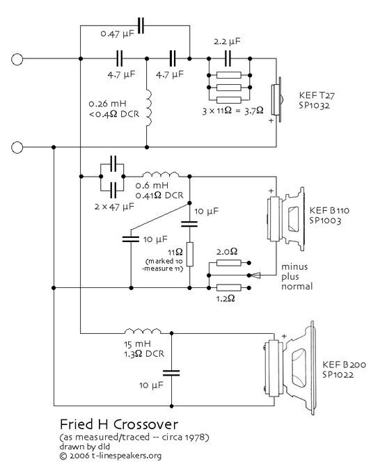

I thought it might be interesting to look at Butterworth filters in general, since evidently no-one here really has a clue how they work! 😀
I set up a shallow Bud Fried-type series filter with some resemblance to his designs with KEF drivers on transmission lines. I then converted it to third order 18dB/octave BW3.
I suppose you could use Bud Fried's lovely original shallow series crossover, which has good impulse response and fine phase alignment and flat impedance, or my slightly deeper slope Butterworth third order. Matter of taste really. Higher slopes mean less distortion with complex program material.
Here's the mark of a good odd order Butterworth. Flip the tweeter polarity and it makes hardly a scrap of difference to anything you measure. In fact my definition of Butterworth is odd-order. Different from 12dB/octave LR2 and 24db/octave LR4. There is actually no +3dB hump because of the 90 degree phase relation.
FWIW, the Fried Model H is clearly a Butterworth top end. Bit of that KEF 0.47uF acoustic butterworth too. Credit to planet10 aka Dave @t-linespeakers.org. for the Fried image.

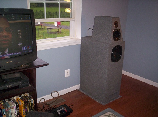

Would I be correct in suggesting that combining capacitors in parallel gives a total capacitance of their sum - i.e. 50uF + 50uF + 40uF = 140uF?
This would give me an approximate cost from Falcon Acoustics of about £40 for the 12 Alcap 2% tolerance 50 Volt Capacitors to achieve 140 uF and the four 2% tolerance Ferrite Core Inductors at 18 mH. Would one actually need exactly 140 uF Capacitors or would single 150 uF components suffice - and save £10 and some soldering?
I calculate that these components would allow the construction of a pair of 2nd Order Butterworth filters rolling off by 12dB per octave at 100 Hz.
Sadly S7 is using the wrong drivers to illustrate his points.
(And its not like it doesn't matter, it very much does.)
I'll repeat again passive sub x/o's are a nightmare,
and are best avoided by the sensible. You should
ignore idiotic calculators and suggested values.
An active sub is the way to go.
rgds, sreten.

For the price of large-value inductors you can buy a decent plate-amp, and interaction between a passive cross-over and driver when you desire a low corner-frequency tends to make a pile of doodoo
I have done both, repeatedly, and yes, you may well be wrong ;^).I take your point about the potential benefit of the miniDSP route. However, I suspect that experimenting with / utilising one may not be significantly less challenging than assembling a passive crossover for drivers with known parameters? I haven't done either yet so I may well be wrong.
What takes hours of experimentation with hundreds of dollars worth of passive components (before one begins to solder) can be done in minutes with DSP based crossovers. In either case, measurement tools are needed to determine the acoustical output is what you want it to be.
Ditto above. I don't use mini DSP but my approach is similar. DSP crossovers allow for very rapid prototyping and verification by ear and measures. You can then proceed to other types of crossovers if you wish.
Fair enough, I'm convinced. I'll just buy a second-hand active sub-woofer off eBay and put the B200s on eBay.
Many thanks for all your suggestions.
Aw, that's a bit sad! I wonder if you made it more difficult than it is with this Bud Fried Coffin design?Fair enough, I'm convinced. I'll just buy a second-hand active sub-woofer off eBay and put the B200s on eBay.
I do have the series circuit for it, but am sworn to secrecy by speakerman19422! And it is extremely neat, but actually is more of an LR2 design than a butterworth. 😱

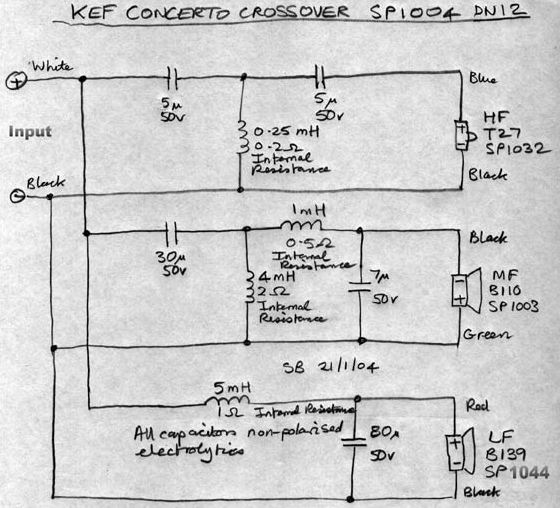

I don't see why you couldn't build a KEF Concerto with a a B200 rather than a B139. The B200 will presumably be less loud, so you'll need to take down the mid and treble levels. This is not hard. Bass cabinet to suit the B200 SP1022, which is known territory.
