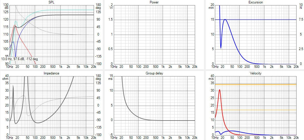

Make sure the inner exit area of the port is the same as the outer. It will probably be a good idea to put a 45 degree piece of wood ( or even better a scoop) in the corner behind the port to ease the transition. The port chuffing is likely at very high power 500-1000W or so. Your port should handle about 250W no problem, and there isn't much content at 24Hz in most music to excite the port.
Here is your slot port with Eminence design at ~1000W:

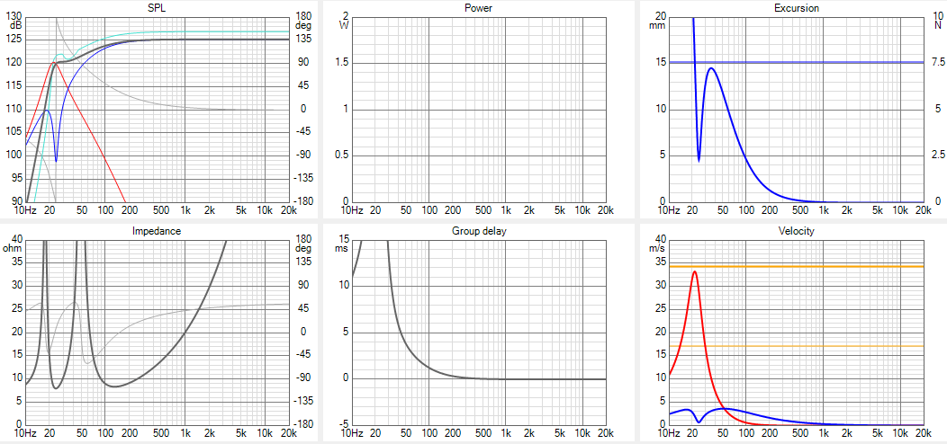

And below is your huge Eminence design tuned to ~17 with the same port at ~700 W (it handles less power due to larger enclosure and lower tuning)
The port velocity should be under 17m/s for best results, and yours is over 30m/s (red curve in lower right).

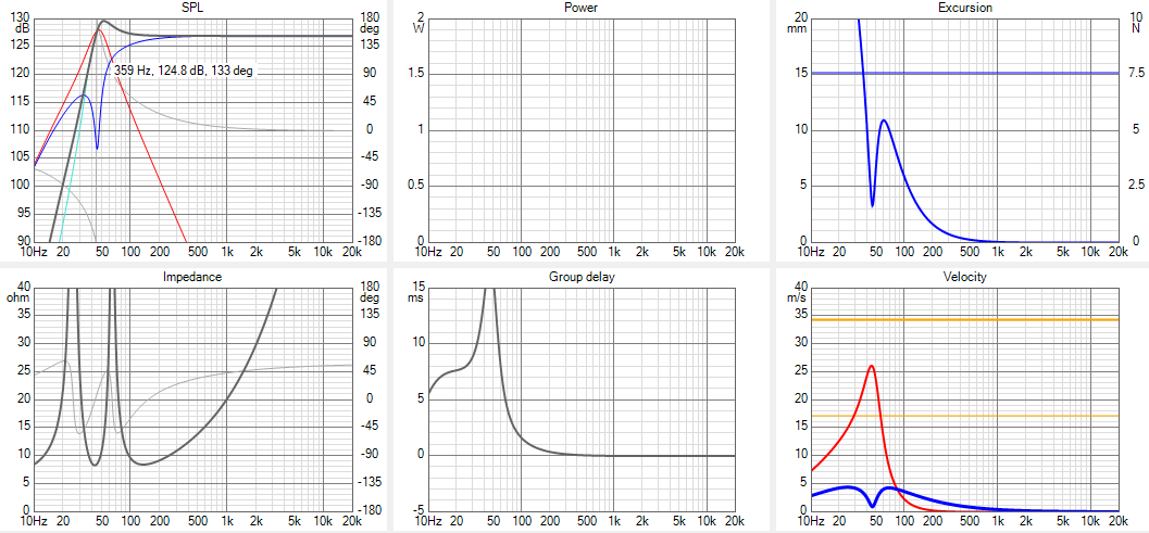

FWIW, here is the Eminence the way it could be used in a PA application 150L, tuned to 45 This is at 1600W in: It would have a sharp highpass below tuning (not shown).
