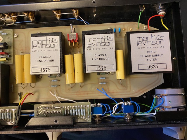

I've just received a pair of Mcintosh MC30 monoblocks to match the JC-2 and I'm having trouble finding out which of the 2 switch positions should I choose for the mac, I'm quite ignorant on this matter.
According to ML "When switched to the right (factory set position) the line outputs are AC coupled for driving direct coupled power amplifiers. When switched to the left, the line outputs are direct coupled for friving AC coupled amplifiers." and MC30 has Unity-Coupled M-150B transformers.
Does anyone here know which position should the swith be?

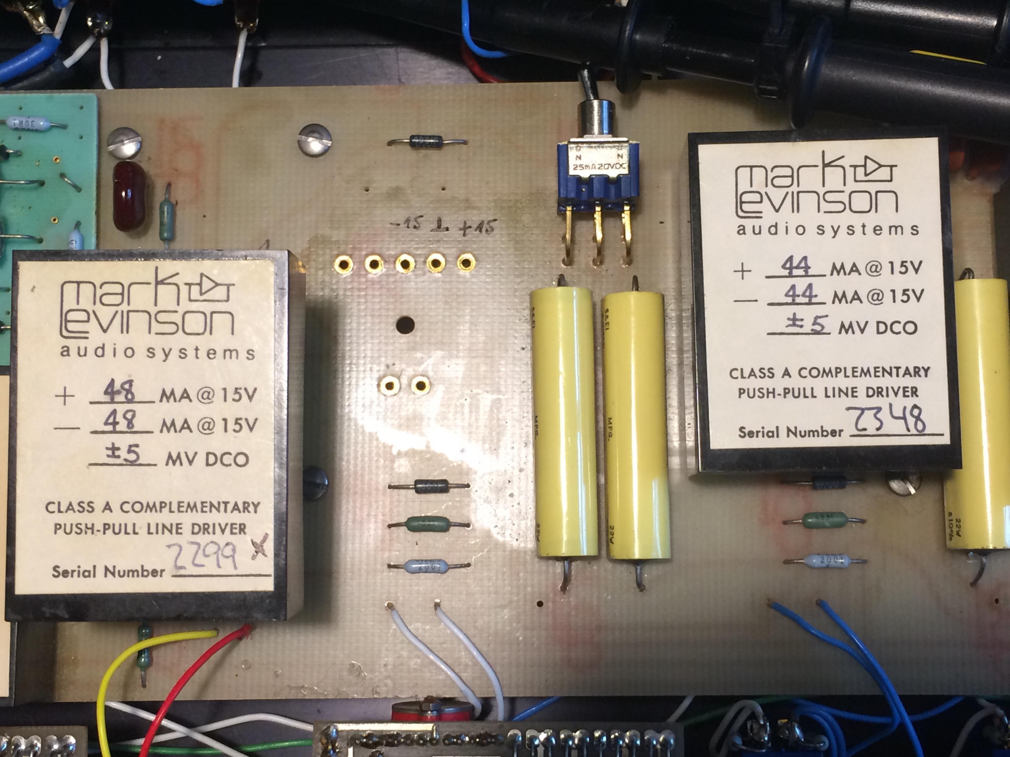

I have just acquired a first-generation ML JC-2, with a defective line output amplifier module.
Otherwise in good condition.
Could someone be so kind and point me toward directions where to find replacement modules? Or upgraded modules of some sort?
Is there someone out there who does good clones or upgrades?
That would be amazing, as I would love to make this unit play again. Thanks so much.
Attached a photo & link to the faulty module in question.

Hi! I have found these from Japan. I haven´t try them myself but I did see some JC-2 with this modules installed on Hifido. Once I wrote them and they answered fast, maybe it is worth a try, they have Line and Phono modules.
Good luck!

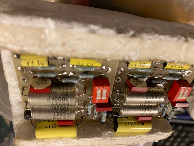

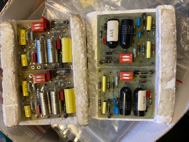

Attached are four pictures from the inside of my ML-1. As seen the installed modules are labelled "A". My other modules are labelled "A4E" and "D5".
I have always believed the block between the two phono sections has been the +/-13V regulator for the phono modules. Now I understand this is the JC-1-SM. This has escaped me all these yars.

RK that’s right, it is the MC step up transformer and from the pictures you uploaded I can tell my modules are the D5, which means that I can get 60db. I still consider the possibility of adding a step up just to see how much natural the sound can get

Maybe this information exist elsewhere, but it would have been nice if we could sort out all the different equalization boards (A, B, D and so on, has e.g. E ever existed?) and list them up, like this list I found at the Audio Magazine test report.
Pin-out would be nice also.

Ah. I can check that with the pin-out. I mean what pins on these modules are in, out, ground and so on. But I can check my own modules and post it later on.
