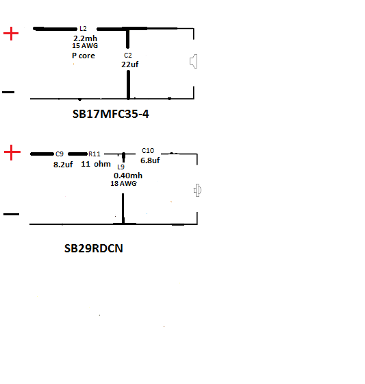

Hey guys i appreciate all your input. this is my latest design its a 2nd Order Linkwitz-Riley @ 2250 hertz with a zobel network.

A few comments:
- That looks like a classical textbook online calculator values which will most definitely produce a disappointing result
- woofer inductor is usually increased to take into account baffle step loss ( worth reading about it first ) which depends on your front baffle size and placement of the final loudspeaker.
- Zobel on tweeter is not needed, instead, depending on its impedance behaviour at Fs, you may want to dampen the peak. If it is not that pronounced, a parallel resistor or the use of an L-pad ( read about voltage divider networks ) would do the job in most cases, if it is sharp - a dedicated LCR trap is required.
- Having both 2nd order electrical on the two units AND if they are placed on a flat baffle would yield poor phase tracking. At tweeter level, which is the usual listening position for top mounted tweeter loudspeakers, a 3rd order electrical would allow easier phase integration ( still aiming for 2nd order acoustic response, read about the difference between electrical and acoustical slopes ).
- Tweeter has no resistor, which is usually added for equalisation. As you`d need to interchange it until you like its level, better put it between the amplifier and the crossover.
Best is to use a project that has been built by someone and has been reported to sound good. Lots of those are available. Lack of measurement equipment does not necessarily mean you`d end up below your expectations but it saves lots of time.

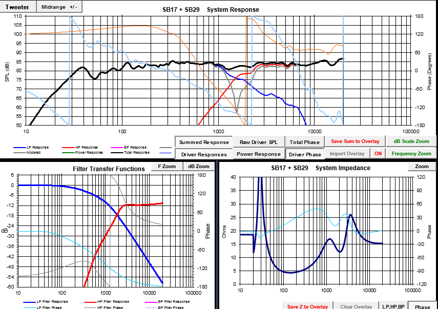

hold up....
Had the non neo tweeter in there a second ago, luckily the neo only needed a slightly different resistor value. Box would just be typical monitor size around 9" W x 16" H baffle with drivers centered and tightly spaced.

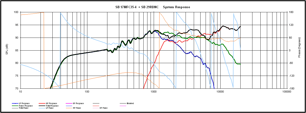

Jay111 said:hold up....
- midrange rise of woofer (+5dB from reference level ?)
- 8dB per octave rolloff in lowpass, much too less: Level of "dirty upper end" of woofer far too high in the cutoff region
- tweeter electrically (due to back EMF) underdamped
- lots of ripple in the transition region of the highpass
- impedance curve may be titled "how to summon a dragon[1]"
- acoustical XO frequency to low - target was 2 ...2,3 Khz - mechanical stress and THD for tweeter unecessarily high
Still not sure whether i am finished yet ... what i see is a 6-fold misconstruction.
Who do you think shall be listening to that speaker enjoyfully guys ?
(Deaf grandma/grandpa anyone ?)
Not me, that's for shure. And not even the "average" german listener will, who's bad taste in overpronounced presence and highs has been legendary anyhow. May be you can sell that kind of "sounding" somewhere in japan (no offence meant).
Surely no chance in the US.
But keep on simulating ... and using "as few parts as possible" 😉

I think you're confused 🙄
Bass response wasnt modeled that's manufacturers IB response. Check the woofer transfer function and spl level of woofer on the manufacturers chart to see actual BSC applied.
It's a poly cone woofer with 20 db attenuation of the "breakup". There's no ringing here, and nothing in the HD plot related
I dont stress over a couple db dip, it's a balancing act and that is one i'm willing to make.
Really you are going to criticize the impedance curve of a 4 ohm 6" woofer paired with a 95 db tweeter? Have you never look at a loudspeaker system impedance curve before?
I dont care what the OPs target crossover is, he isnt capable of designing the crossover. You obviously have no idea what the SB29 is capable of, maybe you should look into it before further implanting your foot inside your angus.
Please present us with the proper crossover for this speaker since you are such an authority on proper design. You apparently have no clue what the purpose of simulating a crossover for someone spending money on drivers with no idea what they are doing is, or why trying to simplify crossover design for a simulation makes sense. ITS NOT THE FINAL CROSSOVER. Maybe the OP will eventually get his drivers measured in box, or maybe he will be happy with what he has. Who knows, but why try to flat line a perfect response when the basis for the design is flawed.
Oh master of speaker design and golden eared authority please impart your glamorous wisdom upon us

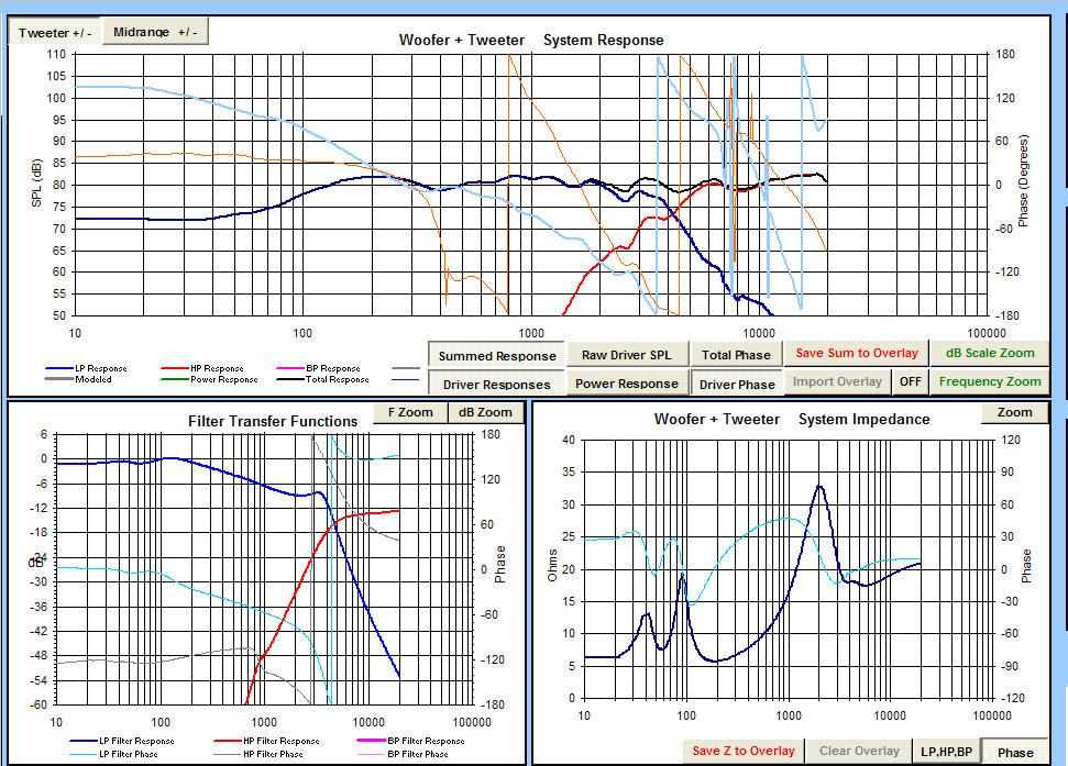

Hey Mauds, just to give you an idea of how bad on-line xo calculators can be (if that's what you used) below is what the response looks like using the xo you posted last. Box was 9" x 15" with a 3/4" roundover on the edges. Tweeter off-centered by 3/4" at 12.25" from the bottom and woofer centered at 7".
Black is your summed response. Not a pretty sight.....

Jay1111 said:Really you are going to criticize the impedance curve of a 4 ohm 6" woofer paired with a 95 db tweeter? Have you never look at a loudspeaker system impedance curve before?
Quite often i did such "unequal" pairs in sensitivity, especially in 2-ways.
No reason for designing an impedance curve like the Rocky Mountains at all, and also no reason to have an underdamped tweeter, seeing the amplifier just through an electrical "straw" without any compensation for missing Back EMF.
But if your design skills/experience do not allow you to do any better just carry on. Do whatever you like, i am pulling myself out of this.

hold up....
