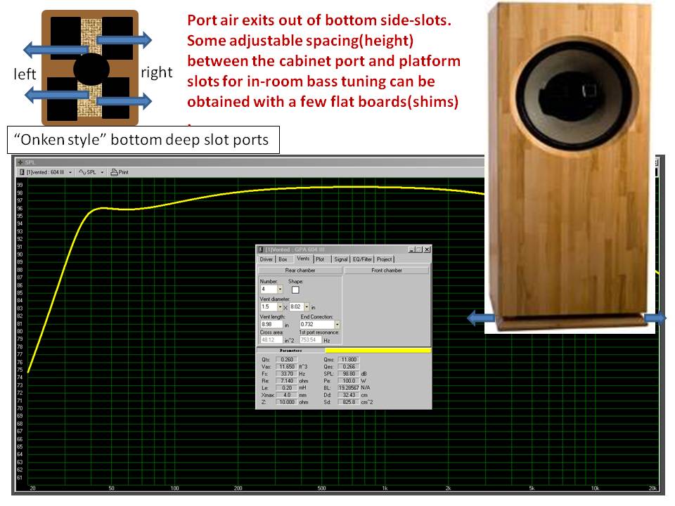

There are a few early-tech MLTL cabinets for the Altec 604-8H which put the port on the bottom of the cabinet and use (adjustable height) legs for final in-room bass tuning, and also to raise the tweeter horn closer to optimum ear level. One design goal is to avoid a direct path from the port to the listener's ears, especially for the wide bandwidth generated by the Altec 604-8H cone. Naturally, heavy carpet will change the bass tone compared to a tile floor, and legs with height tuning might be necessary. The legs must be high enough (1.5x - 2x port diameter) to avoid port air compression.
If I had a 48" max-height cabinet, I would put the port on the bottom and add adjustable legs ... a proven short-box design. The Jay Fisher build with adjustable bottom legs gets positive reviews.
OR...MAYBE
Want to do more unique engineering? Post #17 shows Jean Hiraga displaying his Altec 604 MLTL speaker. Port air exits out of bottom side-slots. You could build a similar bottom platform to disperse the bottom port output on 3-sides. YOU STILL WANT some adjustable spacing(height) between the cabinet port and platform slots ... a few flat boards(shims) will give you in-room bass tuning.

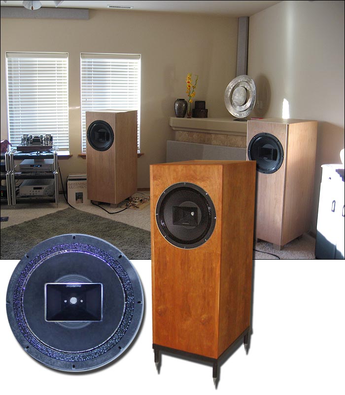

Attached Shindo example of a wide(maybe 32") bottom ported cabinet on legs for the Altec 604-8H. MIGHTY FINE wood work. I would flush mount the Altec.
Attached Jay Fisher example of a narrow(maybe 18.75") bottom ported cabinet on height adjustable legs. Popular design thanks to web articles.
Neither of these boxes look like "ideal" dimensions for optimized MLTL performance designs. Both of these speakers look like they were size-designed for specific room requirements. Suspect both sound pretty good. Hope these pics help you decide upon wide vs. narrow front baffle. If you post your final design dimensions and MJK spreadsheet printout, I suspect you will get a few experts willing to double check and recommend bracing + stuffing before you route holes.

I have read the review of the 6moons MLTL designed by Jay Fisher, GM very successful project
Greets!
FWIW, I didn't have anything to do with the 6 Moons cab/article and only found out about it many 'moons' after it was published. Ditto the Dennis Fraker version Jay contributed to. I wasn't a 'happy camper' to see bits of some of my PMs to him published without my knowledge or even edited to bare technical essentials.
I did help Jay with a number of builds including some Altecs of which one pair was built and they look nothing like these other two. It's wide, flat [driver depth IIRC] and short enough to just barely be called a MLTL and with a visibly lower driver location. Its custom legs are delicate looking works of art, but don't recall if he made them or farmed them out.
By all accounts its performance up against a wall is 'smooth, full as a baby's bottom' with no BSC or other filters other than a stock XO and coupled to a high output impedance tube amp. The 6 Moon's motor brace is from the stillborn 604 ML-horn design IIRC. Unfortunately all my info, pictures are locked up in a pair of damaged HDs.

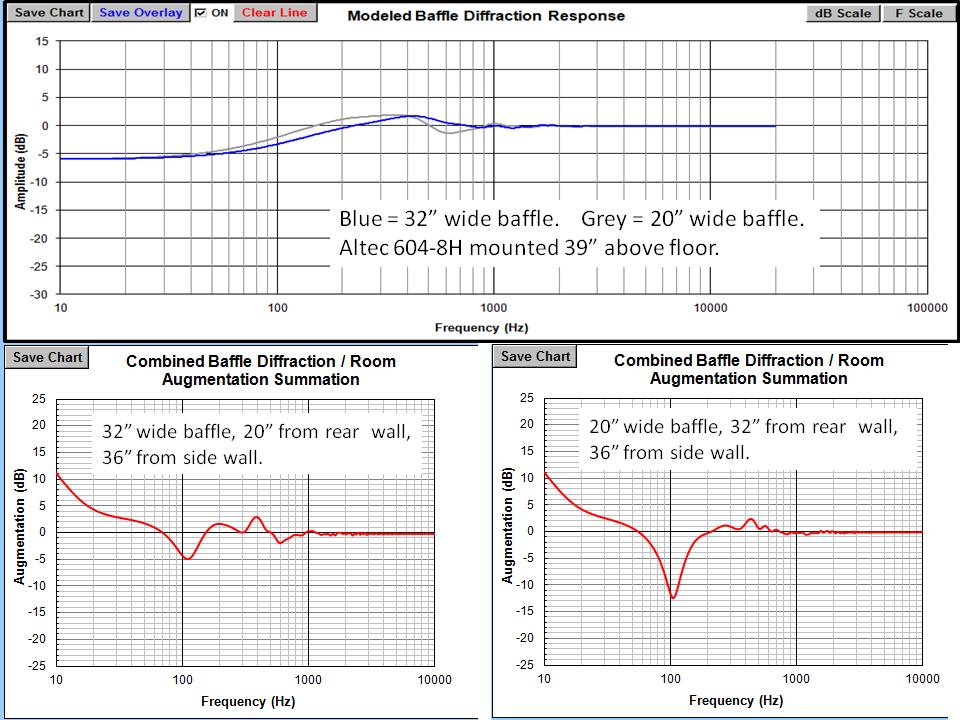

GM--The photo came from the 6Moons website article. Internal cabinet dimensions discussed: 23.125"W x 18.4775"D x 42.5"H
--I ran a crude baffle+room sim of a 32" wide vs. 20" wide front baffle. As expected, this CRUDE simulation shows that some(more?) baffle step compensation is desirable for a 20" wide baffle than for a 32" wide baffle. As expected, the narrower 20" baffle sims are slightly smoother over the midrange frequencies.
Anthony--What cabinet shape would best fit your room, furniture style, and also pass "family review"?
Anthony--"why you think they are not "ideal" dimensions for optimized MLTL performance designs. What do you consider ideal MLTL dimensions for this driver?"
If you did not already have 48" cut plywood, a taller cabinet with ~58" internal line height sims best for low bass + modest resonances. A longer line allows me to glue/nail only Owens 705 fiber board on the walls around the speaker, and still have room for enough fiber-fill in the bottom T-line. To my ears, this construction sounds best with wide bandwidth full range and coaxial drivers.
Greets!
Ah! Thanks! That's what I get for not doing more than confirming this was the one with the special motor brace and for some reason remembering the speaker being front vented.
Nice to know a reflection sim reflects reality. ;) Which program? Basta?
